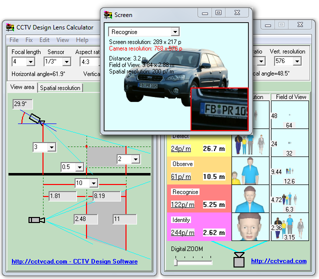

  2. Stanislav New Member
    See also freeware CCTV Design Lens Calculator . In addition to usual Lens Calculator features this calculator offers several new unique tools:
    Calculating camera field of view in 3D, taking into account camera height and tilt angle.
    Calculating spatial resolution (pixel density) at any distances or calculating distances of specified spatial resolutions,
    Simulating images from cameras using prepared photos or pictures.
    Simulating field of view and resolution of megapixel cameras up to hundreds of megapixels using Picture-in-Picture technology.
    This free Lens Calculator is based on professional CCTV Design software - VideoCAD.
