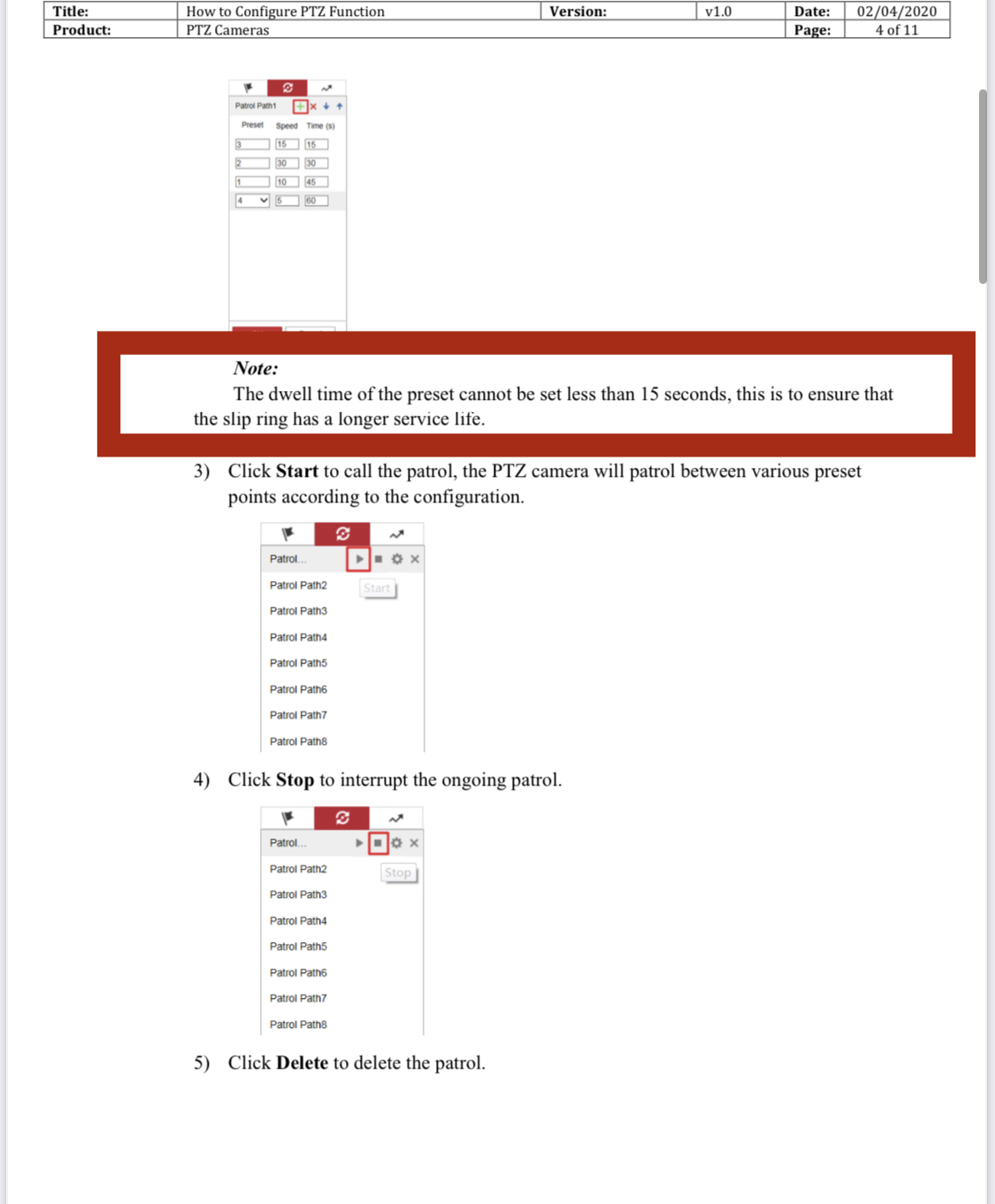

On this manual its say:
-Between presets the minimal waiting time is 15 seconds.
-In the end of a smart tracking scene, the cam return to a preset…to start again the smart tracking there is also a minimal 5 seconds waiting time.
