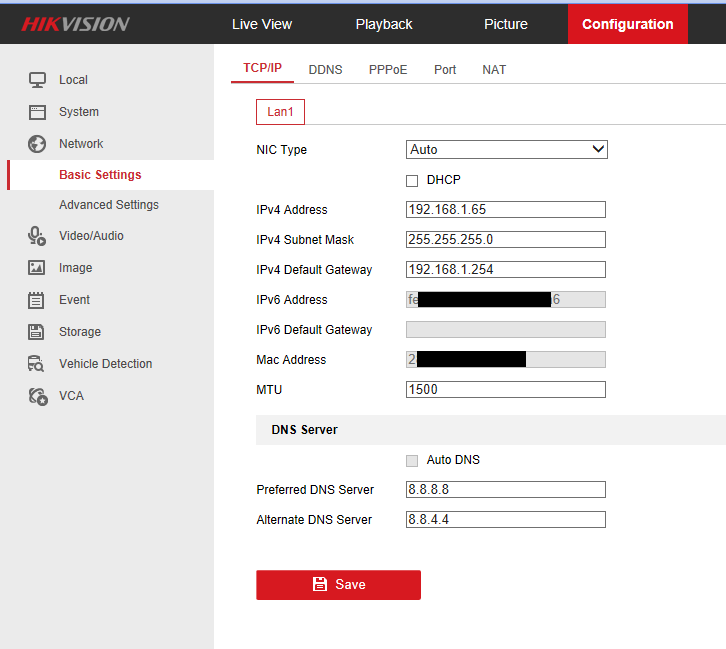

Have you entered all of the required network settings please?
Esp. Gateway and DNS
Yes network settings all OK. I think I may have found the problem.
