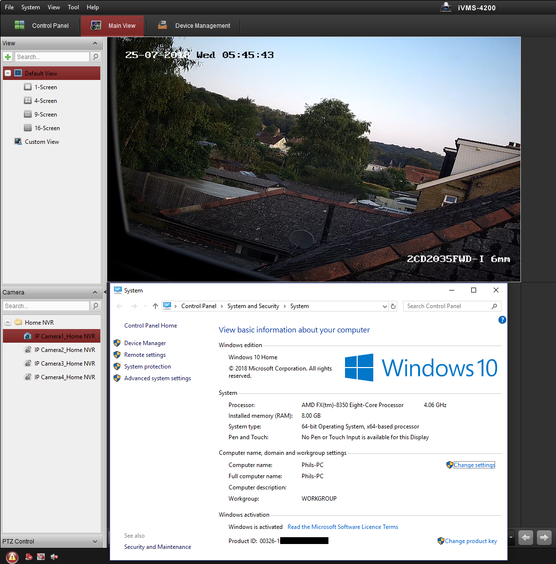

I'm not sure what the root cause of your issues is.
iVMS-4200 Client runs fine on my Windows 10 64-bit desktop.
