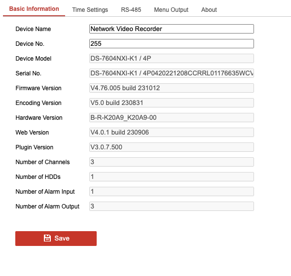

Hoping I am posting this in the right section. Last year I had a DS-7604NXI-K1 / 4P NVR installed along with 3 Hikvision cameras. I had a disagreement with the installer earlier this year, and have since been trying to work out how to maintain and update the NVR and camera
I tried to download and upgrade the firmware for my NVR but got an error saying failed to get the upgrading progress
I have attached a screenshot, showing my current firmware version
If anyone could send me a direct link to the version I should update too, I read that you can jump ahead of too many firmware updates, so I wasn't sure if that is why I got the error
I find looking through the hikvision firmware pages, very confusing and not very clear for someone who hasn't done it before
Any help would be greatly appreciated

Hi @seobuilder
The latest firmware for the DS-7604NXI-K1/4P is V4.82.007_240321
Hi @Dan
thanks for the quick response
I downloaded that firmware using the link you sent, extracted the .dav file to my desktop, went into configuration then maintenance using Microsoft edge browser, clicked the file and then upgrade, but it shows 0 per cent progress then just comes up failed to get the upgrade status with red circle with white x in it
I wasn't sure if it was because my firmware was many versions behind or not
Okay,
You are not that many versions behind so I wouldn't expect that to be a problem, but try this version that falls between your current and the latest firmware and see if that works - V4.76.015
If it does work, try updating to the V4.82 firmware again.

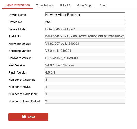

Hi @Dan
Thanks again for the quick response, I appreciate it
So neither of them was working, and didn't show any progress, so I rebooted the NVR, then tried to install both files, the new one, and then the older one, both of them got to 75% then closed down and a red circle again with upgrade failed message
but what confused me even more, see attached, when went back into check firmware now showing this

Hi @seobuilder
Okay, that is strange but at least it does look like the firmware has updated (possibly the reboot was required for the firmware to update).
