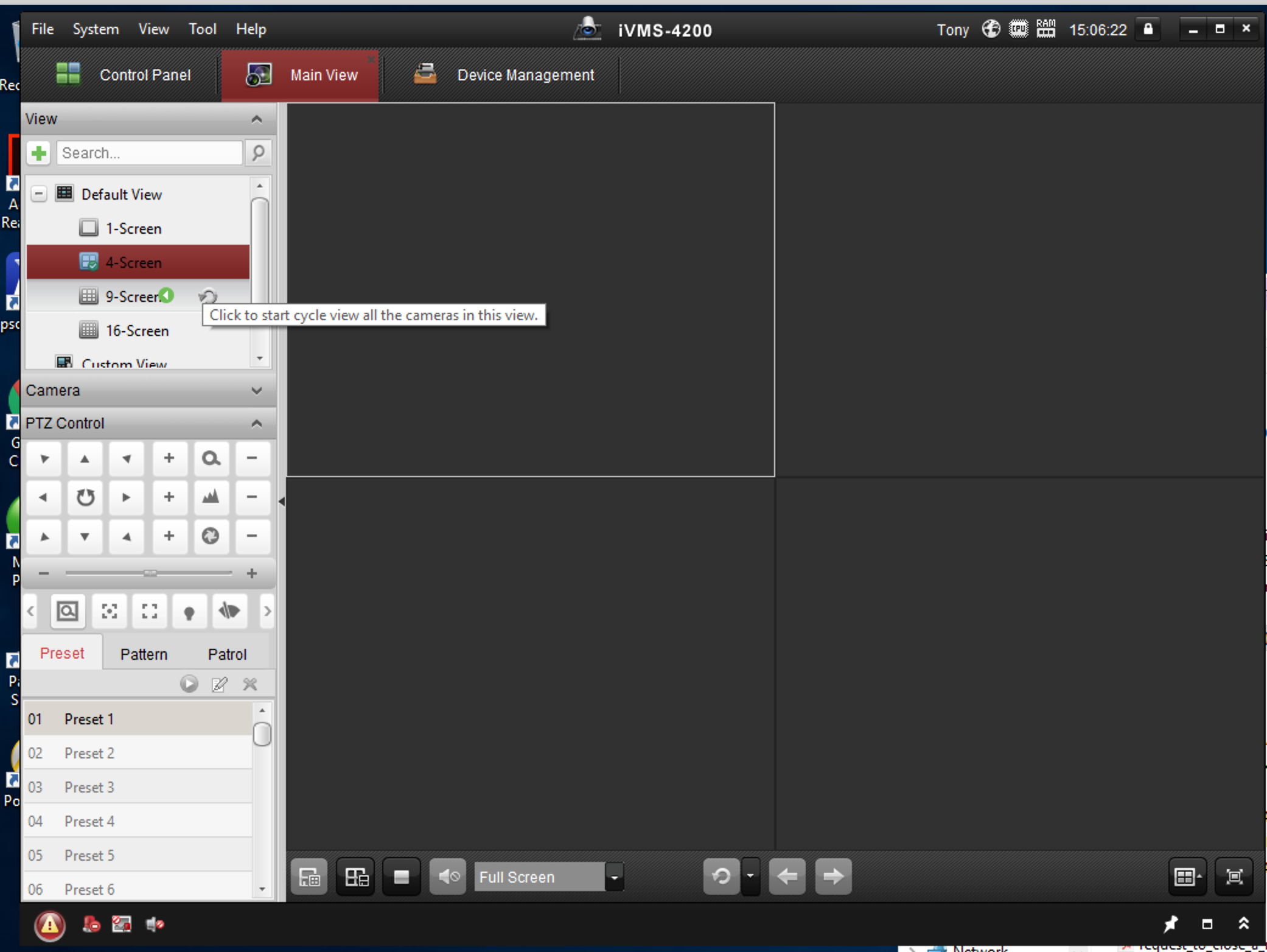

I have set up IVMS-4200 on a Mac and it works, and can connect to 3 different devices (hybrid DVRs). However, when I setup IVMS-4200 on Win10 it lets me add all the devices but when I go to Main View it doesn't give me a list of the 3 devices to select from. I just see the display as per the attached file and I can't see any devices at all

I have done a bit more experimenting and if I create a group then I get some degree of success (some of the devices work but not all). Is it true that it can only be used if one creates groups. I didn't need to do that on the Mac version.
