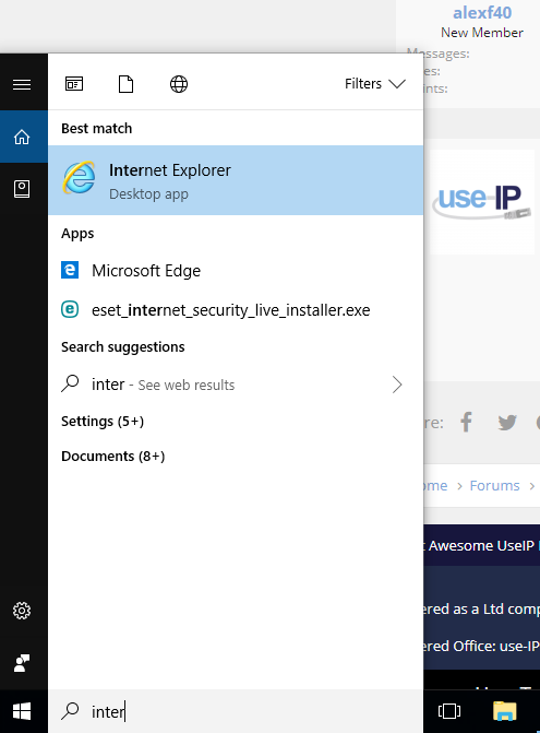

Internet Explorer is still there in Windows 10, it's just that Microsoft hide it.
If you begin typing Internet in the 'Type here to search' box at the bottom-left it should appear as an option in the Start panel list:
(you can then click to open and run it)
Well I never knew that, thanks. Unfortunately I still get the same error with IE. I've tried setting my PC with a static IP address in case the IP was blocked but still get the same issue.
