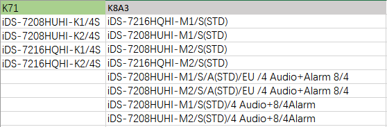

You used the gen 2 firmware when your recorder is gen 1 and you've likely bricked it unless it can be revived. Probably best to return back to your supplier explaining above. The correct firmware for gen 1 is here

Your DVR is the first gen acusense (K71) and the firmware I previously linked is the only one on the portal. Try V4.70.110_220328 which is found on the Hikvision website but nowhere to be found on the portal.
