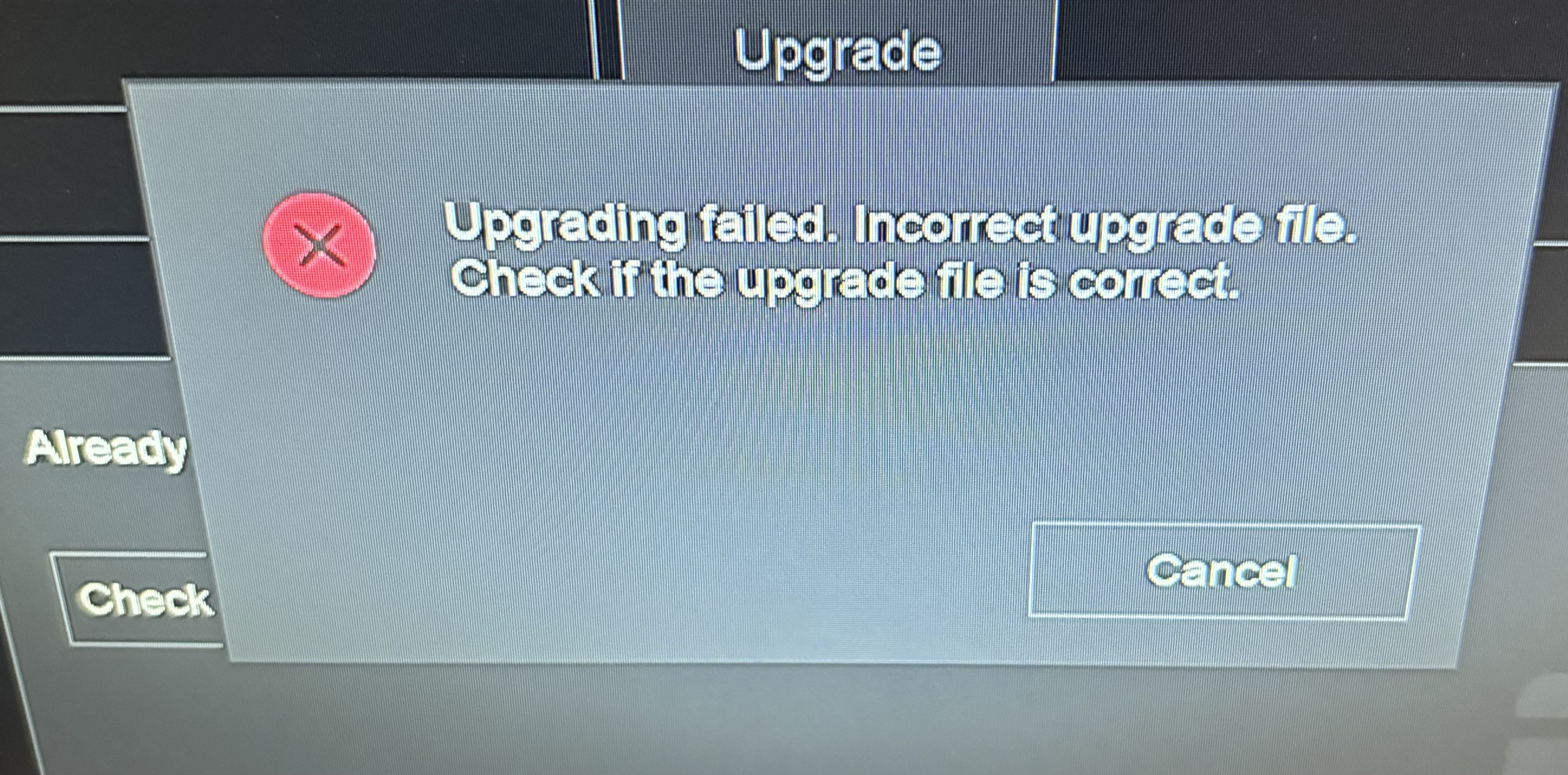

Hi JB1970
I downloaded the new NVR software and managed to get the internet end to work through the IE explorer mode workaround through edge which is working fine now.
On installing the software online it didn’t work so I installed it onto a flash drive and tried to install and got the following error. I have downloaded the software 3 times and I don’t know what I’m doing wrong.
I also can’t find the software download for the cameras on the hik vision website
Cheers
Andy

Hi JB1970
Cheers
Andy
I think maybe you didn't first decompress/unzip the downloaded file. When unzipped it will be called 'digicap.dav'
I noticed on the Hikvision site (UK) that your model isn't in the product pages anymore. Go to hikvision.com/en then click Support > Firmware. Type in 2347 in the search box and you'll see version 5.7.17_240731.
