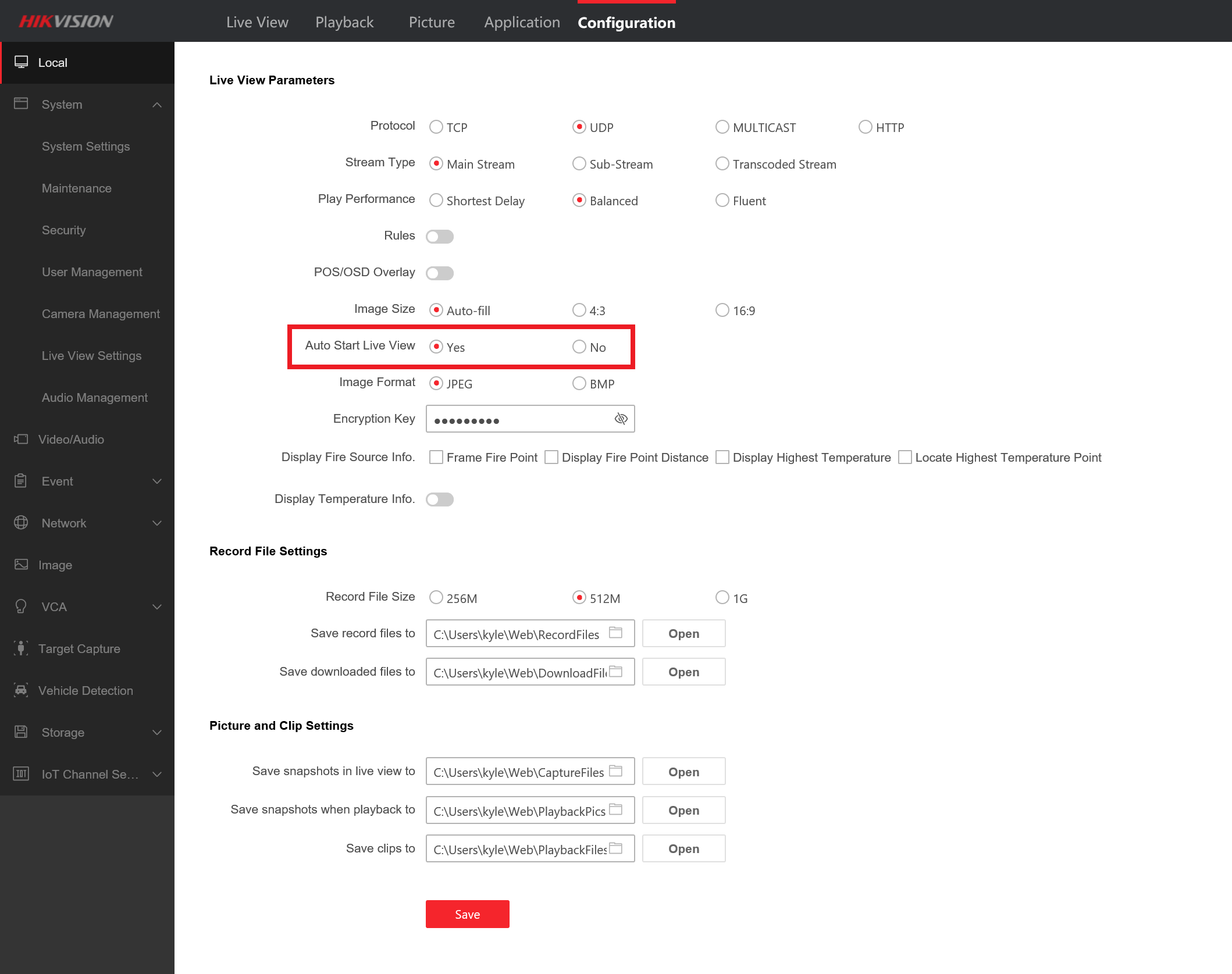

When you go to the NVR configuration menu can you see a local menu in the menu list on the left?
If you can, you should see an "auto start live view" option within that local menu
If you can't see the local menu, can you please go to the System menu and confirm the current firmware version of the NVR?
Just to add to Dan's comment...
You will need to use Edge on your PC to connect to your NVR, and then load the page in Internet Explorer mode to see the "Local" menu:

Thanks @julian toon
should i just upgrade to the latest firmware first
Hi @julian toon
If you can't see the local menu as @Kyle shows it above then yes you will need to update the NVR firmware, can you please go to the system menu and confirm the firmware version you are currently running? (if you are many versions behind we may need to recommend that you upgrade the firmware in steps)
