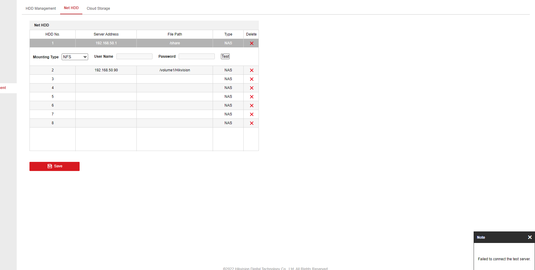

Trying to add to Hikvision camera a network HDD attached to my Asus router within the same network than the Hikvision camera. I follow the steps below but it keeps failing (Fail to connect to test server)
The HDD attached to the router is working and I have access to it from my network
  1. Enter the Net HDD settings interface.
  2. Click an HDD to configure.
  3. Enter the server address of the network disk, and enter the file path.
  4. Select the mounting type. NFS and SMB/CIFS are selectable. And you can set the user name and password to guarantee the security if SMB/CIFS is selected.
  5. Click Test to see if the HDD is properly configured.
  6. Click Save to save the settings.
Sorted, it only works using SMB mounting type which requires a user name and password, NTFS doesn't work which doesn't require user name and password
