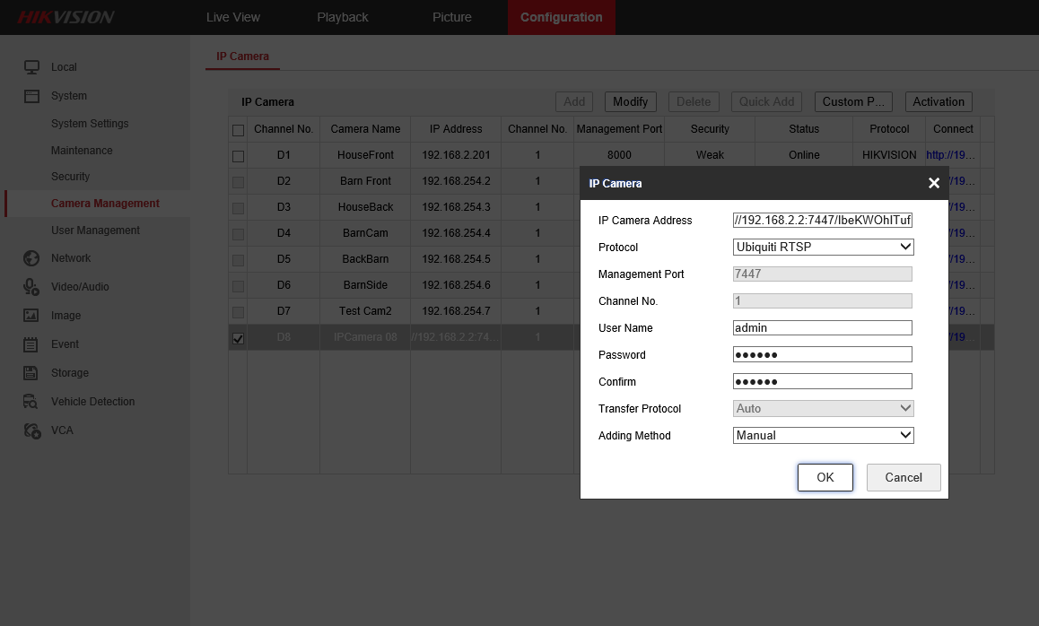

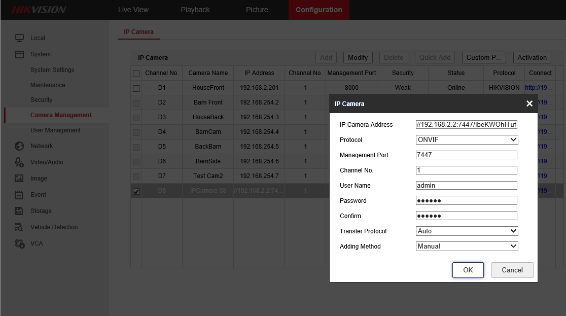

It works OK in Unifi Protect, but I'd like to connect it to my Hikvision NVR.

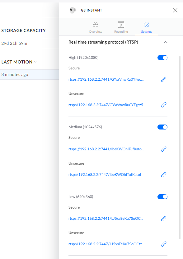

Within Protect the config menu gives you links to various RTSP streams:
The one I'm trying to use is: rtsp://192.168.2.2:7447/IbeKWOhITufKatol

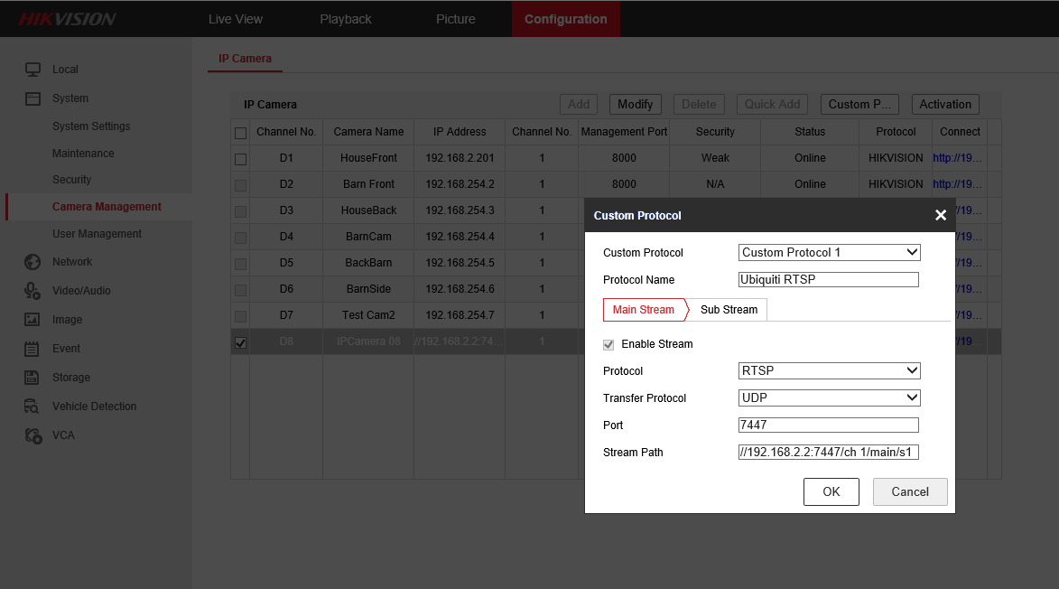

I've tried creating a Custom Protocol and adding it via the NVR cofig menu's, but haven't had any success.
Has anyone any experience/ideas on how to do this?
