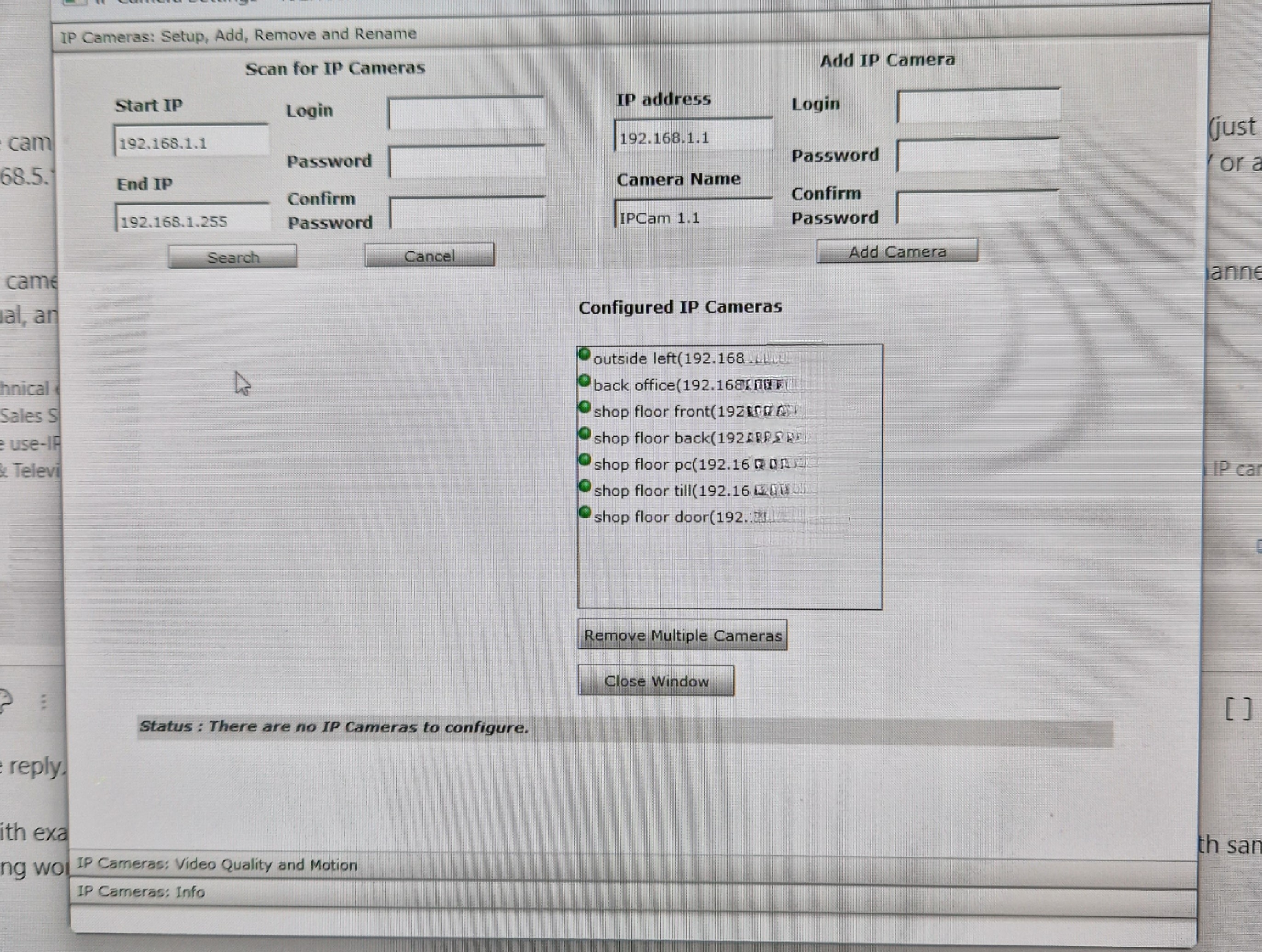

Hi Dan, thanks for the reply.
I have already tried with exactly the same IP address as the old one, with the camera original IP address (different range) and also with same range but different Ip and nothing works. The NVR can't detect the new camera.
I'm afraid I don't have the option to change the channel from Plug&Play to Manual I believe.

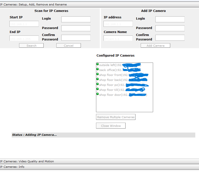

Well it looks like I somewhat managed ... lol
At least the NVR is connecting with the camera and allows to click on Add IP Camera, but despite that, the Status continuously says "Adding IP Camera"
What am I missing here?
What should I do?
