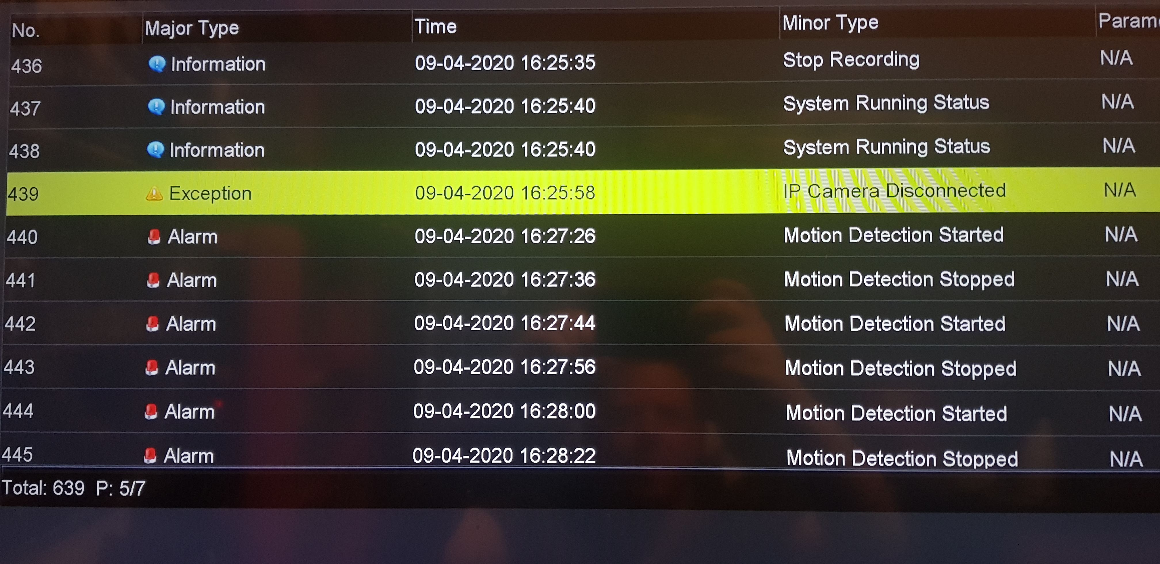

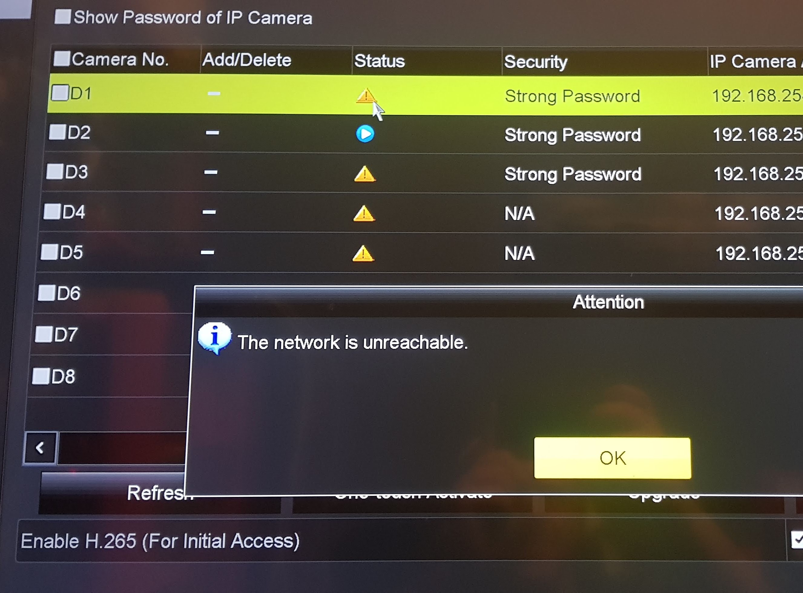

I noticed this camera had lost its feed. I went into my nvr to see what was going on and it stated "Network Unreachable" there wasnt anything i had done to it as im aware of anyway.

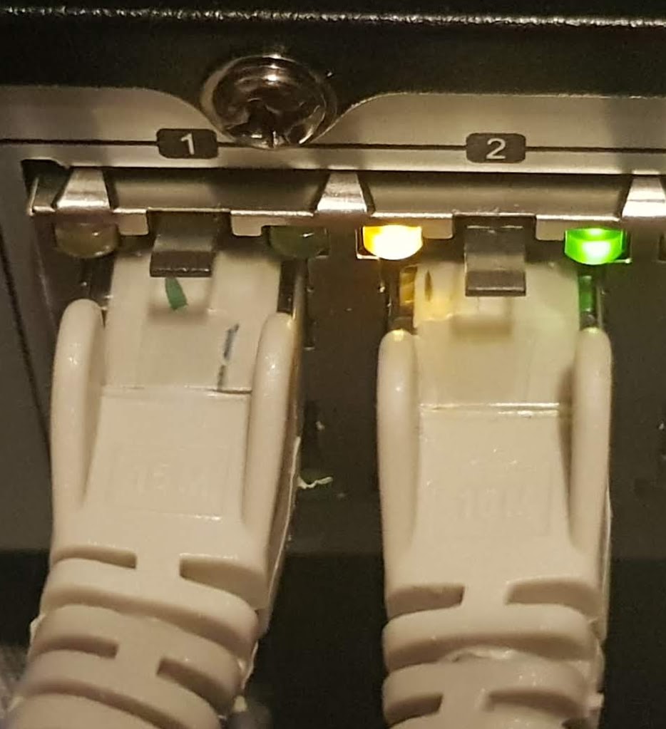

I check the nvr poe ports and camera 1 network lights are not flashing. I then try another port and still nothing. I Disconnect the cables incase i had a faulty one and tried another but still nothing. All the camera shows is the 3 red ir lights being lit. I have tried resetting the camera using the reset button but nothing happens.
