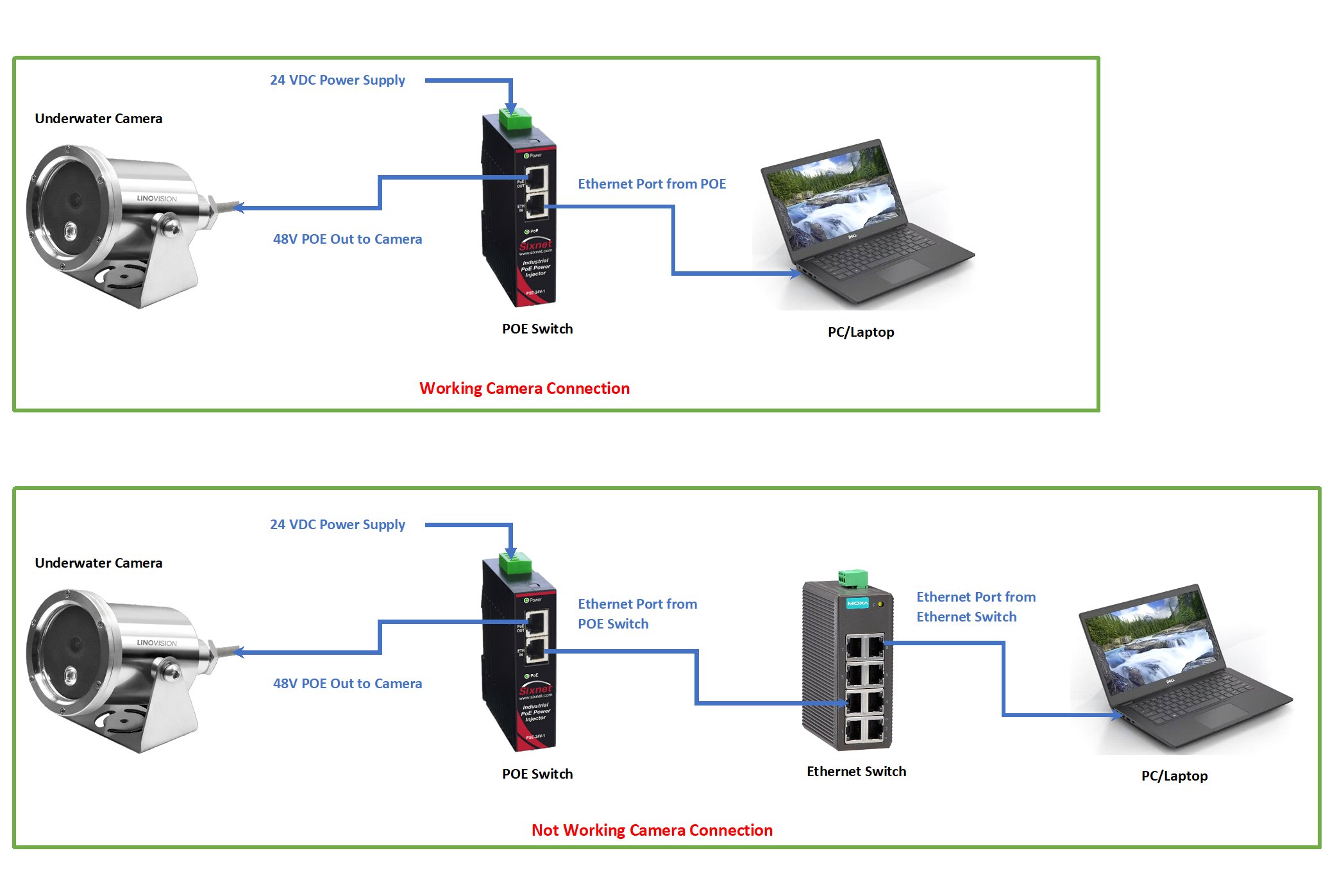

We are facing an issue with our Underwater Camera - (Linovision IPC608UW-10 with 75meter cable) with POE and Ethernet Switch.
Camera is powered by POE - (RedLion EB-PSE-24-1B, Single Pair 4wires) and camera was working well with this POE port and its Ethernet port only.
When we connect the POE's Ethernet port to an Ethernet Switch (Moxa - EDS 208 & Siemens Scalance XB005) for including this camera to a common network to monitoring the whole system. We cant able to ping the camera.
Could you please suggest/guide us to solve this issue.
Appreciate your suggestion/guidance in advance.
Thanks,
Kali Rajan M

Camera and Cable are ok. Because when we use the same setup with POE switch it was working.
While we connect the Ethernet switch to the POE's Ethernet Port then only it was not getting the Camera.
Please see the Attached image for more clarification of our issue.
So kindly suggest to solve this issue.
Thanks.

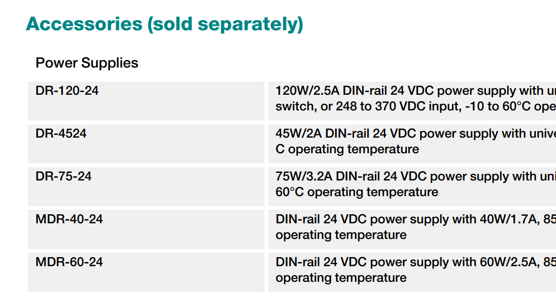

Are you using one of Moxa's recommended PSUs to power the switch?
It seems to be quite power-hungry

We have a separate power source from the Battery Banks, 24V...
The Moxa switch is working good... We checked internally.

I can't really suggest anything though. In the 2-switch configuration where the camera and laptop are the only devices on the network then...
Given both switches are unmanaged, if the camera is assigned a static IP address and the laptop is assigned a static IP address on the same subnet, then I can see no reason why the laptop could not ping/connect to the camera.
Some devices don't reply to ping, but if you can ping the camera in the 1-switch config then of course it should reply to ping in the 2-switch configuration.
In the 2-switch configuration without any other network: what do the activity lights show? Check the laptop ethernet port, the normal switch and the PoE switch activity lights - are they all flashing indicating network activity? Or is one or more port lights not lit or solid lit (indicating no network activity).
