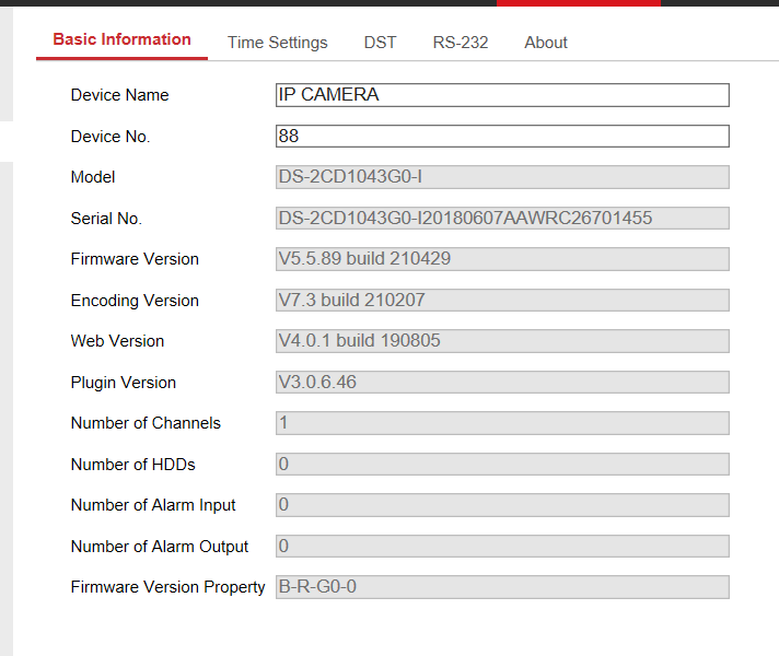

Can you log into one of the 5 problem cameras, go to Configuration > System > System Settings > Basic Information, and confirm what the 'Firmware Version Property' is for your cameras?
Can you please also confirm the firmware version that your NVR is currently using?
the camera :V5.5.89 build 210429
