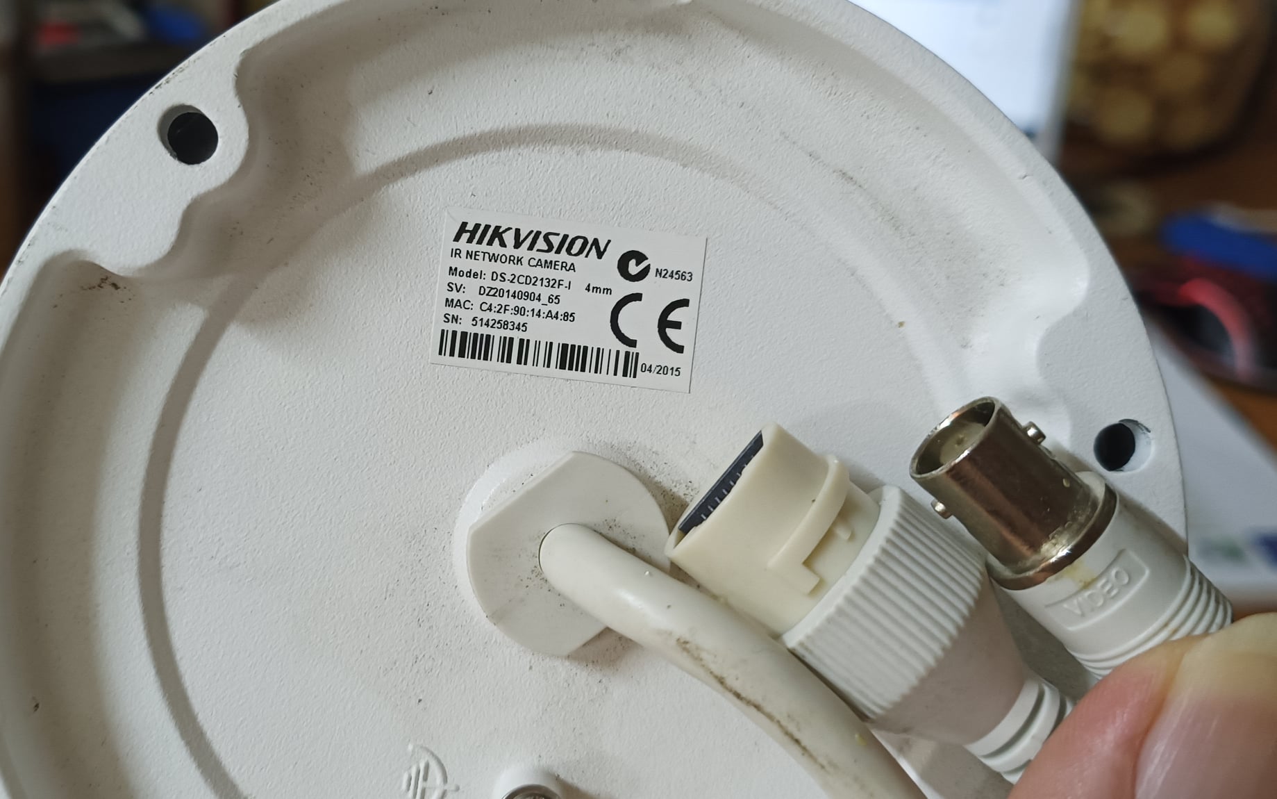

this camera contains BNC Port and POE Port, so is this allow to connect to NVR or DVR too??
I am curious how to connect this to DVR.... is it direct connect the POE to power adaptor and the BNC to DVR???
thanks.

It's an IP camera so you would use the network connection direct to the PoE port of an NVR. The BNC is just a convenience allowing you to connect a service monitor while at the camera to aid in positioning. It's not much use for anything else as it will be a low resolution image.
so how it plug in to DVR as my DVR showing can have 8 Analog and 2 IP cameras........
i trying to access this camera by connect to POE adaptor and from POE adaptor to my laptop..... but it not showing on the SADP...... sad..... T.T
Hi @Newbie here
What DVR model do you have?
You won't be able to add the camera to your DVR by connecting it to your laptop.
You need to connect the PoE adaptor to your router (or a switch connected to your router) and also make sure the DVRs LAN port is also connected to the same network/router as the camera.
Once you've done that, you should be able to see the IP camera as an 'online device' in the DVR camera menu and you should then be able to add it manually to one of the unused channels on the DVR.

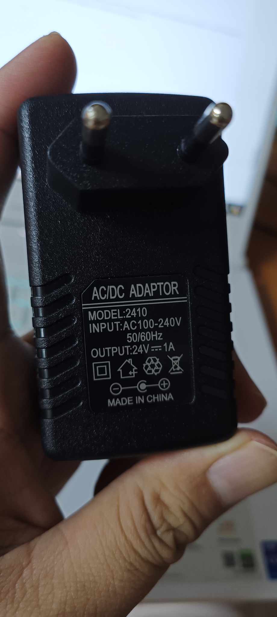

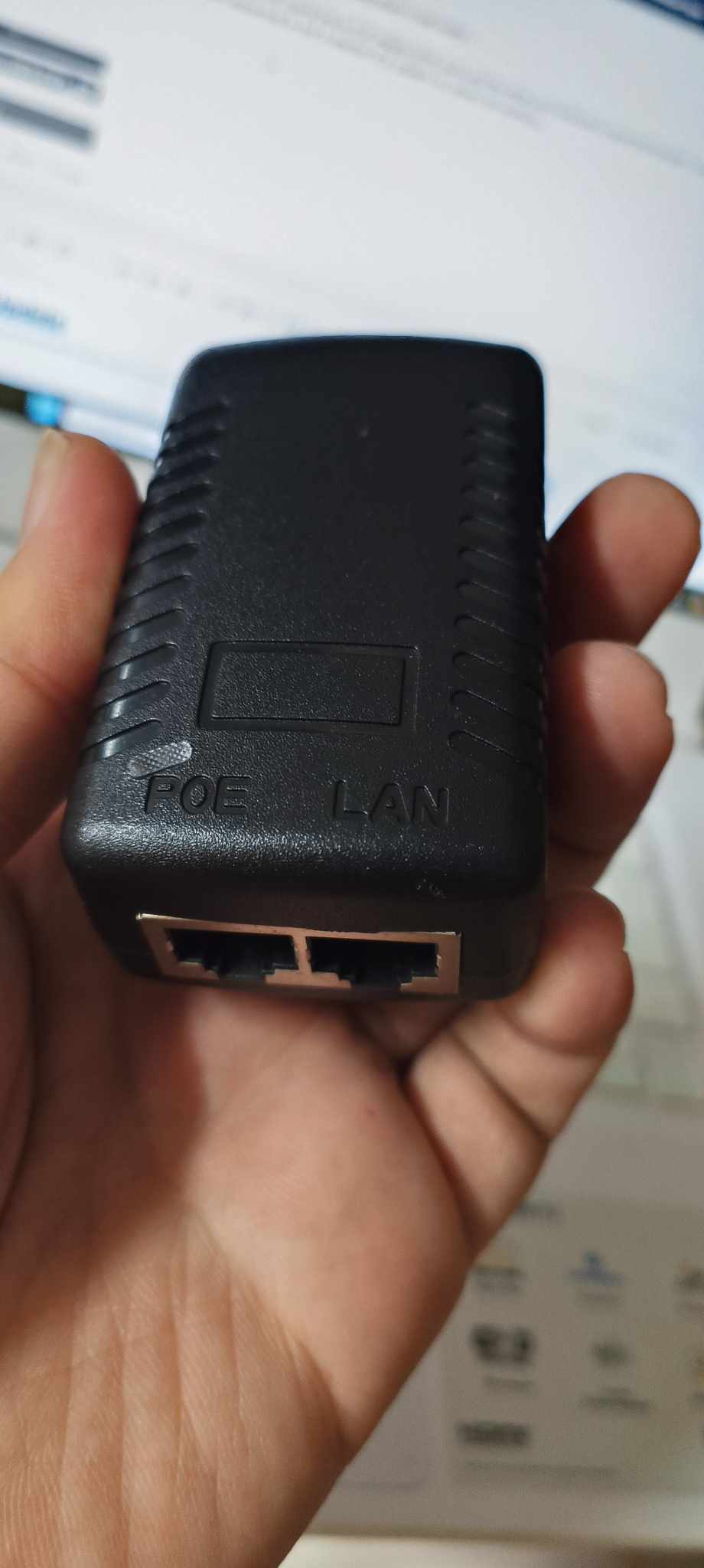

Thanks for the reply.
My DVR is DS-7208HQHI-K1 with 8 channels.
Actually I am trying to access the camera with my laptop for the setting where I read online.....
I also tried to connect] like what you said, Camera POE connected to POE adaptor (POE port), and the other port (LAN port) connected to Router... but not showing.....
DVR and Router are running properly, I don't know how to test it whether POE adaptor or camera not working.....

Thanks @Newbie here
When you plug the camera into that PoE adaptor, do you see any sign of activity from the IP camera? Do the IR LEDs around the camera lens light up for a few seconds?
Thanks @Newbie here
that the weird thing...... it seen not responding after I connected and tried with 4 cameras....
after that, i sent to my friend who working as technician in outstation and said all working and only didn't test it with DVR or NVR......
Or I need to try the reset button????
Okay,
You'll need to get your hands on another PoE Injector (preferably not the same model you already have) and test the camera on that.
If the camera doesn't work on the other PoE Injector that would suggest there is a fault with the cameras, if the camera does work on a different PoE Injector then that would suggest that the issue lies with your PoE adaptor.
