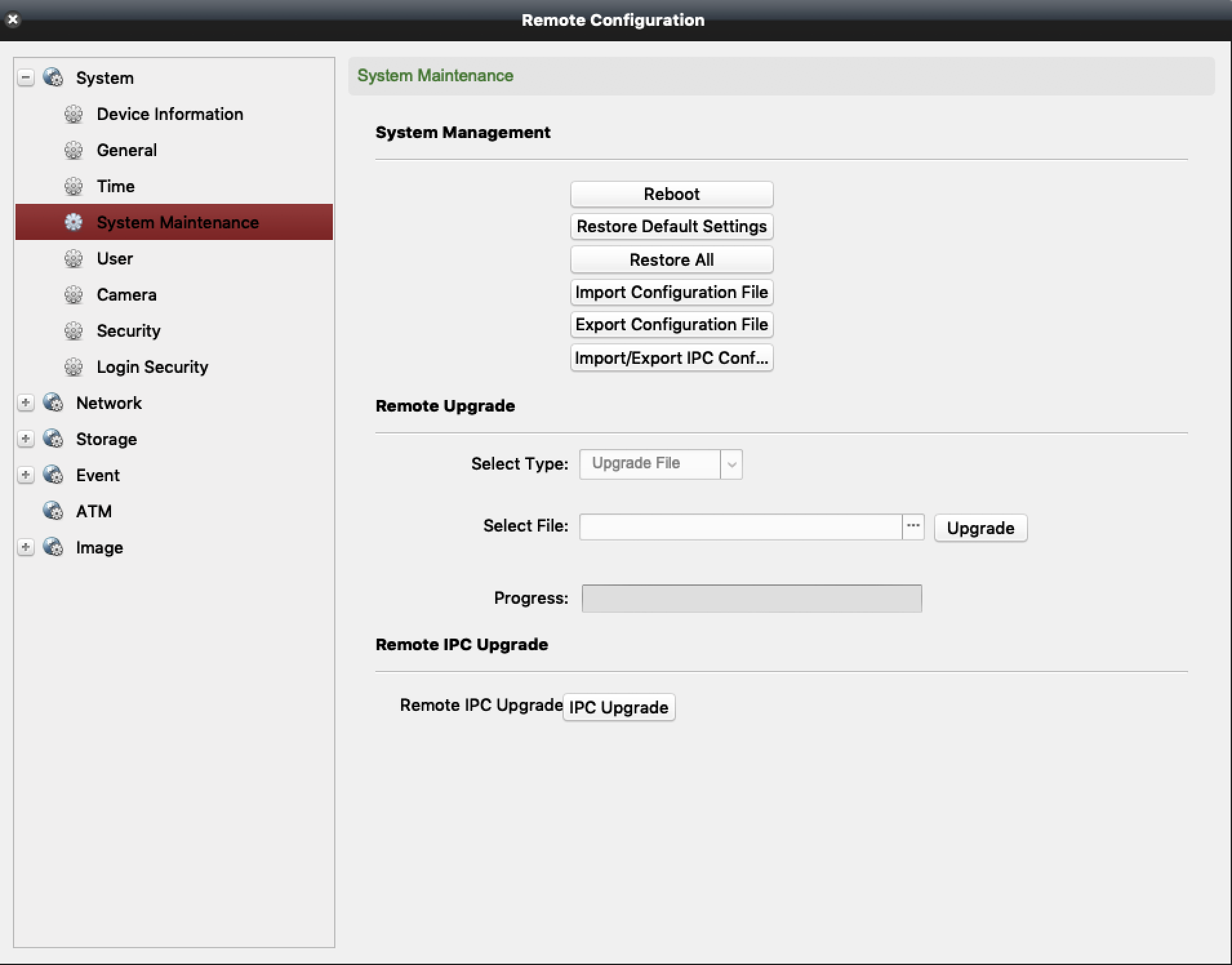

If you are a Mac user I would recommend that you access the cameras/NVR and update the firmware using the iVMS-4200 Desktop software.
The process for updating firmware in iVMS-4200 is almost exactly the same as in the browser you just need to add the devices to the software, select the NVR/Camera you want to update and click Remote Configuration which should bring a page up like the below screenshot and you can navigate to System > System Maintenance and select the correct upgrade file.
You will also see a button at the bottom labelled 'Remote IPC Upgrade' which will let you upgrade the firmware of any cameras directly connected to the NVRs PoE ports.

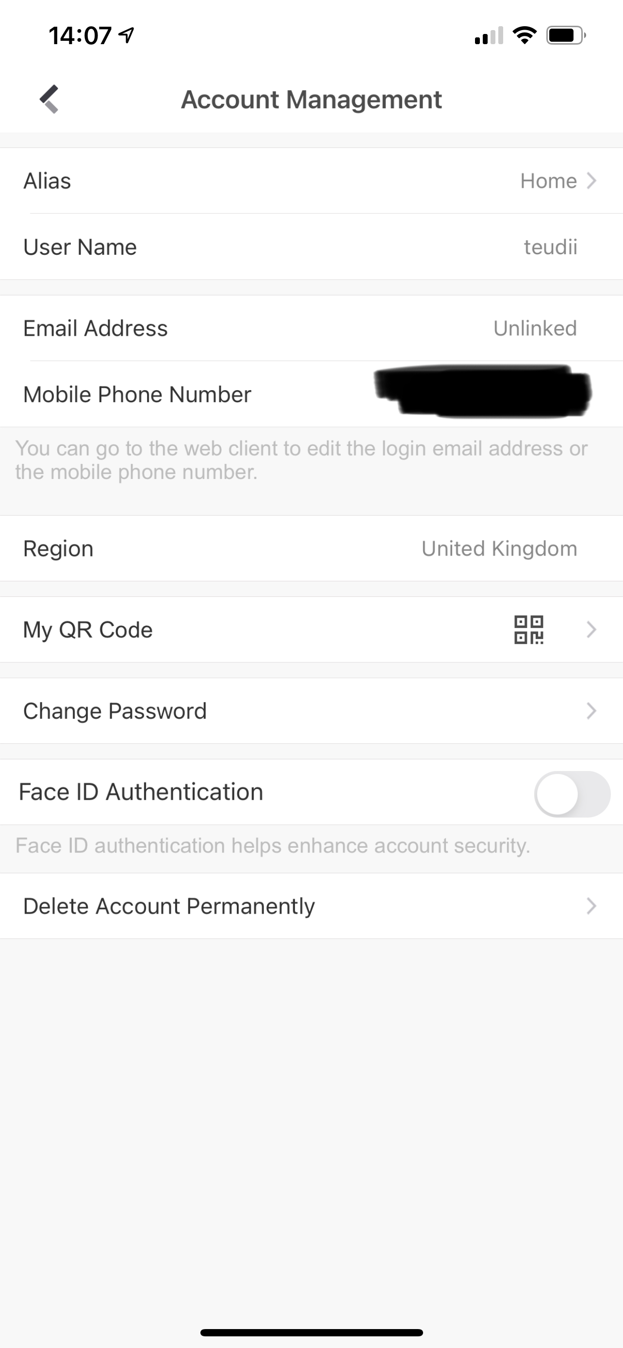

All the updates were successful. However, still cannot get the alerts. I am using the ProControl+ app, however, similar to prior the updates the alerts are visible in the log file in the NVR. Something weird that I completely missed is when I go to account management in the app I have a user called Teudii. Is that system generated as I didn't specify that. Or is that the account registered to the person who set up the security system and have now conveniently disappeared. Thanks

I am using the HIK-Connect app, as a matter of fact I deleted the Pro Control+ right after the firmware upgrade. Still no alerts. Is there an issue with the account registration perhaps? I was asked to connect by the person who setup the alarm and (who has gone AWOL) if I go to the account management of the app i see a username that I cannot recognize while the email address states unlinked while it does have my correct mobile phone number.
Thanks!!

Sure. Not sure who this user is or if it’s randomly generated. Also noticed that I get Device is offline when on 4G, which is odd. Thanks
Ok, I understand now, that is simply the automatic alias/username that Hik-Connect applies to your account when you register it, if you go to the Hik-Connect Web Portal and log in with the same login details you use on the app you will see the same alias there.
