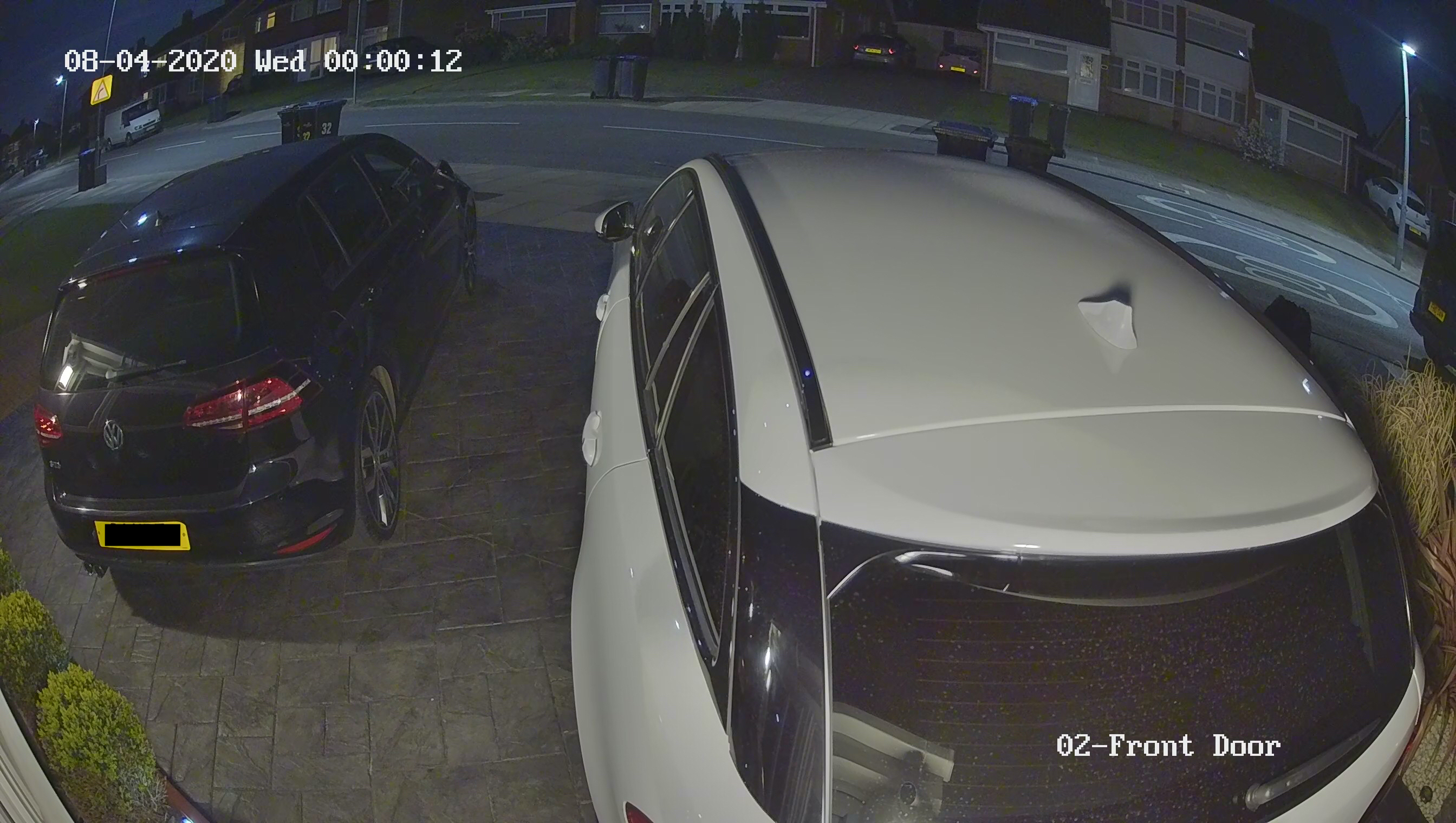

The ColorVu's are great if you've got "some" lighting. In that case, as I have with mine, you can just disable the supplementary white light completely. We have no street lighting close enough to our drive to be of use, but the 6W LED lantern I have by the front door is sufficient for me to get an image I'm happy with while raising the shutter speed to a more usable 1/100 second (1/12 second out of the box - not much use, will show motion blur at walking pace).
Last image shown is from last night 1/100 second shutter with my dawn to dusk light on. Bear in mind that that light (model Phillips Stock lantern) is warm white, probably around 3000K. I've had better results using 4000K daylight white lights. The ColorVu's don't fare too well if positioned where lights are visible in the scene - due to the large aperture, you can get some haloing/flare around the light source, so try it in position prior to cabling/fitting it permanently.

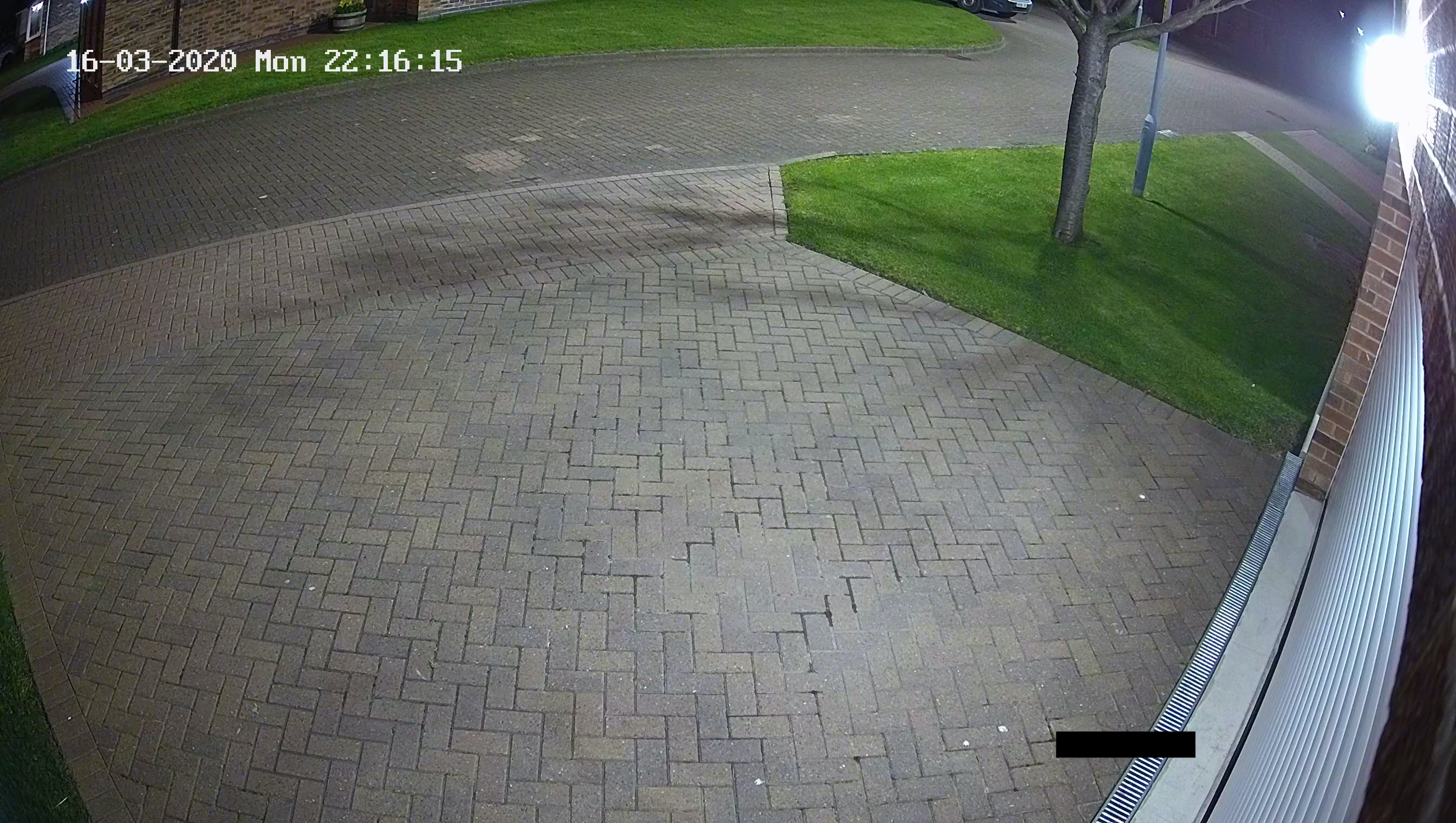

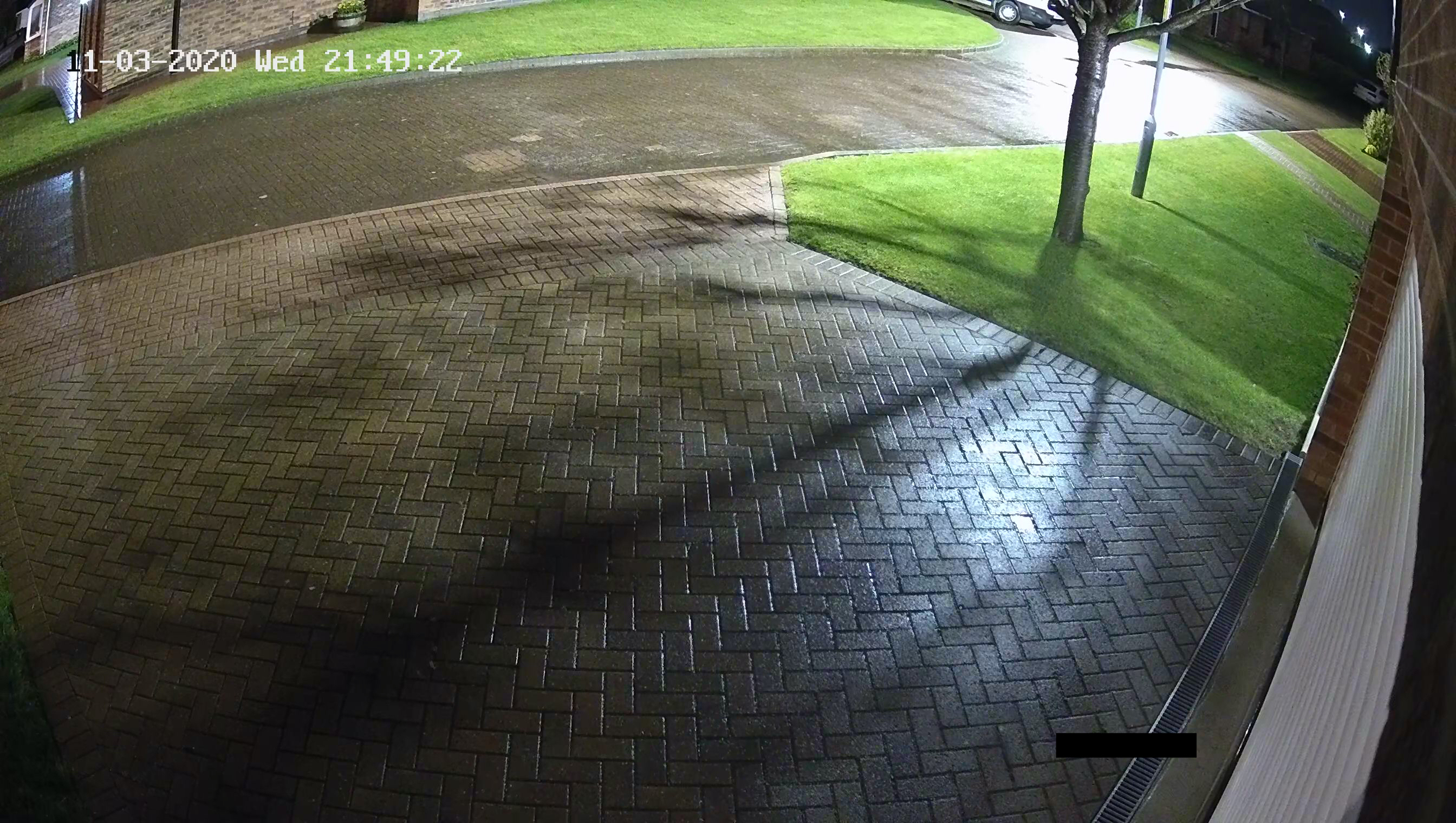

The other two images show a camera at 1/50 second shutter - one with only street lighting and one after I fitted a 10W 4000K bulkhead fitting (to even illumination and eliminate the shadow caused by the tree). The supplement light is enabled on that camera but would only illuminate if both the bulkhead light and street light were to fail - unlikely.
Last image shown is from last night 1/100 second shutter with my dawn to dusk light on. Bear in mind that that light (model Phillips Stock lantern) is warm white, probably around 3000K. I've had better results using 4000K daylight white lights. The ColorVu's don't fare too well if positioned where lights are visible in the scene - due to the large aperture, you can get some haloing/flare around the light source, so try it in position prior to cabling/fitting it permanentlyView attachment 3554View attachment 3555View attachment 3556. The built in supplementary white light LED is not at all "soft, warm" as Hikvision describe it - it's rather harsh.

Thanks for the pictures, They look fantastic.
