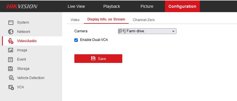

For that to work you must have 'Dual VCA enabled' for each camera. The below is from the NVR web browser menu. Your's may look a little different but it will be in the same section:

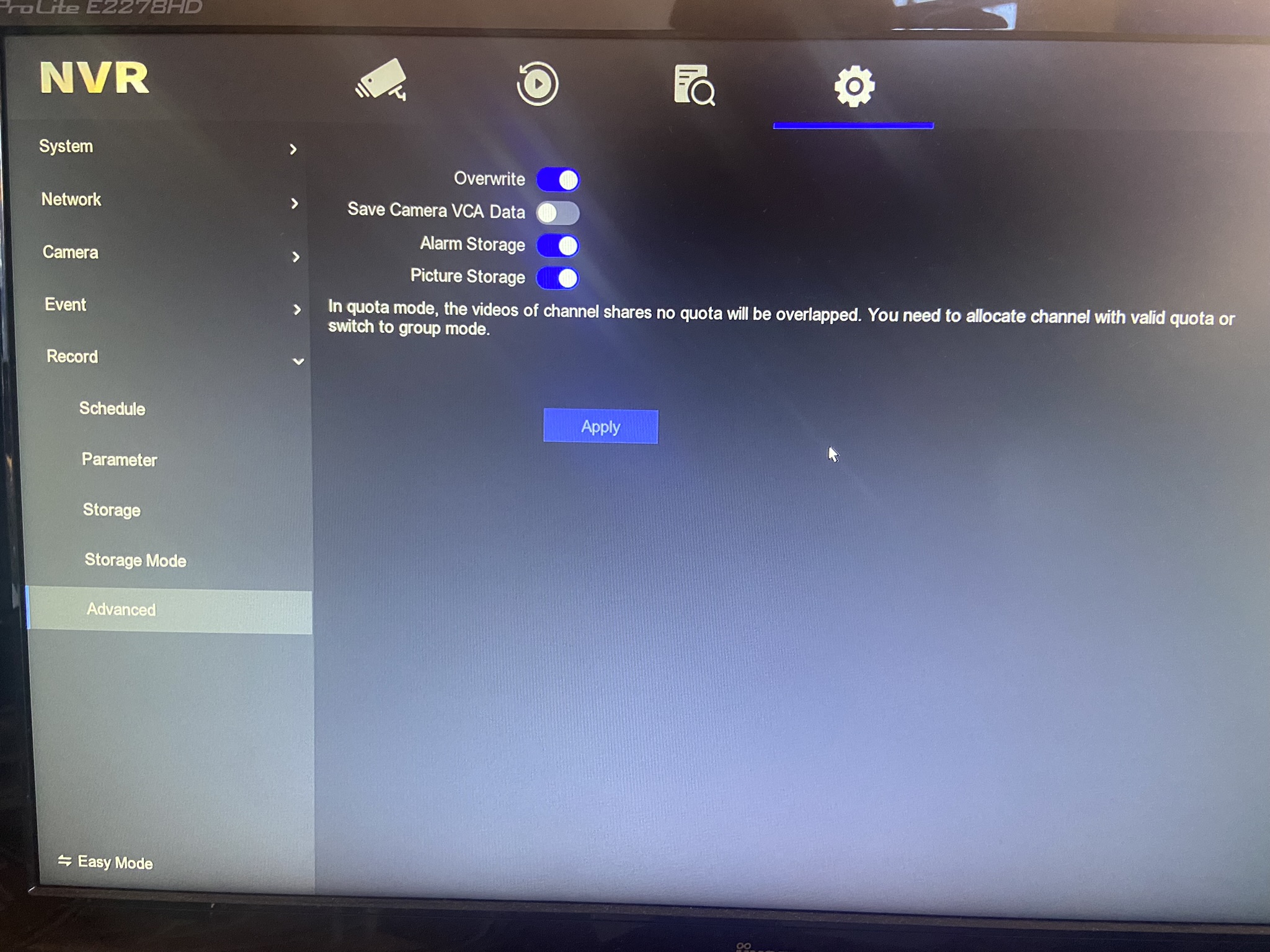

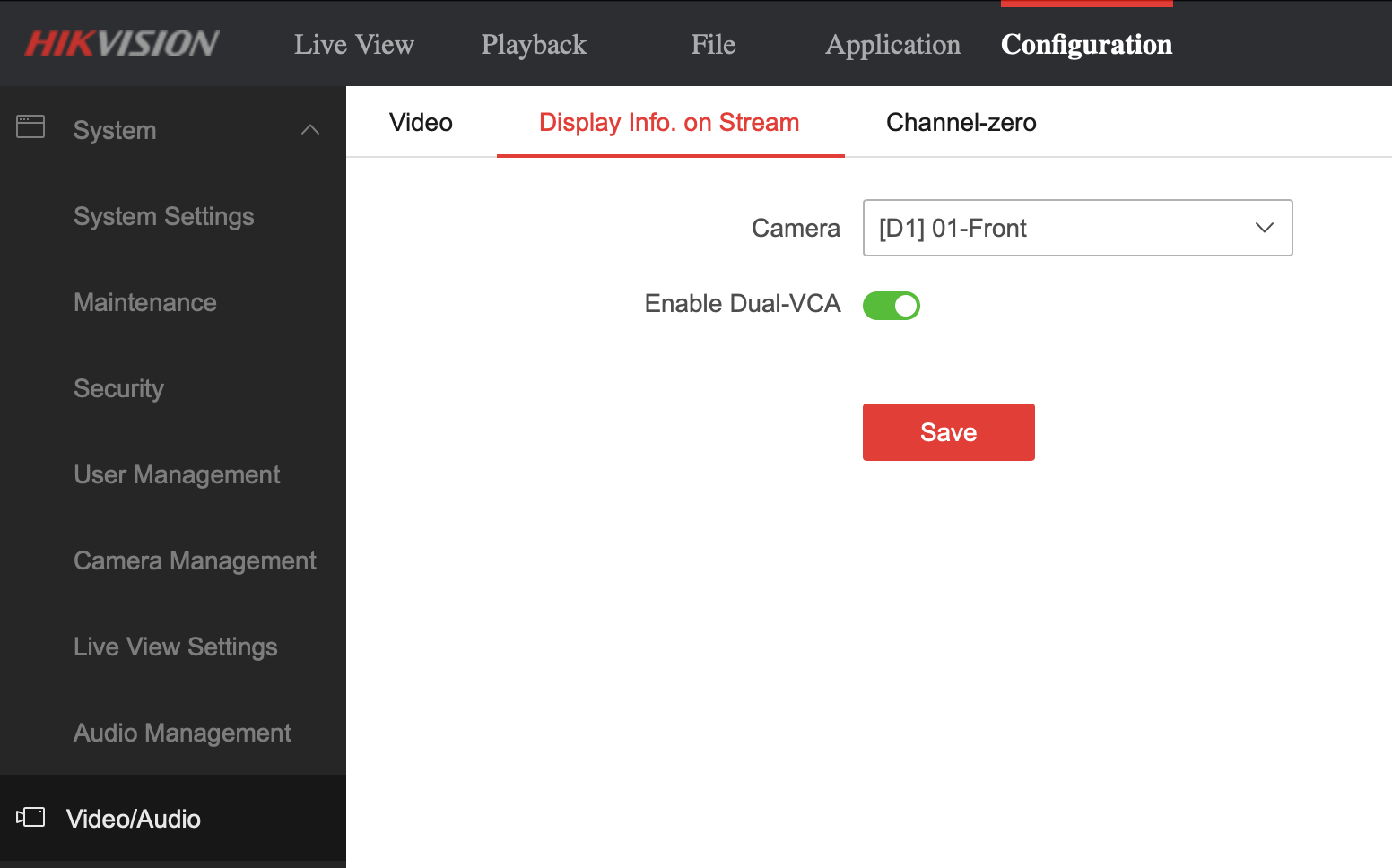

Also in the local menu find Storage > Advanced and ensure 'Save Camera VCA Data' is checked.

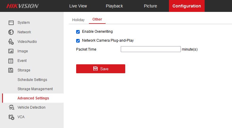

Thank you yet again for helping me with another problem. With regard to your suggestions I checked and the Dual VCA is enabled for each camera. I have shown just the one below :

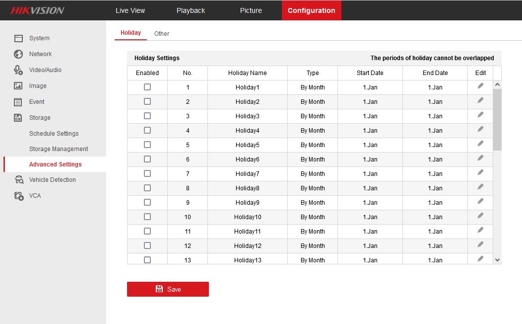

I am not sure if I am in the right place for your 2nd suggestion though. I tried to follow your instructions but this is the closest I could get to it :
I feel that I am in the wrong place with these last 2 screens.
The second option 'Save camera VCA data'...I don't think it's available to set from the web page menu currently (it isn't for my model). The steps I mention are to do this on a monitor/TV connected to the HDMI output of the NVR.
Sorry for the crude photo, but this is where the setting is :)
(Configuration>Record>Advanced)

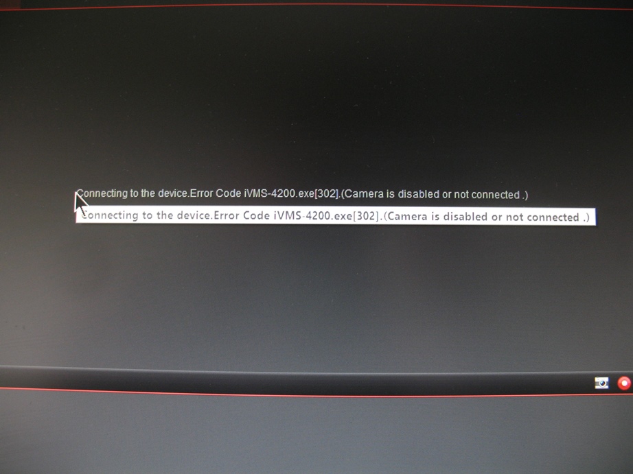

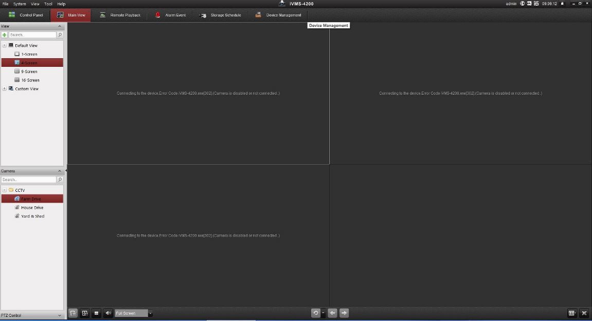

One thing that is happening more and more is that when I switch my system on my pc and it automatically loads up Main View sometimes the cameras aren't showing. Please see below :
If I hover over the message in the squares that should be showing the cameras I get this :

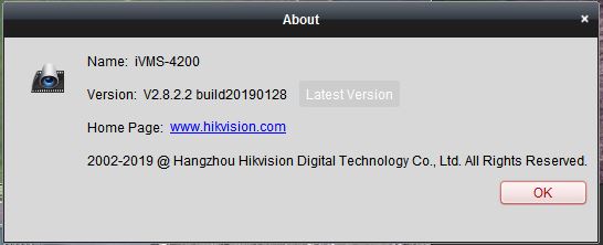

Something is dramatically wrong somewhere. This is the version of iVMS-4200 that I am using :
That's a very old version. Mine is on 3.9.0.5. I'd suggest you update to the latest version. Before you do go to System > Export Configuration File to save the current config. Run the latest installer then go to System > Import Configuration File to restore it. That will save adding your cameras back into the software.
Yes, I know it is an old version but I was working with a much older one and it was suggested to me that I upgrade to the latest version but I declined, probably quite wrongly as it has turned out. It would have meant that almost certainly I would have had another learning curve to overcome and that doesn't get any easier as you get older ! But in retrospect I think I need to upgrade to the latest version but I am still convinced that the NVR that was replaced is at fault.

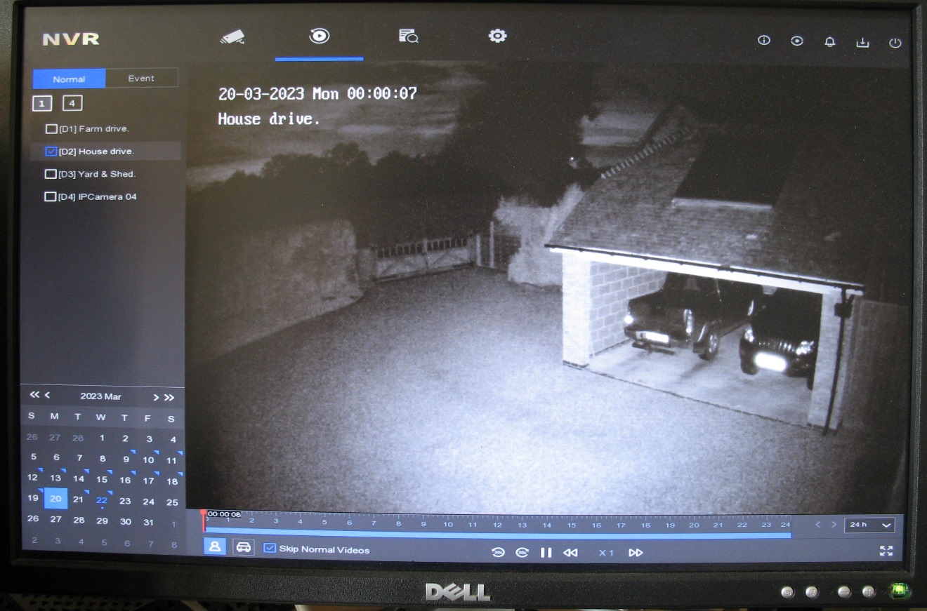

I'd probably concentrate on checking playback on the local monitor. If it's there then it's working. Is the disk in the NVR new or did you swap it from the old one. If the latter, you'll want to format it (or at the very least rebuild database) from the storage menu.

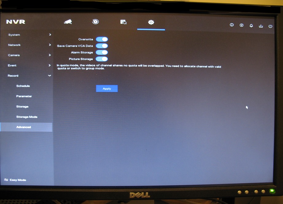

Firstly I checked my stand-alone monitor and sure enough, I could get playback for 20 daysso that's a start. I had been thinking that the NVR was only recording one day and then starting at midnight on the next day.
With regard to the Dual VCA I have used my stand-alone monitor and got to the same screen as @Kyle showed in #5 and unclicked the Save Camera VCA Data and then clicked Apply. I then proceeded to Remote Playback on my desktop and tried using VCA. Nothing happened of course as expected and then I went back to the Save Camera VCA Data box on my stand-alone monitorand clicked it on again. One thing that I am unsure about is when I am in the screen where I am able to click the Save Camera VCA Data box is that for all of my cameras and if not how do I know which one it is for ?
And finally, would I be correct in assuming that now because I unclicked the Save Camera VCA Data box and then clicked Apply to make the alteration, and then , after trying a VCA search I then clicked the Save Camera VCA Data box and then clicked Apply do I have to wait for some kind of intrusion before I know if it is working now or not ?
It's a global setting. All cameras send the VCA data alongside/embedded in the video stream. As I understand it, with 'Save Camera VCA Data' disabled, the NVR discards that information. With it enabled, it is saved and available for searching.

Not sure which cameras you have but if they are AcuSense models, all you need to do is click the little 'human' icon in the bottom left. That would show red markers when there were human triggers. Then clicking the 'ship normal video' checkbox that appears would cause the video to jump to each event and play it before moving on to the next.

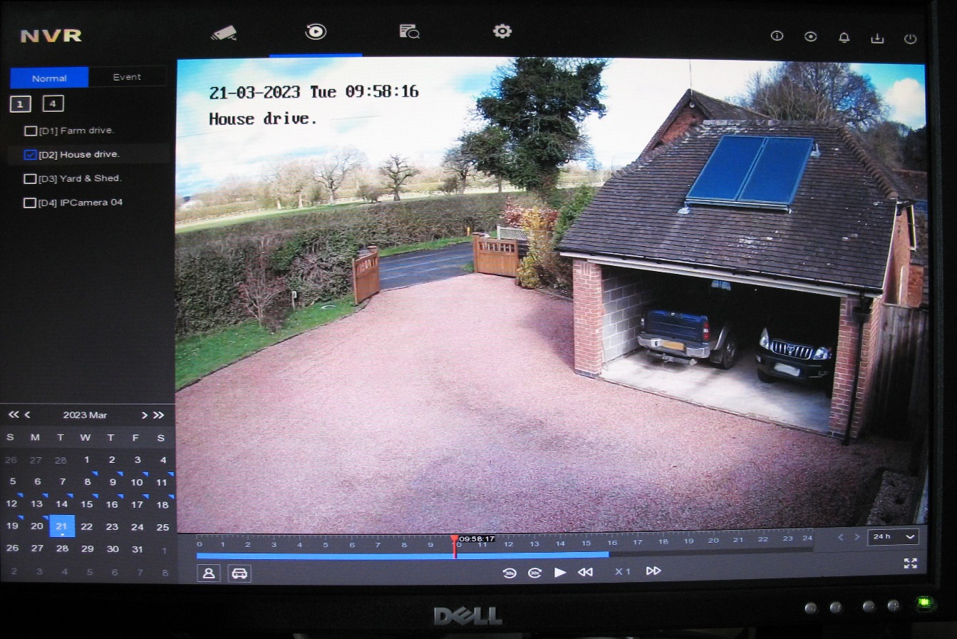

I did follow your instructions from your last post but couldn't get any visible events. You will see from the image below that I have chosen a camera, chosen a date, clicked on the "human" icon, and ticked the "Skip Normal Videos" checkbox. The red vertical bar appears above the blue video track at the beginning but doesn't show any events. I couldn't find a search command but maybe when you click the "Skip Normal Videos" checkbox that is a signal to the system to search ? I can move the red vertical bar along the blue video track and the view will respond. i.e. I can select other times of the day and see what would have been a current view.
I then tried something else which I noticed. At the top left there are two options : Normal and Event and so I tried clicking the Event icon and went through the same procedure as before and had a general play but still nothing. Maybe I have the wrong cameras for this set of options to work ?
Yes you have standard cameras not AcuSense so the Human filter will not work on them. AcuSense is available on some NVRs but not your model - for that you would need the DS-7604NXI-K1/4P. That NVR can be set up with standard cameras and apply the AcuSense filtering.
To do a VCA search on your model you would click 'Event' at the top rather than 'Normal'. There's then an option (I forget whether you hover over the red timeline marker or right click to see the option - my NVR is different) for 'Space rule'. You then click line crossing, draw the line and click the search icon and the timeline will be populated with the red markers.

Thank you. I clicked Event, made sure that I had a camera selected, double clicked on a relevant date, and then hovered around the timeline and found the "Space Rule" option. I clicked that, selected the "Line Crossing" option, drew the line and then clicked Search. The red Time Line marker never moved.
I also tried the same procedure with Motion Detection and Intrusion Detection but still didn't get any results.
