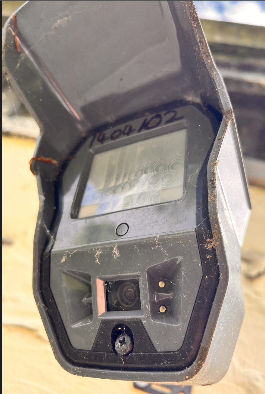

I wondered if some one can helped as we have hit a brick wall - We are after a cost effective CCTV system of around 10 cameras, that are battery powered (1 or 2 year battery life) and are on a movement sensor that reports back wirelessly to our phones, which we can then remotely trigger an alarm (there is no power to the site).
We are looking to own it as we have this system installed on a site but rent it (See attached an image of the current rented system.) and we are finding it hard to find a system that matches these requirements. We are happy for someone to design and source this and set it up.

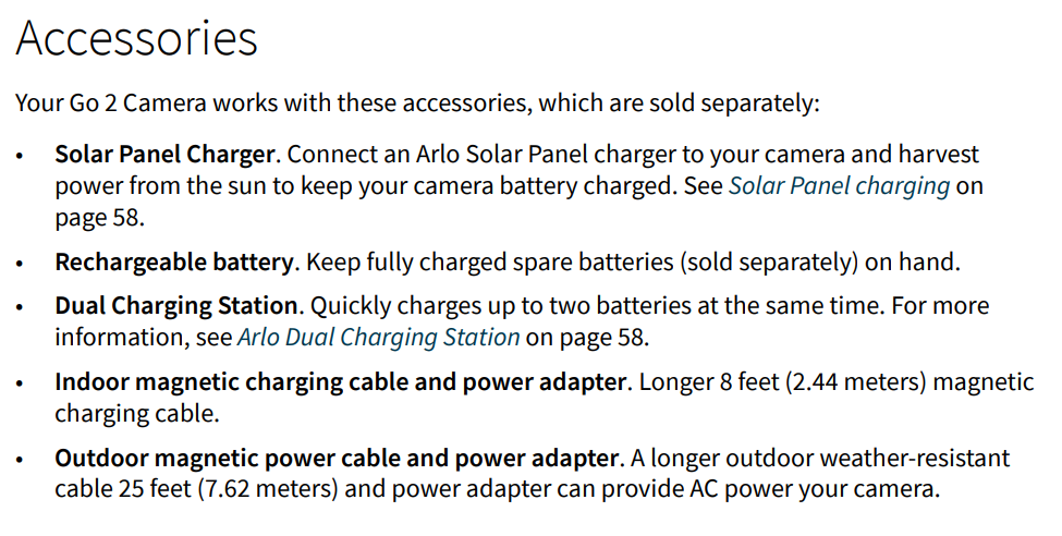

@Dan @Kyle do you know of any off grid 4g LTE PIR cameras? Power management would be a bonus.
This is the closest I can find, but I'm not sure if it's what you had in mind?
It's not something we have a huge amount of experience in. but we've recommended Arlo to customers before - this one has a PIR sensor for motion detection too.
It's battery-powered, but there are different options to recharge the battery or keep the camera powered:
(The below is from page 7 of the attached manual.)
