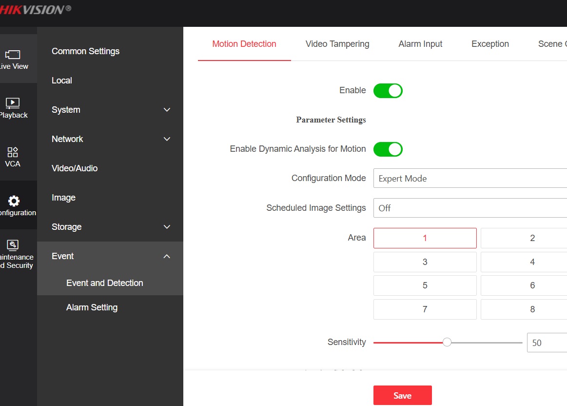

Instability in the firmware is suspected again as we are unable again to access the "smart event" settings even though the system is set to "Expert" mode. Quite why this should keep disappearing is beyond me. See image.
Mystery solved!
It appears that the latest firmware version has a less than intuitive way into the "Smart" settings. It is VCA -> 2 Set Application -> Smart Event.
Cunning, these Chinese but all's well that ends with a solution.
