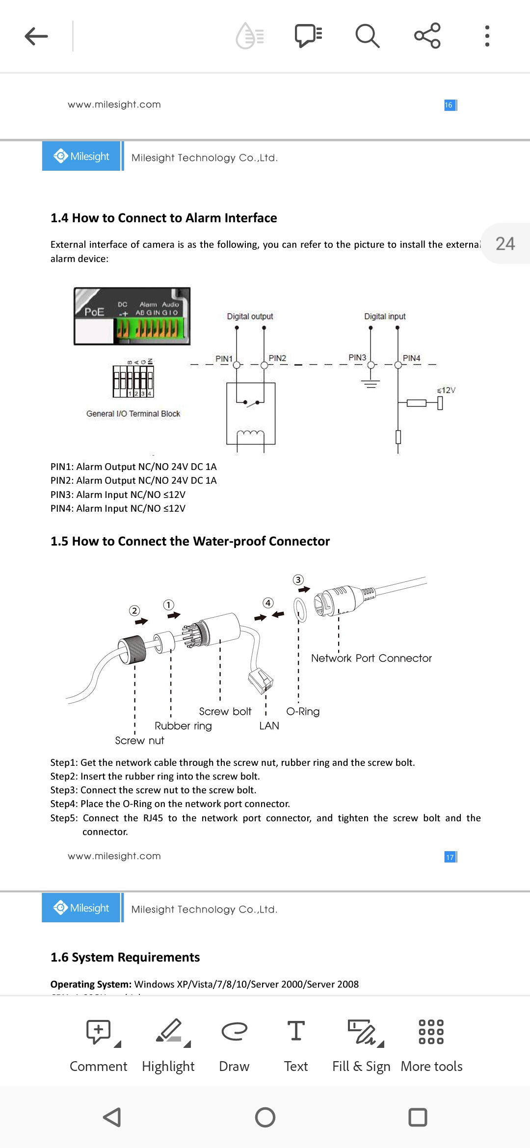

Hello Phil, my camera model is a MS-C5363-PB, 2.8 mm/M. It is a mini bullet camera. Th model of the auto dialler is shown at this website:
The UltraDial Mains 3G Covert GSM Wired & Wireless Alarm. It is the ultradial covert GSM alarm with mains adapter. The diagram from the Milesight manual for connecting NO/NC for the terminal block is attached.
What I need to know is: what is the name of the cable that I would need to connect between the camera and the auto dialler. What colour wires does this cable have. Which colour wire would I need to connect to which terminal block on the camera and on the auto dialler.
