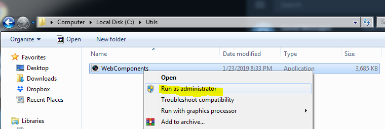

Use Internet Explorer 11 to access the NVR's web GUI, when prompted to install WebComponents.exe agree to download it.
Close all web browsers and run WebComponents.exe as Administrator (right click the file for the option)

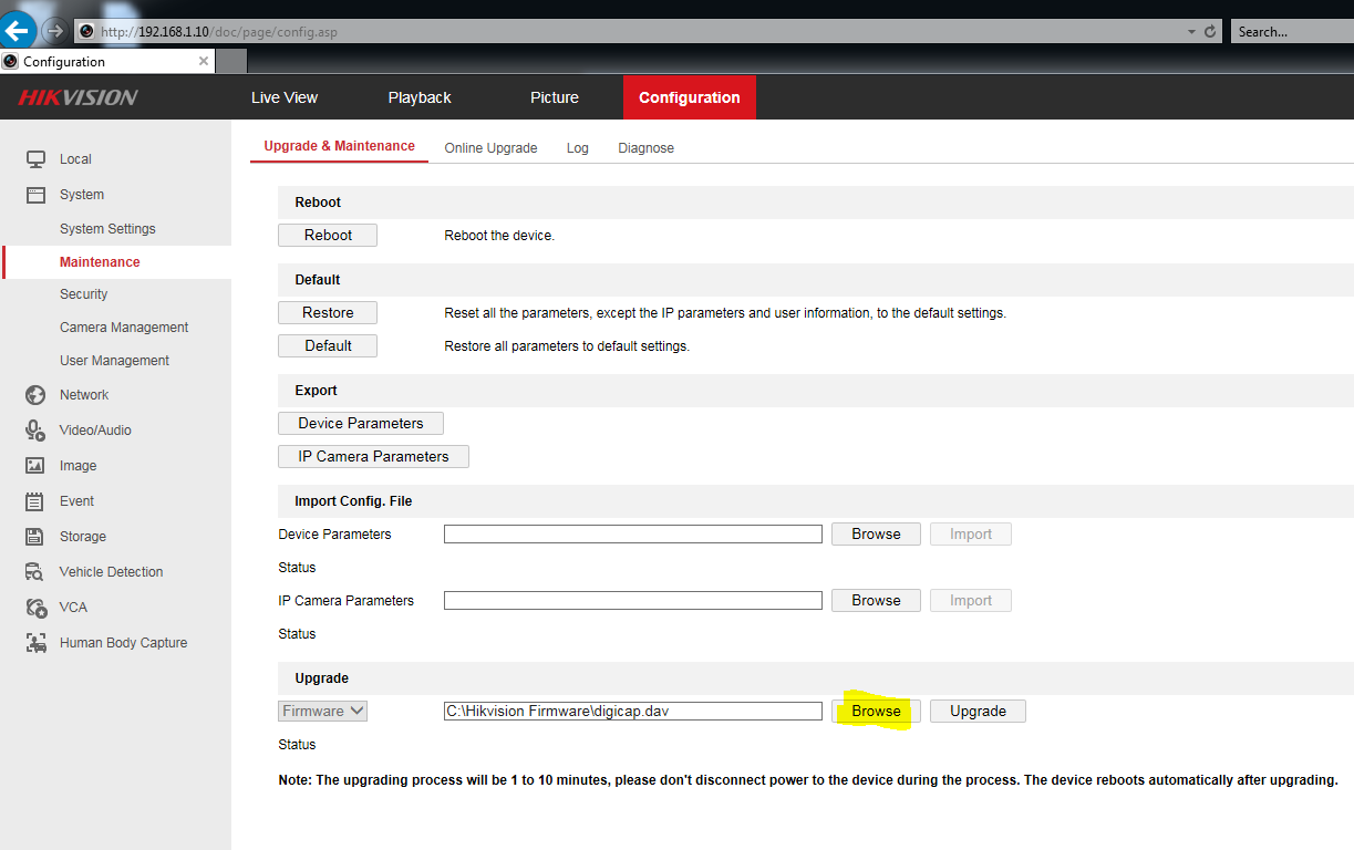

Navigate to Configuration>System>Maintenance and browse to the location of the firmware update file.
Then click Upgrade.

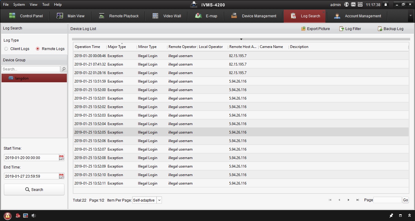

I get random attacks on my NVR (see picture) if I were you I would turn off email notification or it will drive you nuts.

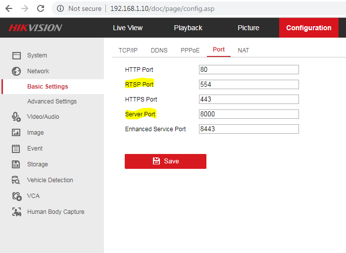

Changing your default ports might help. You can always revert.

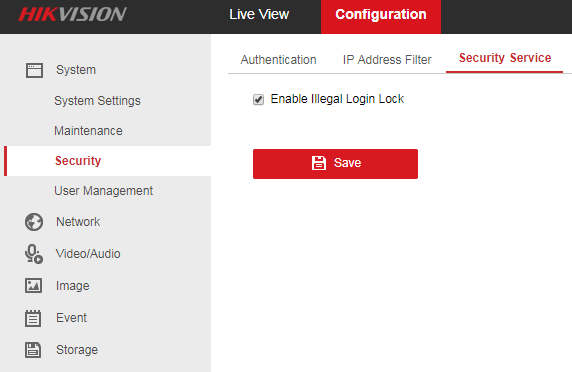

Another lead: (Can only find this setting on my cameras).
