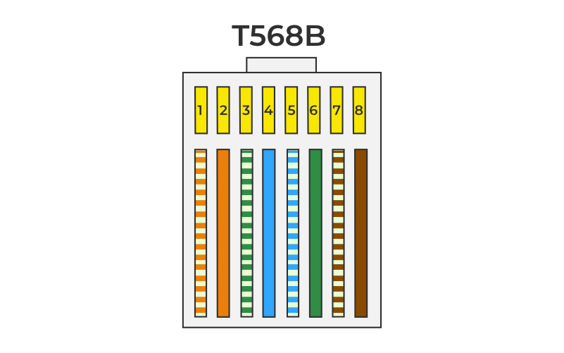

Please help I have cut the network port on dahua camera can you please help with the wiring these cables to rj45 the are 6 wires. its white-orange, white-green, orange, green, blue, brown. Please help woth diagram
Blue and Brown are POE - & +.
For a T568B Ethernet pinout, the camera connections are:
White orange -> white orange (1).
Orange -> Orange (2).
White green -> Green (3).
Blue -> Blue & White blue (4 & 5).
Green -> Green (6).
Brown -> Brown & White Brown (7 & 8).
