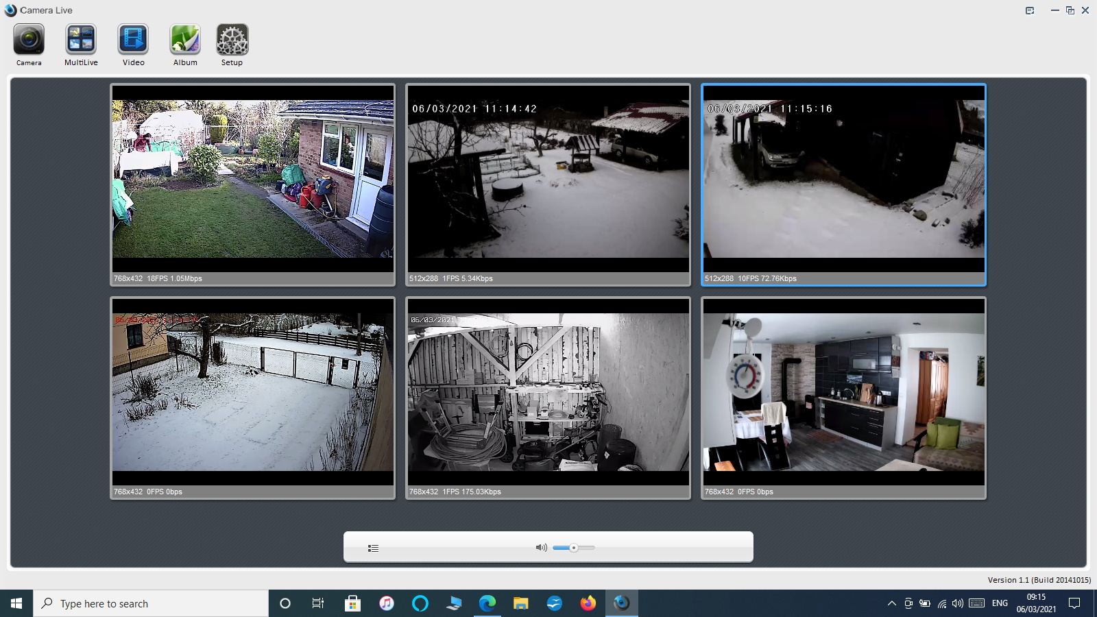

Hi Darren, I find myself in exactly the same position. I have 5 uCam247 cameras in Latvia, used to keep an eye on my place out there.
Firstly, I believe that they have broken the Sale of Goods act which requires support and spare parts to be available for up to 8 years after items are sold. It's bloody annoying.
I'm currently using an app called AnyScene which give me IOS access to my cameras in exactly the same way as their app used to. I also still have access through a browser using the cameras IP address.
Also, the desktop CameraLive also continues to work. See below.
