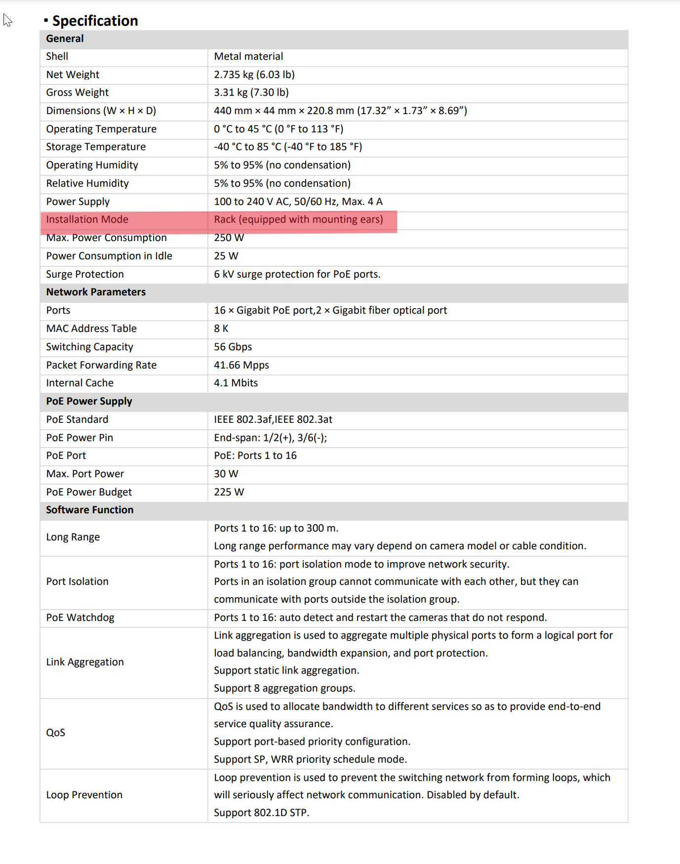

Anyone bought HikVision switches in the past? I was looking at a 16 port HikVision PoE switch, such as:
DS-3E1318P-EI
or
DS-3E1518P-SI
Does anyone know if these come with rack-mount brackets? The specs say nothing about brackets, the manuals say nothing either, some PDF docs I have seen show rack mount ears in the dimension diagrams, but others don't!
The HikVision NVRs I have bought don't come with brackets but they are available separately but for these switches I don't know...
Hi @codlord,
I have popped a screenshot below as well as attached the datasheets for these PoE switches, you should see that it shows that both options come with mounting ears :)
@Jake Many thanks. those must be updated specs as I was looking at HikVision spec sheets elsewhere which say nothing about installation!
