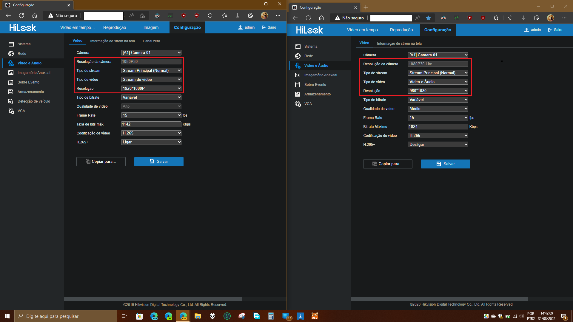

Hello folks. I recently moved to a new house and installed a couple of Hikvision HiLook cameras (THC-B120C-P and THC-T120C-P) and an 8-channel DVR-108G-K1 recorder. The issue is that while the cameras can stream and record at 1080p (or 2MP), the DVR doesn't actually support 1080p resolution, only a crappy "1080p Lite", aka 960x1080 instead of full 1920x1080, as you can notice in the screenshot. Obviously, the image quality is quite lower than a native 1080p, and screenshots/videos are squeezed horizontally almost to a square, as 960x1080 aspect ratio approximates too.

The DVR on the left (DVR-116Q-K1), that is installed in the condo where I used to live, is a 16-channel model that does support 1080p streaming/recording, while the one on the right is the one I have that is capped at "1080p Lite". I only installed 5 cameras in my house, so I don't judge necessary to pay substantially more for a 16-channel one.

Just to give a closure, I received the 208Q today and I confirm it supports true 1080p. 108Q must do as well, as it's just a previous generation model of Q series. In short, you should avoid 1XXG and 2XXG models like the plague if you don't want fake 1080p resolution.
