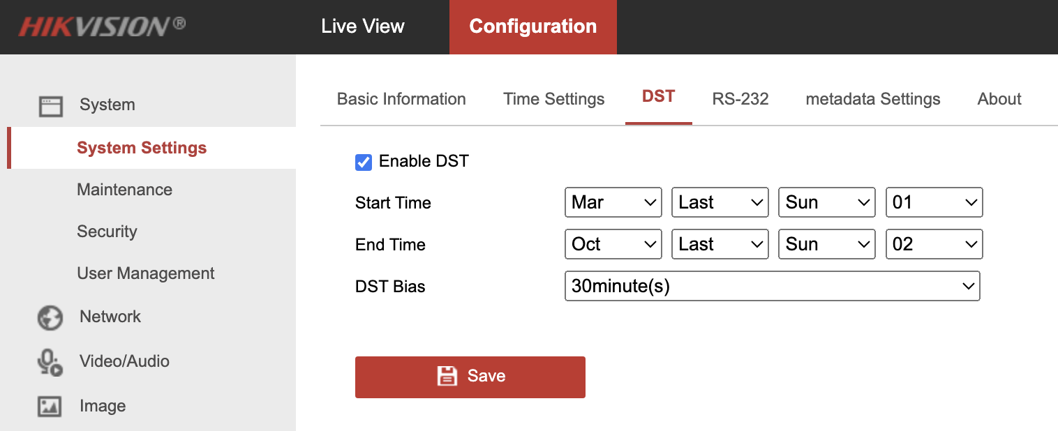

In regards to time settings, if the time doesn't correct itself after the firmware update then you probably don't have DST/Daylight Saving configured.
Hello Dan, Thank you so much for your help with this. It is very much appreciated.
I will have a look for the guide to doing the updates and hopefully try to get it done later today.
@JB1970, thank you for your tip. I will look at that too as despite having configured DST it is still showing as an hour out. As Dan says, the update may solve it.
