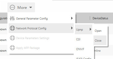

Yes there is a way
Using Batch Configuration Tool you need to disable new security on camera in order to connect to this old NVR
Add camera to BCT and press More and under security put Close
Then you can add it
Yes there is a way
Then you can add it

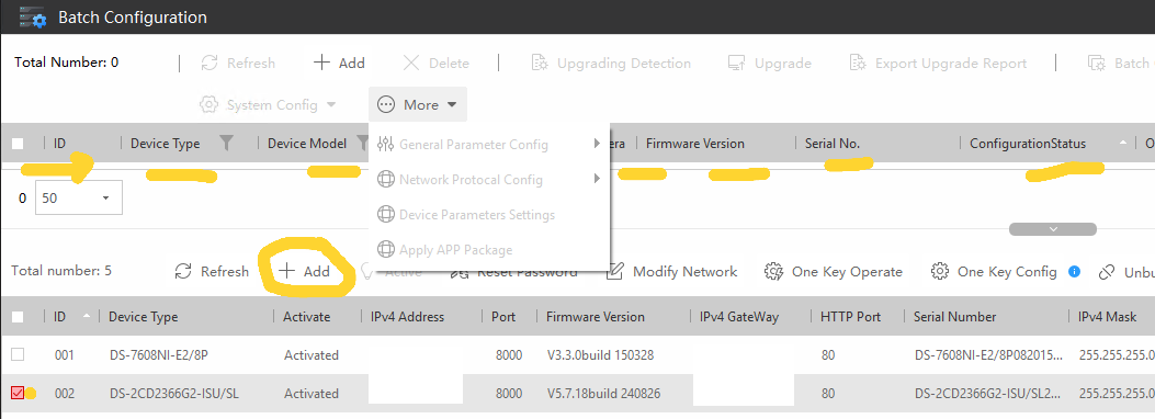

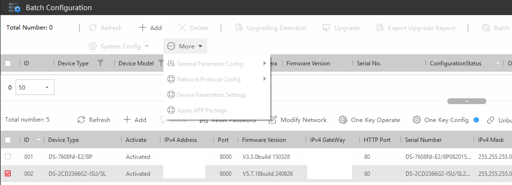

Hi first thanks for your reply.
I have downloaded latest Batch Tool and tried to apply as you suggested but it is greyed out and I don't see secruity option?
let me know tor thoughts on how to fix this?
see image attatched.
thanks Peter

Hi @Hagar ...
I don't use BCT too often, but I think you need to select the camera and hit "Add"... BCT will ask for the camera password and then move the camera from the "lower" list to the "upper" list... then you should be able to select it from the "upper" list and continue with "More" as @trempa92 suggests.

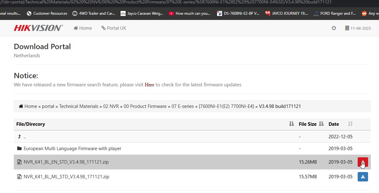

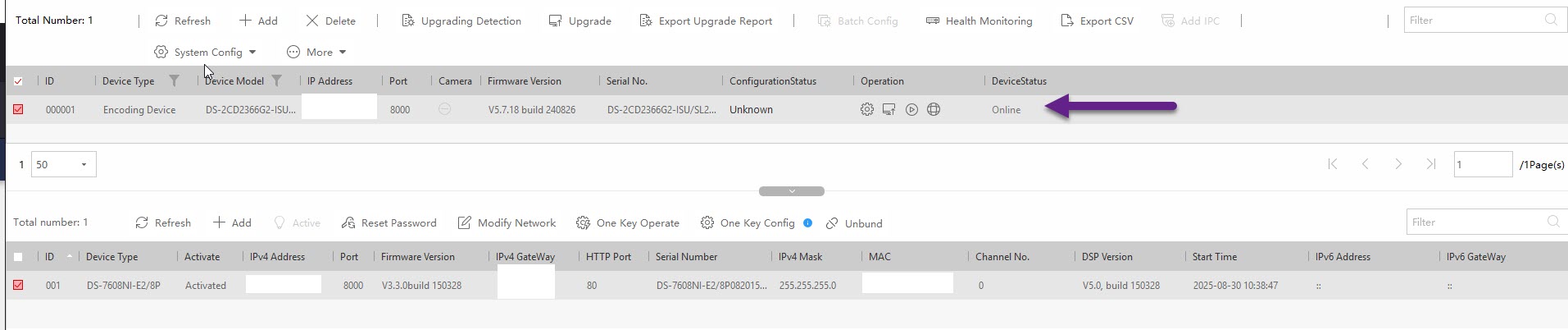

Hi John,
thanks for you reply did as you said and actually added camera to top section but in NVR still i have issue to recognise camera. I tried a few different settings but no go.
So my thoughts are
1) do I upgrade firmware from my old version v 3.3.4 to the v3.4.98_171121 which I downloaded from https://www.hikvisioneurope.com/eu/portal
2) will the OLD 7600 series NVR recognise bad firmware version?
3) I don't want brick it , if I do can I reverse the damage to previous version?
2) will this only give me basic Functions anyway like add camera and record as this camera has Mic Sound speaker functions etc.
3) Buy another NVR so I can add newer cameras to it with full functionality?
I appreciate your thoughts on anyone who has done this already what's best choice here (see screens shot of actual firmware file download )
thank you Peter

Are you sure you selected "Close" as @trempa92 suggested? I think this is the setting he was referring to:
I would definitely consider getting a newer NVR as the E series is quite dated, has limited bandwidth, and does not get any new firmware updates related to security. Also, it may not play well with the latest Hik-Connect if you use it.

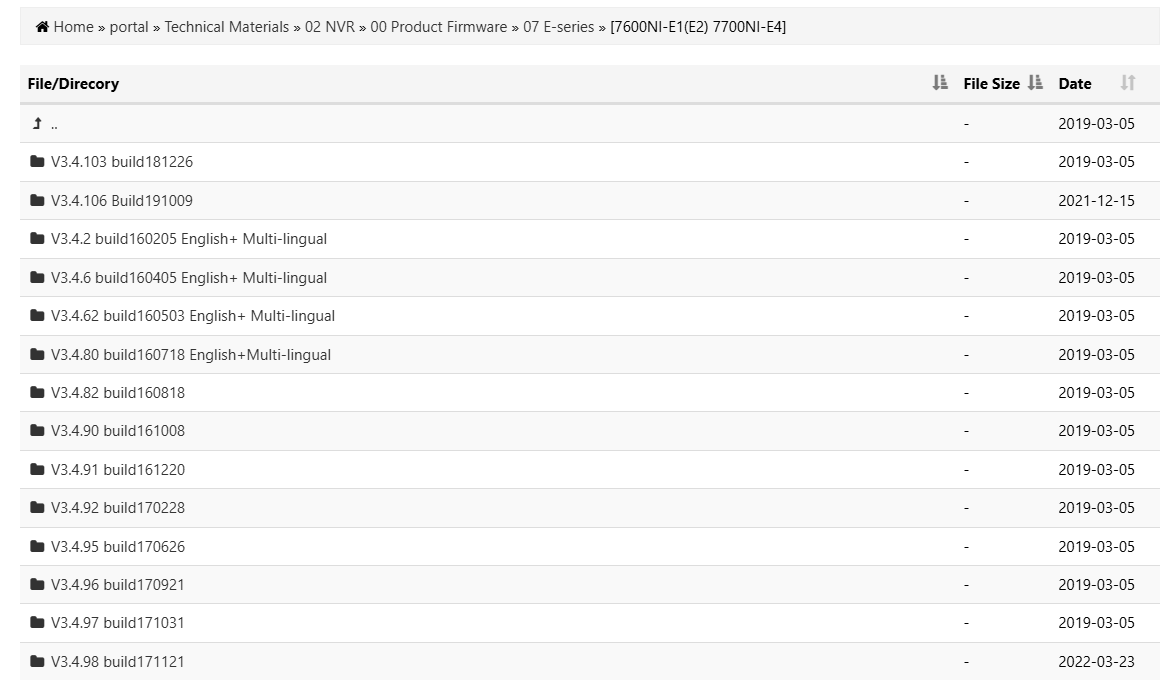

If you do want to try upgrading the firmware, the NVR generally will not load a firmware that was not intended for it... but I think you may need to step though loading interim versions before loading the latest... I'm not sure, but I've definitely seen that required before when others have updated very old firmware. So, if you are going to try updating, I would suggest loading the V3.4.2 build 160205 first and see how that goes.
The latest version for your NVR seems to be V3.4.106 build 191009... I think you missed that because it is towards the top of the list:
Decisions, decisions! Let us know how you go :)
