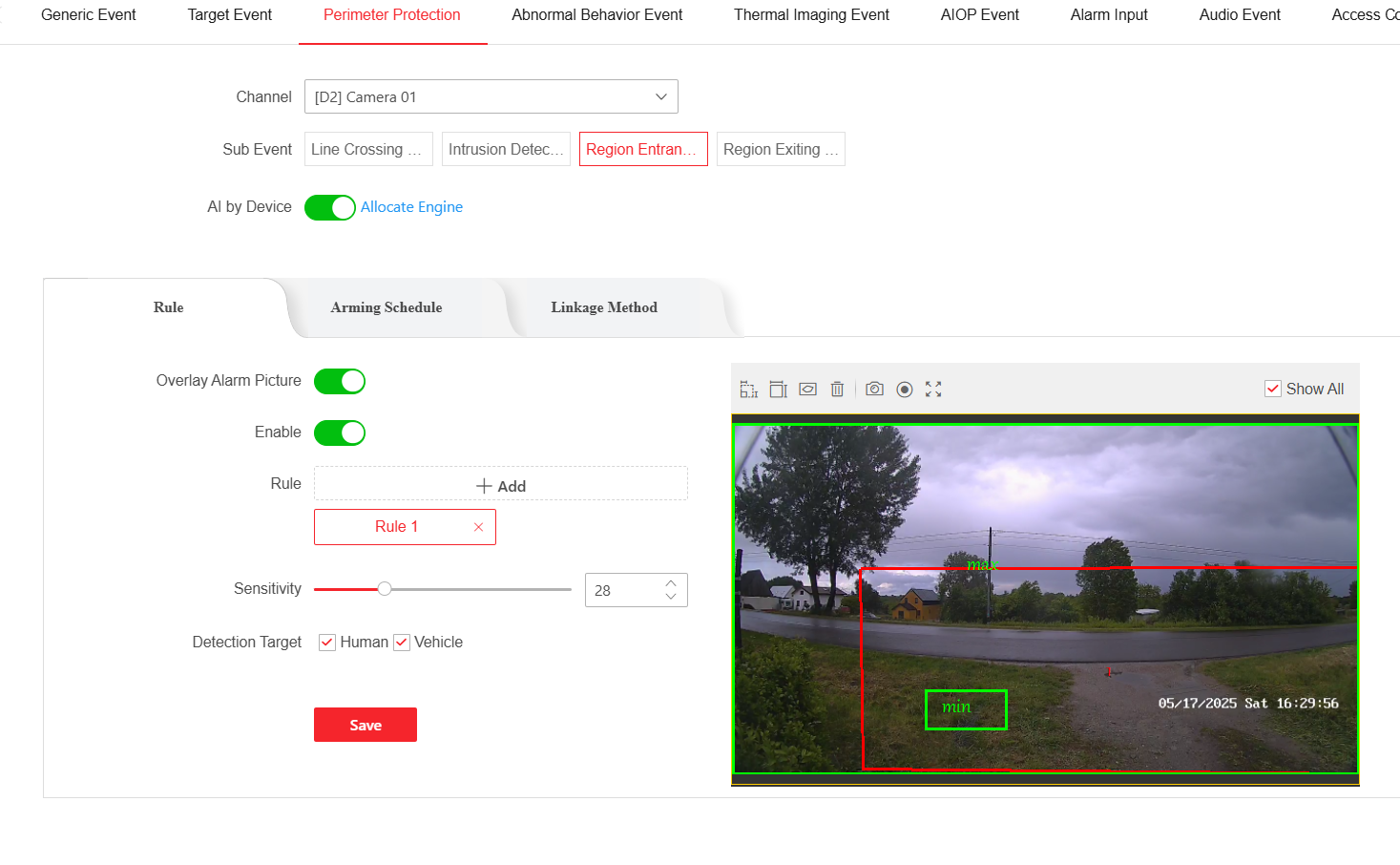

I'm struggling with getting my door station to work.
I added it to my new DS-7608NXI-I2/S. In event configuration ticked AI by device, allocated AI engine as perimeter protection and configured the Area Entrance event as seen below.
It doesn't seem to do anythng. I reduced Min box to catch passing cars, but no events are being triggered. What gives?
Also ln my Hik Connect app i don't see green "hit boxes" but as far as I understand its only because the Door Station doesn't support the Dual VCA feature, am i right?

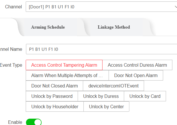

Also 2: how can i react to the door station button being pressed? I cant see any matching event.
Any suggestions are welcome.
TIA.
Try "deviceIntercomIOTevent", it might be there. I have the M Serries and that's where it was on V4 firmware but it was removed altogether in V5 so I'm not sure.
