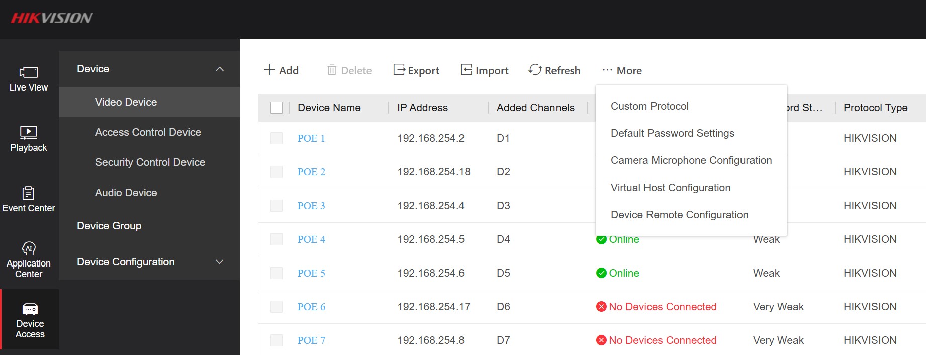

Can't help with V 4.0 but here is mine on V5.04.050

It is in Configuration > Network > Advanced Settings > Other (tab at the far right)
