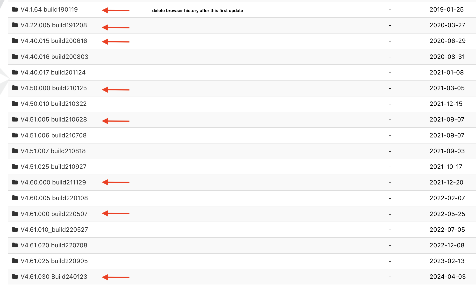

There's a lot to update through on the NVR as it's back on V3. The arrows in the image point to the updates to go through. Be sure to delete the browser history after the first update (or at any time the page fails to load or display correctly after reboot):
The portal page containing the necessary updates is here:
UK Portal - I Series

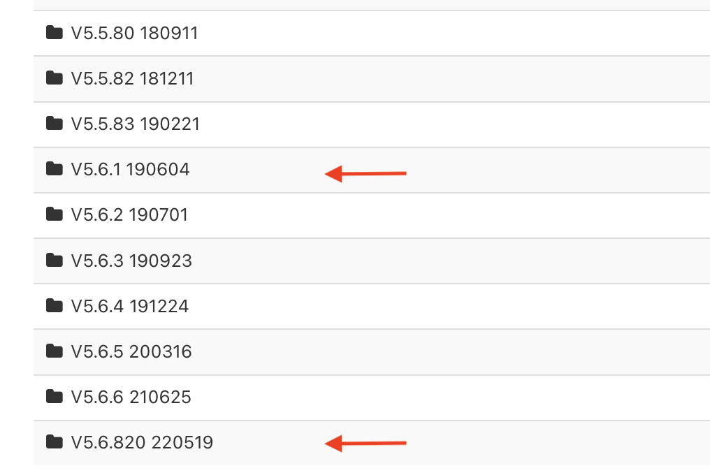

Do the NVR first; the cameras can be done afterward.
You'll probably be fine updating the G1 cameras directly to the latest version but if you want to be sure do the following 2:
The G1 firmware can be found here:
UK Portal - G1 Firmware
