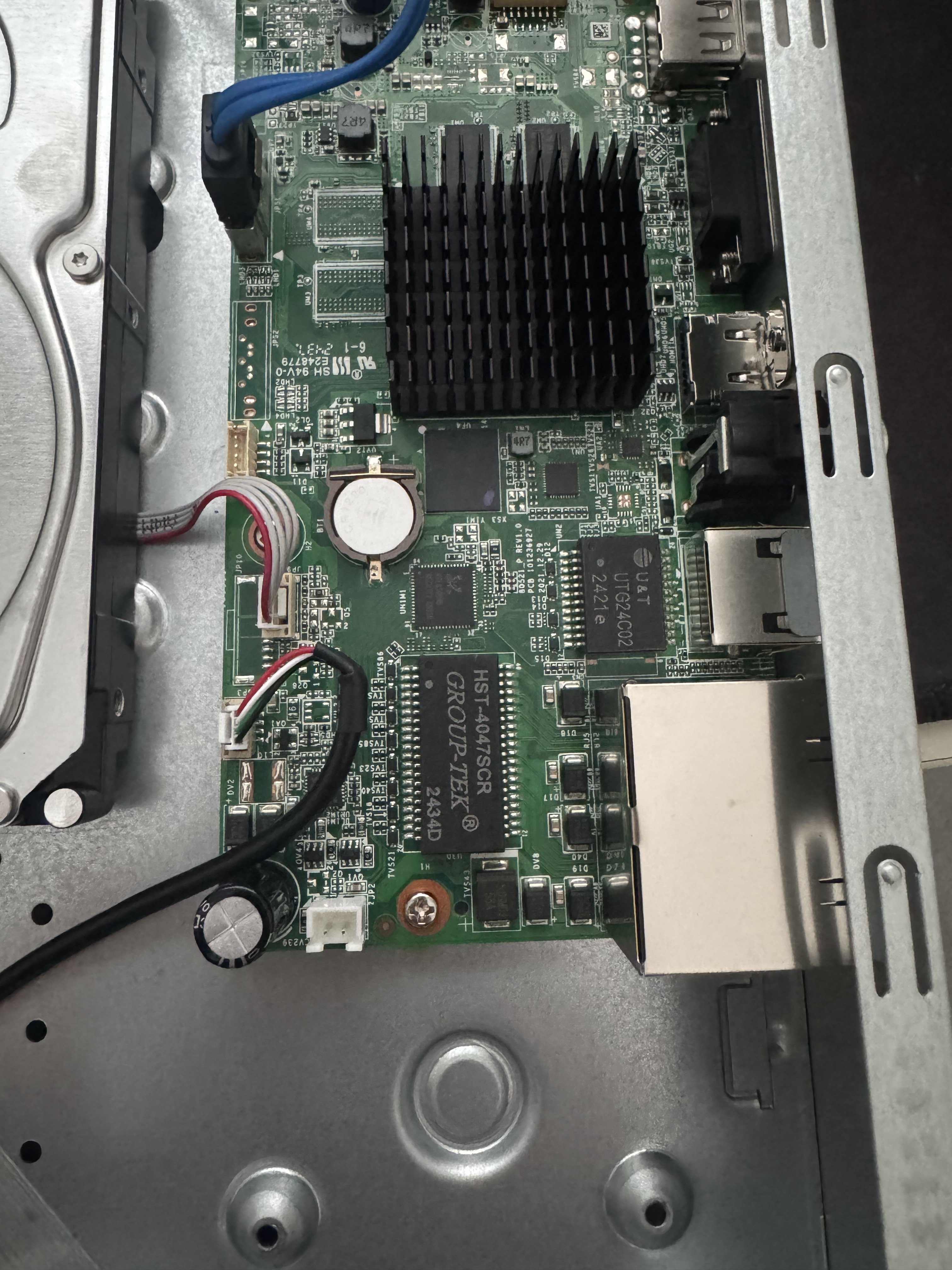

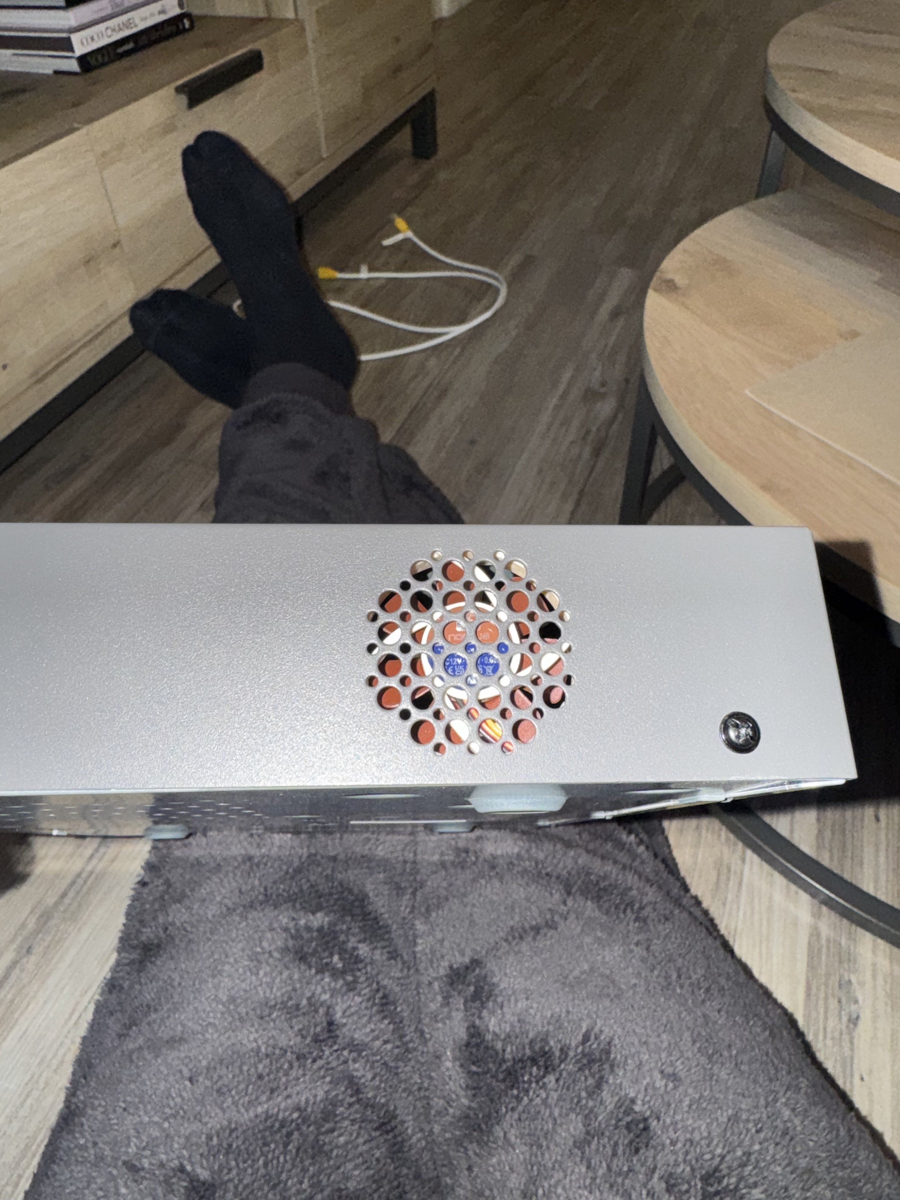

Hi JB ,just a quick question mate , ive had time to take out my NVR today and check it out , obviously comes with no fan as you say , im thinking of fitting one my self to save time having to send mine away and be without cctv for however long etc , do you know what voltage I would need ? im guessing it would be 12v ?
Here is some pics I have just taken ,is it just the 2pin connecter near the capacitor?

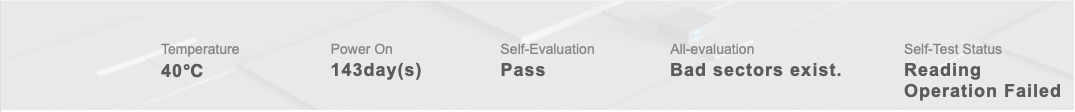

To add , when I turned it off and disconnected the cameras etc it was warm . not boiling but warm , I don't know how to check the temperature of the HDD anymore when logging in on virtual host as the layout has changed and it seems like they have taken that section away.

Yes it is that 2 pin connector and the fan you’ve shown should be fine. I see the temperature alongside the HDD SMART information in the Hik Partner Pro app, I’d have to have a look to see if it’s available via the web.

Try running the HDD tests from the menu. I'm not sure where they are on your model but in mine (V5 UI) they're in System Maintenance > Device Debugging > SMART Detection (if not in maintenance they will be somewhere under storage management). There's a short and long test, and they will highlight whether the disk has any bad sectors.

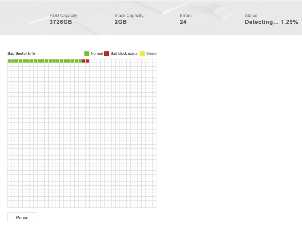

Thanks for that mate that is where the info is, im running a short test and it just keeps coming back saying reading operation failed. But everything is still working as normal via hikconnect and recordings of events etc.

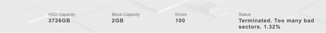

Nevrmind I think the HDD is goosed now lol. It was working fine until I ran the bad sector detections , I have tried to re initialise it etc but it's having none of it now so hey ho lol.
I had similar on one a while back. A bad sector was detected but it was working ok; as soon as I tried to initialise it, it wouldn’t and had to be replaced.

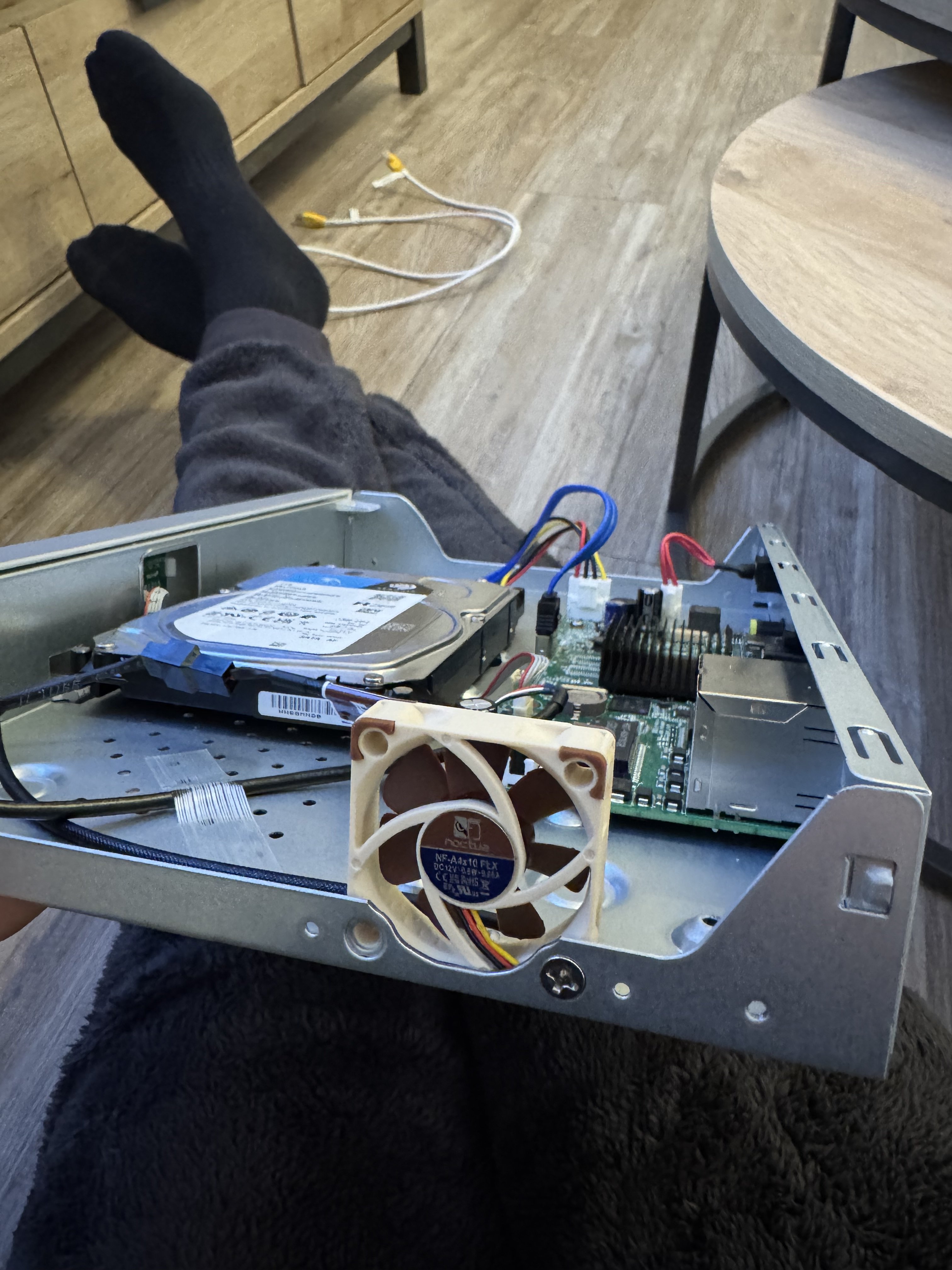

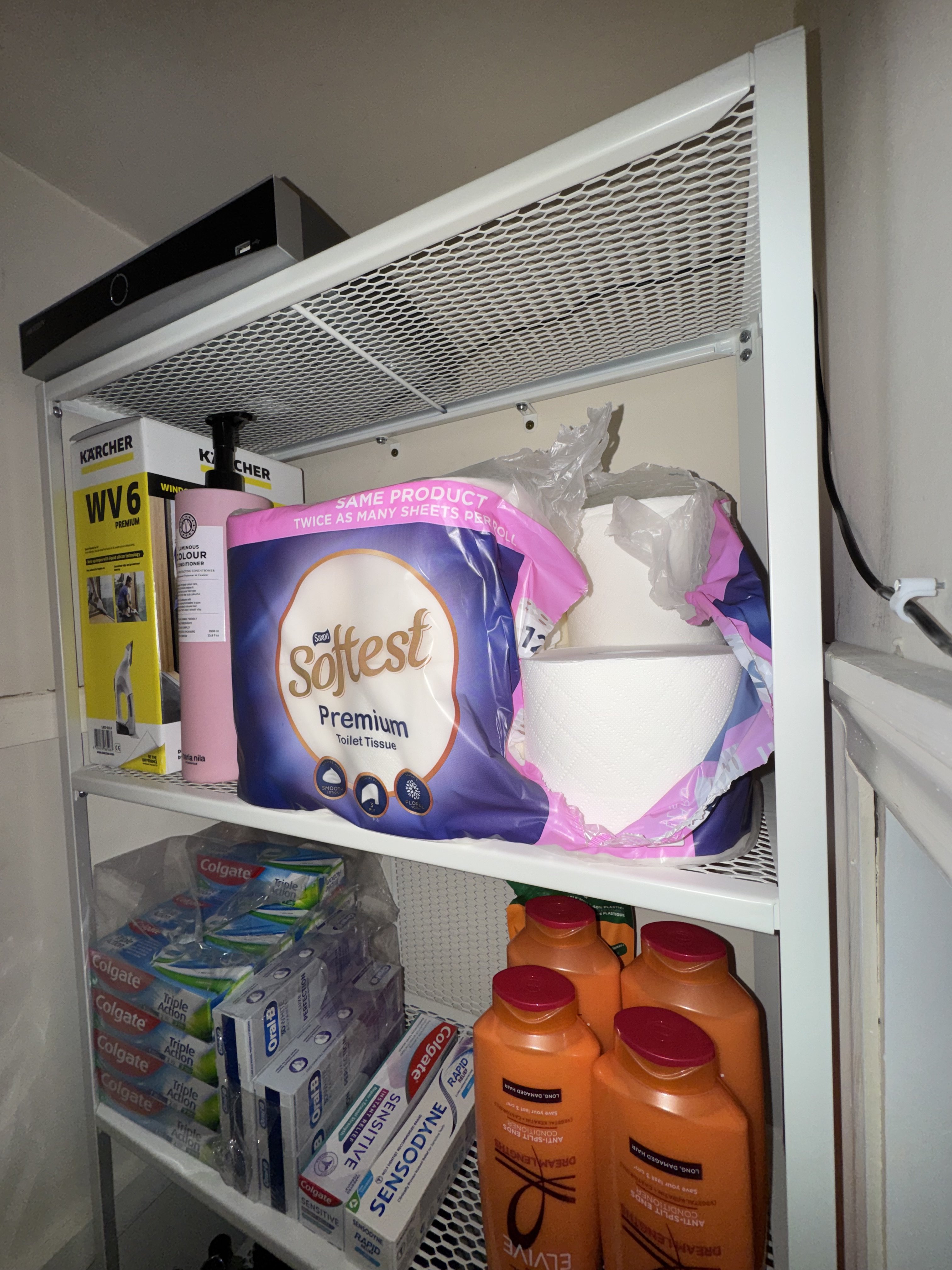

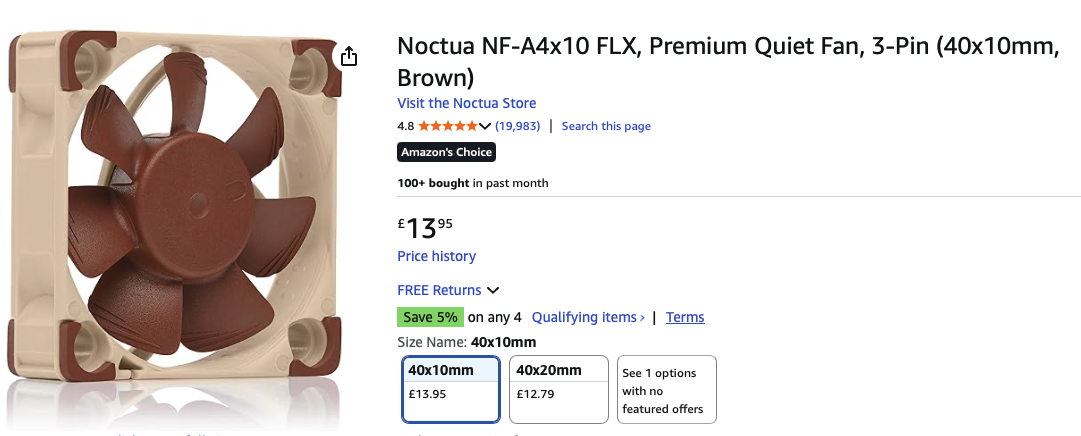

Im going to speak with them now and get one of them Noctua fans ordered , going to look at some sort of cool mat aswell may help a bit. It is placed in the boiler cupboard but on a open shelf with the cables coming from the loft into the NVR, It doesnt really get that hot in there so that's why I never thought it would be a issue putting it in there , I specifically avoided putting in the loft due to the heat during the summer and now I have this haha.
The 40 degrees your earlier photo shows is at the upper end of what I see but not extreme. I've just checked a few of mine out of interest. The lowest are those in a loft (lowest 12 degrees, highest (my own) 18 degrees). The hottest is in a boiler cupboard - 45 degrees (those disks have been in for 8.5 years)
