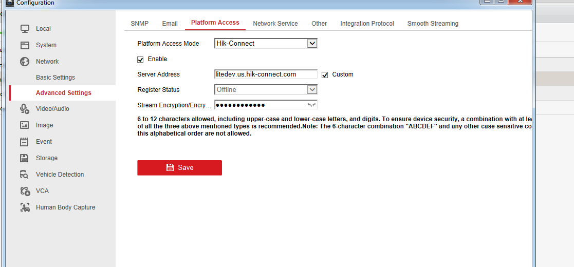

I just cannot get the Register status to go onto online no matter what i do

ive tried litedev.us.hik-connect.com litedev.hik-connect.com and also dev.hik-connect.com

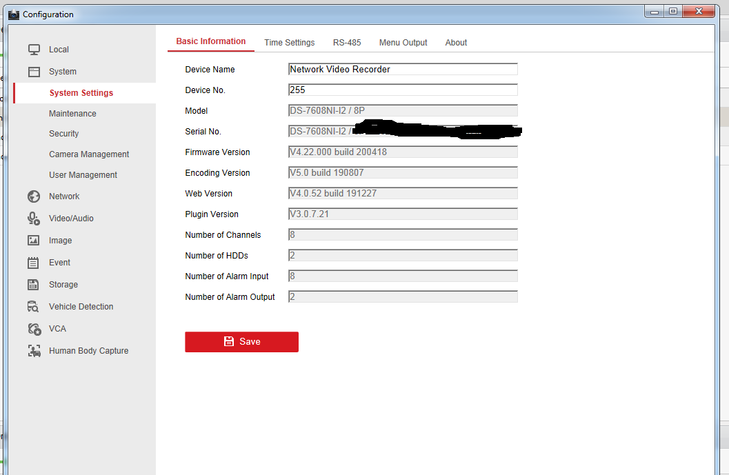

The NVR is a DS-7608NI-I2/8P
Firmware is 4.22.000 Build 200418
Had firmware 4.1.64 Build 190726 before that and same issue

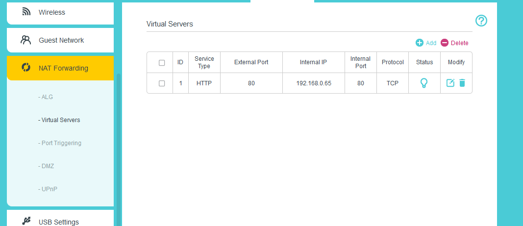

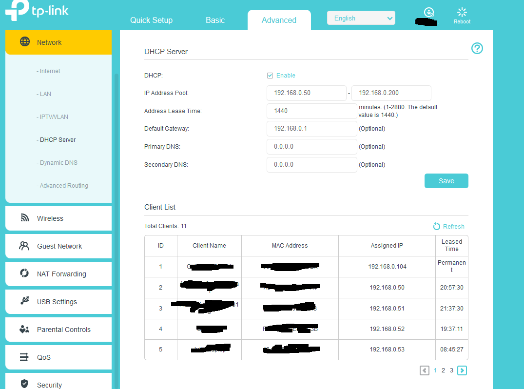

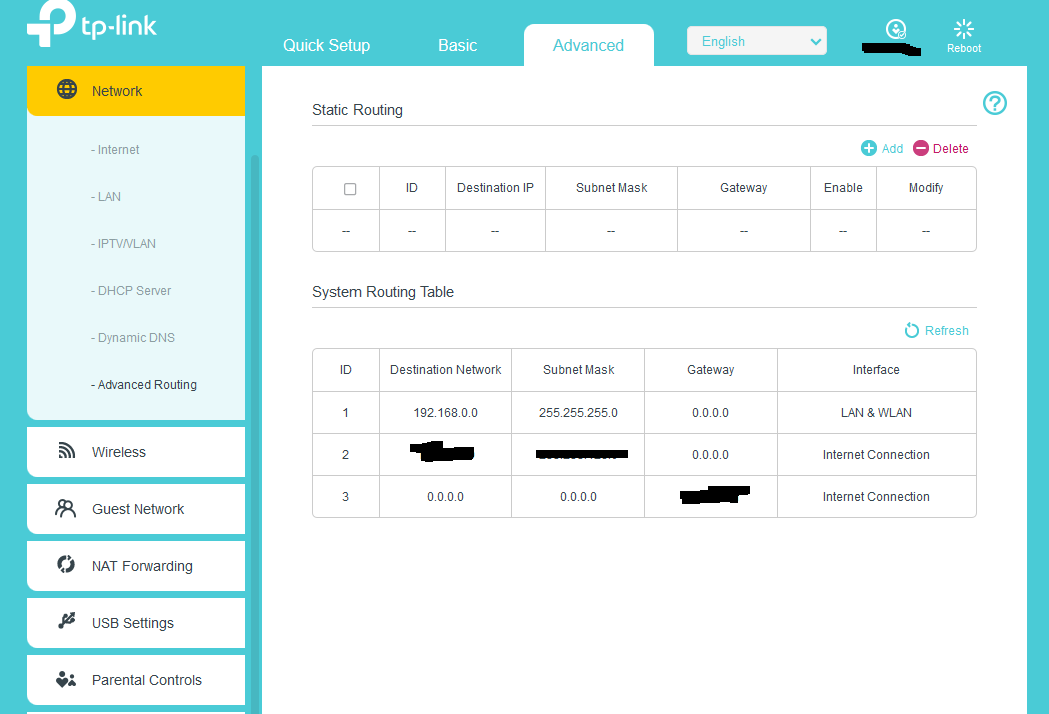

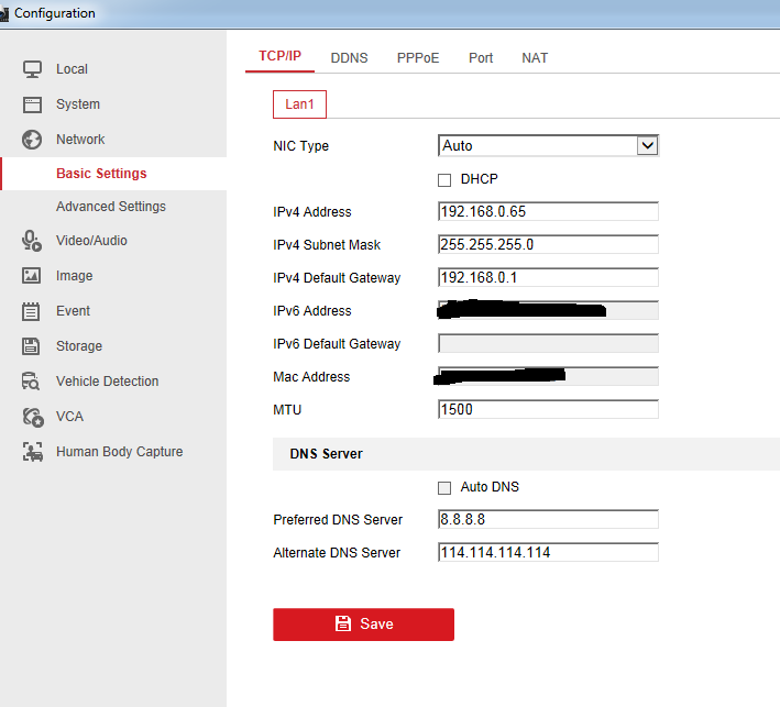

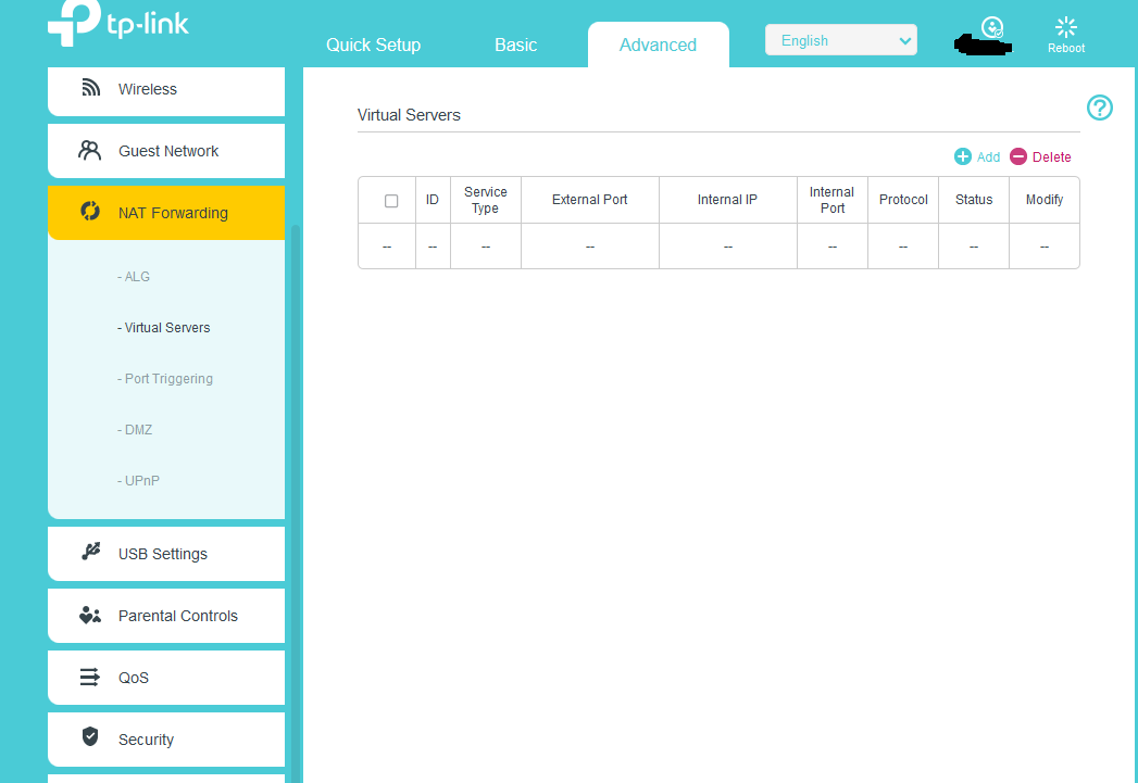

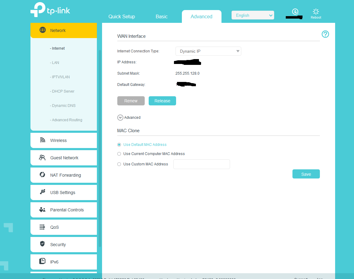

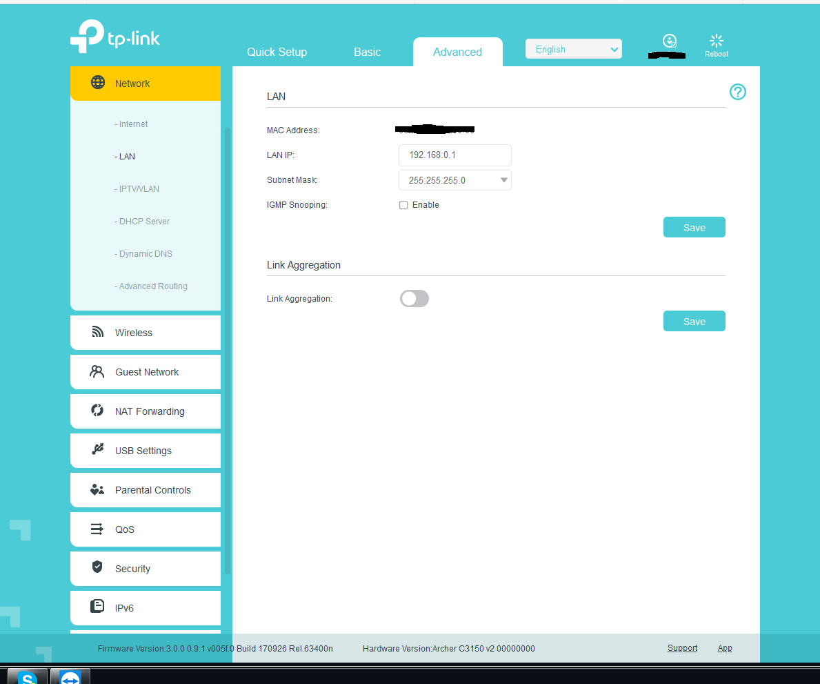

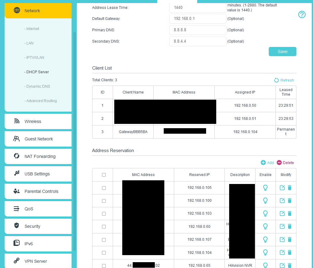

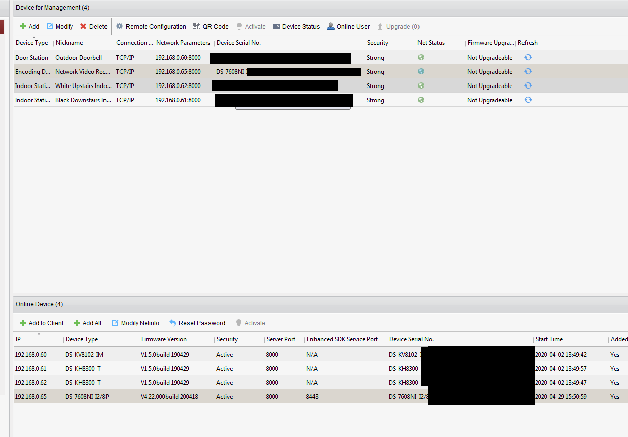

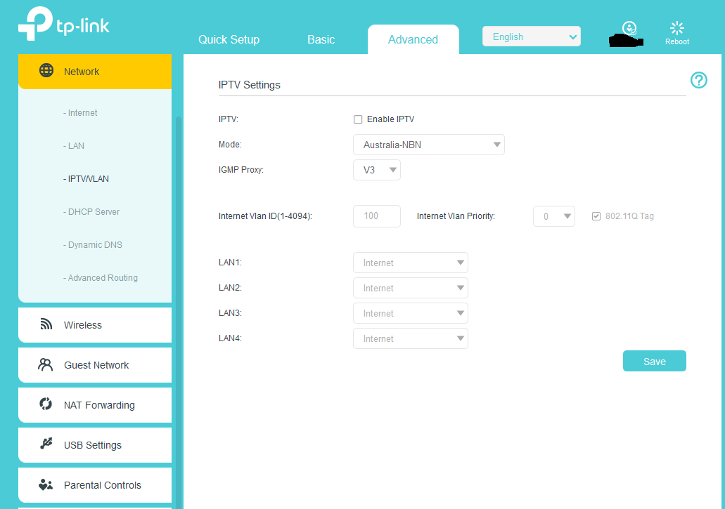

To be honost, i didnt touch any of the settings on the router for the NVR, all i did was give the NVR a reserved ip address....

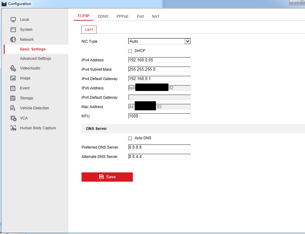

ive got some photos here. I also noticed on the router settings.. none of the dns settings are set, do they need to be set aswell?
Let me know if there is anything else you's need

Thanks very much for your help
With the dns server settings.. set those settings on the NVR or on the Router settings?

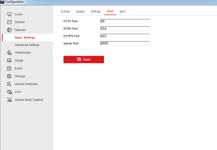

I see it chose port 80 automatically
Does it need the other ports aswell "80, 554, 443, 8000"
Thankyou
No problem at all.
Set them as the same on both, so in the NVRs network settings too. The Mac address you'll need can be seen in your 8th screenshot.
Just 80 on its own should be fine :)
