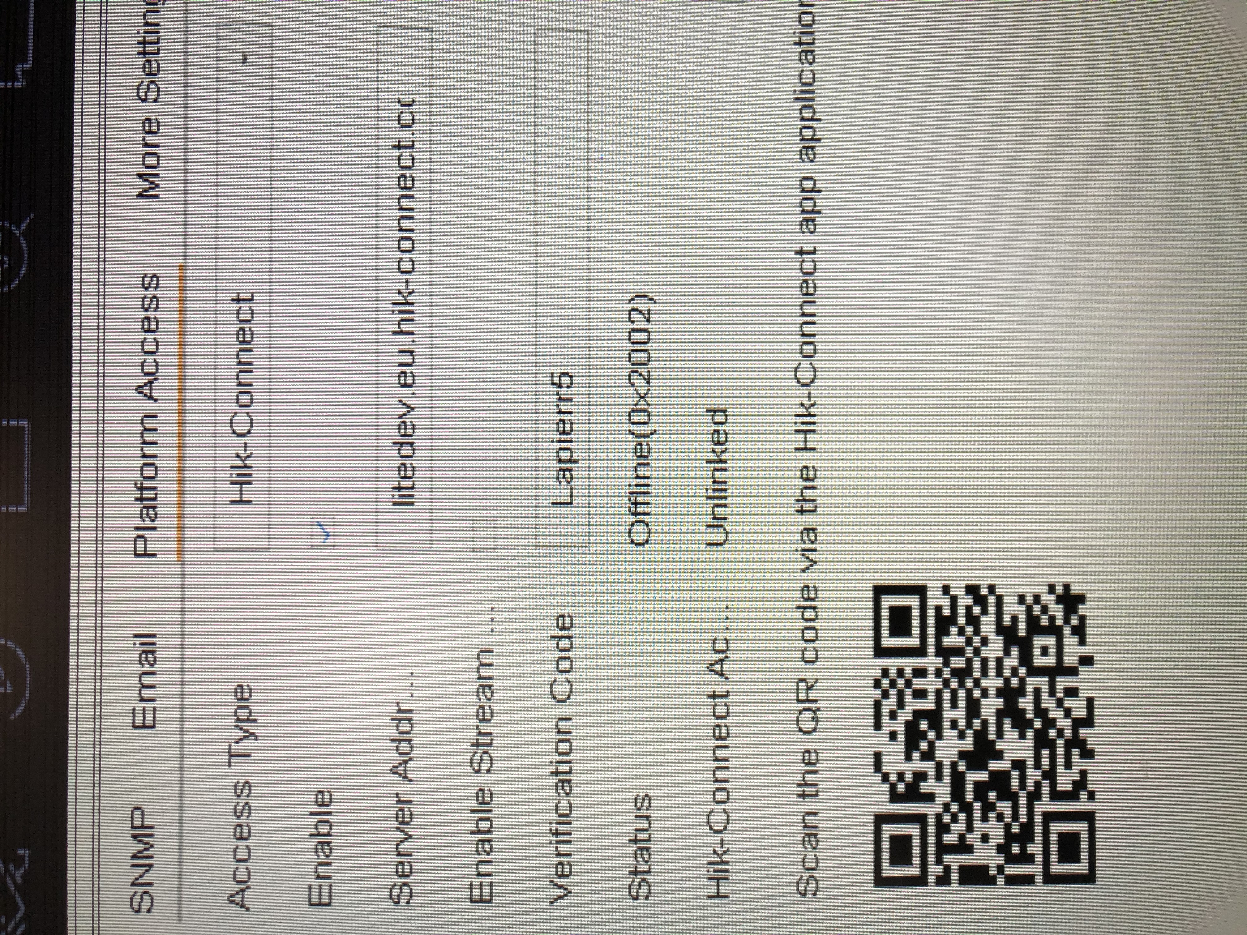

  1. Hik-connect goes offline.
  2. Verification code as shown in attached picture.
My partner and I have two iPhones and I may log onto the hik-connect app, and the cameras may display as offline -> this can be fixed by deleting the device and re-adding it, however, since it's one account used between two devices (phones) this can be quite troublesome ... often leading to the hik-connect service just taking itself offline.

Thanks for the above information, I shared this with Hikvision tech support and their response is below:
For the device offline, it mainly because of the network issue.
Please suggest the customer not to delete the device if the issue happens again and upgrade to the latest firmware.

That firmware is actually for the I-series NVRs, some people like yourself have tried installing this on K-series NVRs and it has worked without any noticeable problems, maybe this Hik-connect error may relate to the mismatched firmware and maybe if you try downgrading to the latest K-series firmware you may stop that Hik-connect error.
I install HIKVision NVR’s / DVR’s daily and regularly have the same issue With my customer’s HIK connect and even my own. The internet can be strong (50mbps Download / 14 Upload) and of course, they‘re hard-wired into the router. Yet my cameras are offline. No error code, no reasoning. I love HIKVision but this is a real problem for a business as we’re constantly being called back to old customers.
My first thought would be to check the Network Settings e.g. the correct router/gateway address and the Pri & Sec DNS addresses (maybe use Google's if you are using the router for DNS i.e. set Pri to 8.8.8.8 and Sec to 8.8.4.4)
