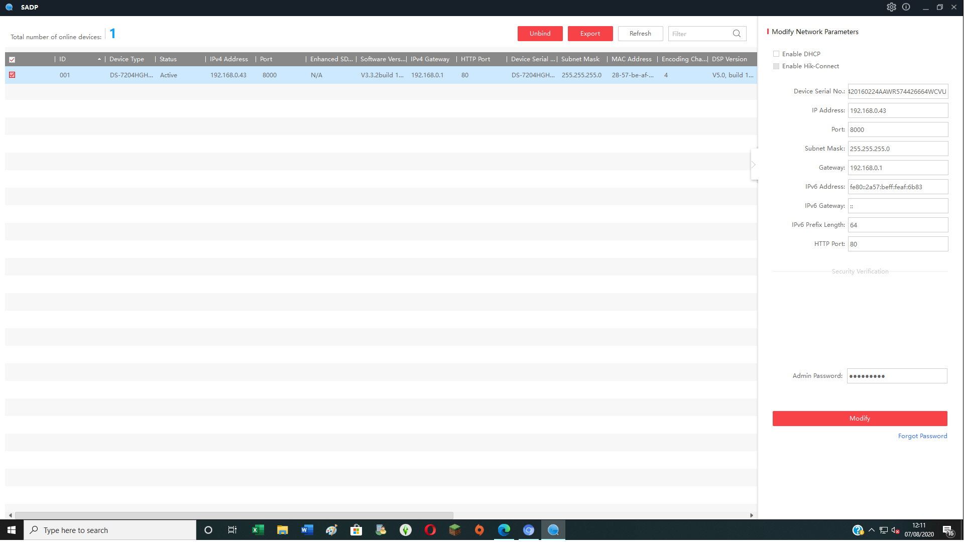

Can you please upload a screenshot of the list of devices that your SADP shows.
Thanks Phil

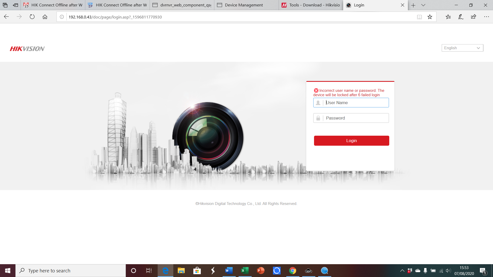

Can you please login to your DVR using a browser, access Config and share a screenshot of your Network Settings.
Also Platform Access.
Ah, you'll need to reset your password. :(
[your user name is VERY likely to remain at the default of admin]
Your supplier should be able to assist you with the password reset.
The process is here:
