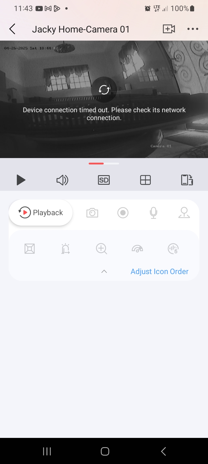

1. We can today get all the cameras working perfectly through the Hik-Connect App version but can’t get Remote Access when offline out of the house.

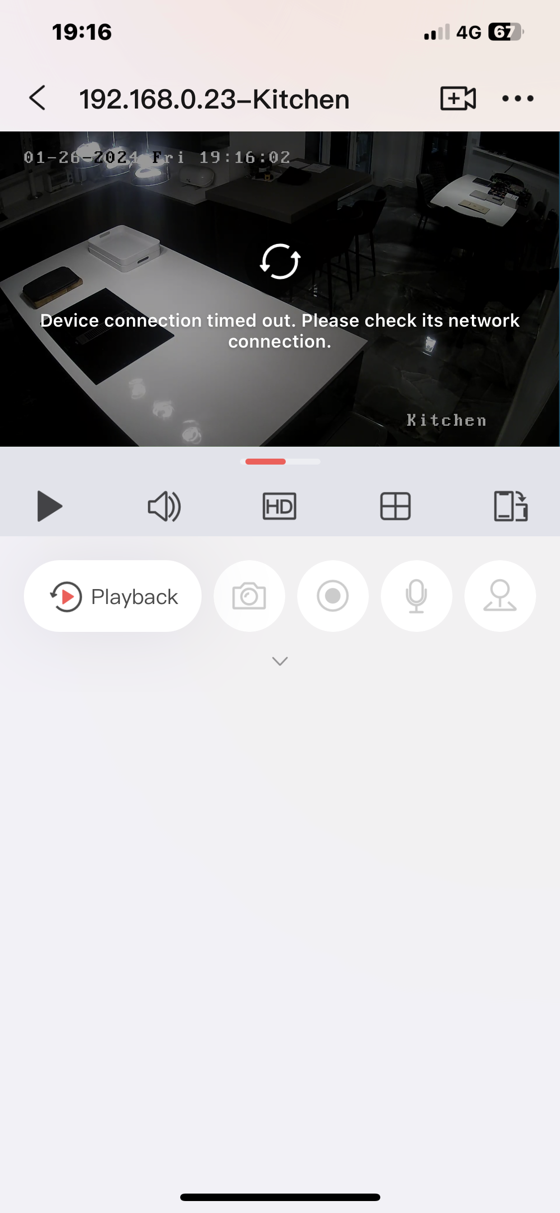

2. Through all the trouble shooting we have tried when trying to connect through the App away from Home the message we get days ‘Device connection timed out. Please check its network connection’

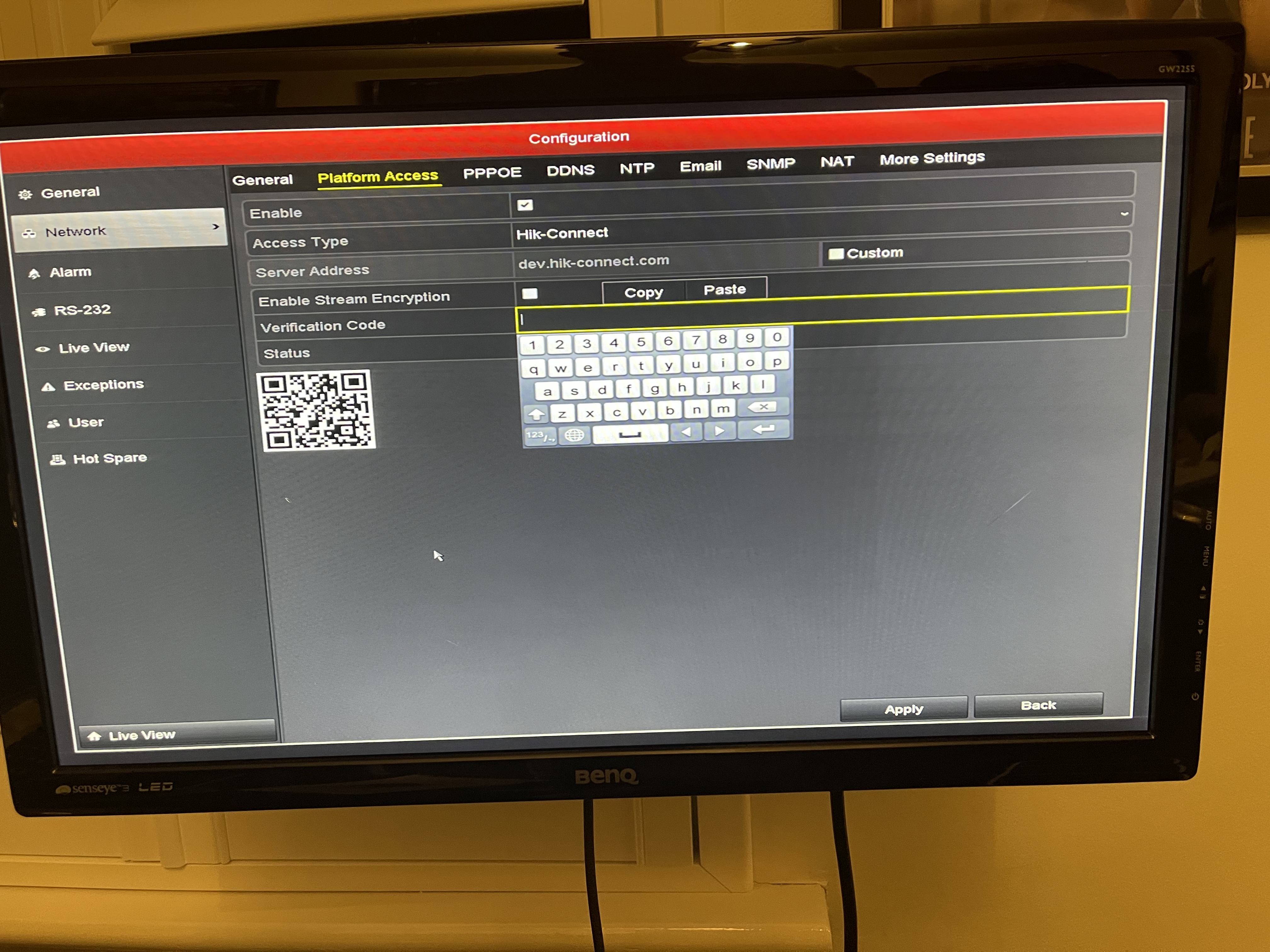

3. The App has instructions to Scan the QR code from the Platform Access page on the Screen but this QR Code only shows the SERIAL NUMBER for the Hik box.
4. It also instructs alternatively to scan the Bar Code off the Hikvision label sticker on the side of the DVR box but this doesn’t help work either.
5. If it helps for Info, the Hikvision label sticker has NO verification code on it, I don’t know if this is because of the age of the model DS-7716NI-SP ? as a lot of trouble shooting instructions refer to requiring a Verification Code and obviously I don’t have one to input onto the Platform Access page on screen.

If you have added the NVRs / cameras to the app using their local IP addresses, then that's probably why you're getting that error message.
So, if you haven't done so already, use the serial number to add the NVR to your Hik-Connect account via the online portal, as explained here:
It should be clearer about what the verification code / encryption key is, but this is actually something you set yourself on the platform access page, which is why you can't find it anywhere on the label - you can just leave stream encryption disabled on the Platform Access page and not use the verification code.
Also, make sure you are using the newest firmware for everything, and the newest version of Hik-Connect (often, this doesn't auto-update, so you need to check in your phone's app store).
One other key thing to check is DNS servers in the NVR's basic network settings page, try setting these to 8.8.8.8 (primary) and 8.8.4.4 (secondary).
