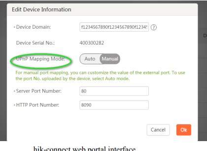

So it does create an open TLS tunnel for port 8000 allowing the mobile iVMS-4500 to work without port-forwarding. This setup screen implies that it will tunnel 80 and 8090 as well....
It must need UPNP on at the router to make this work - then you could hit the NVR remotely using Hik-Connect. Do you agree?
Yes, I believe this is the case.
