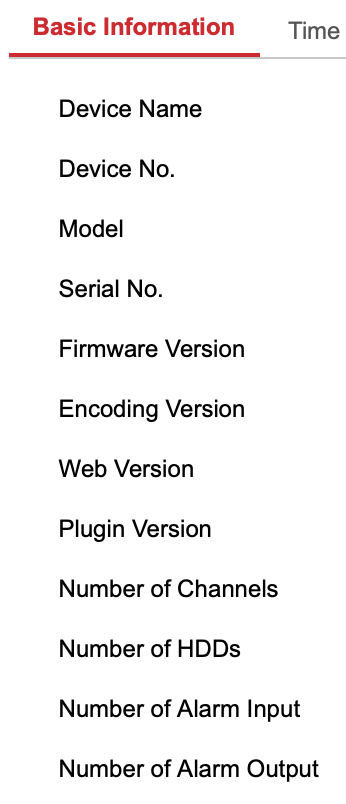

Can you please share a screenshot of the 'Basic Information' menu from your camera?
It would be useful to know the 'Firmware Version Property' (it should look something like 'B-R-G5-0') because it will help me identify the exact firmware family your camera uses.

In the meantime, this is the all data that I collected last time I was able to log on:
Firmware Version V5.4.81 build 180203
Encoding Version V1.0 build 180110
Web Version V4.0.1 build 170117
Plugin Version V3.0.6.1
This is all the Configuration menu shows -- no "firmware version property"!

Okay,
I think your model is simply too old and pre-dates the introduction of 'Firmware Version Property'.
Searching through all the firmware locations we have access to, we cannot see any newer firmware than the V5.4.800 which I believe was only a small security update.
Due to how long this model has been obsolete/EOL, this firmware will likely be the last firmware update for this camera.
