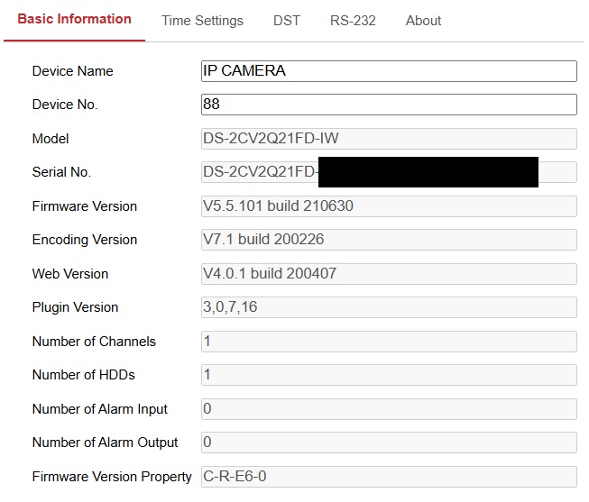

Current details off the web interface:
Model DS-2CV2Q21FD-IW
Firmware Version V5.5.101 build 210630
Looks to be an E6 model
The EU download portal has a few firmwares available https://www.hikvisioneurope.com/eu/portal/?dir=portal/Technical Materials/00 Network Camera/00 Product Firmware/E6 platform [Wi-Fi (B) model, 2421]
I specifically tried V5.5.803 210817, because it lists the exact camera model in the readme file and looks to be the latest build, though their numbering is sometimes weird to me.

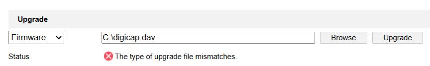

*update* I've tried IPCG and IPCTC firmware files and have the same issue.
I unpacked the file, put it in C:\ (as many have suggested). I used MS Edge (and tried Chrome) because there's no more IE available...I also tried using the file from the Downloads folder in Windows.
I get the error: Status - The type of upgrade file mismatches.
I've done upgrades for my other Hikvision cameras before, not sure what I'm doing wrong here.
Is the firmware I'm trying to load older? I wouldn't think so based on the version number and build number...
