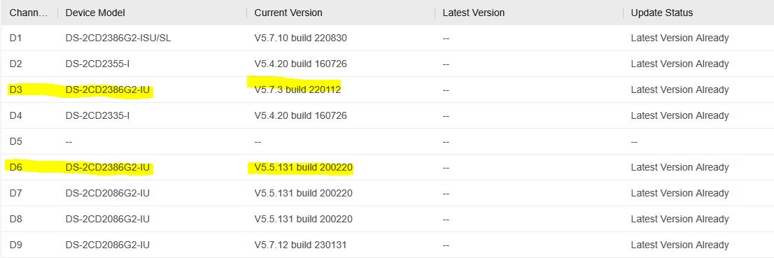

I have checked firmware and do observe for example the working D3 has a different firmware version even though HIkvision says theyre all up to date! Help!!

Meanwhile my NVR claims theyre all on the latest version already really?
DS-2CD2386G2-IUV5.5.131 build 200220--Latest Version Already
Hikvision website latest version - Firmware_V5.5.820_231108
None of it works right.

A couple of things to note regarding your cameras and firmware. Although they look like they’re the same model (DS-2CD2386G2-xxx) you have two different hardware versions. You can see that if you login to the cameras and check the system information page; there’s a line marked ‘Firmware Version Property’ and the middle two characters denote the version you need.
All of the ones on version 5.5.131 are the older G3 platform models. They can be updated to 5.5.820_231108.
All of the ones on 5.7.x are the newer G5 platform models (often referred to on here as the ‘c’ revision models). They can be updated to 5.7.19_241207.
The message about ‘no update available’ or ‘latest version’ is a PITA. It’ll rarely let you know a firmware update is available (depending on NVR model and version)
It is worth updating everything to the latest versions as it may well solve your issue.
Additionally:
- make sure your NVR firmware is up to date (you don’t mention the model or current version.
- for the cameras that aren’t working I assume you’re selecting the ‘notify surveillance centre’ action on the NVR rather than directly on the camera? (if you’re selecting e mail or notify options directly on a camera that’s connected to an NVR PoE port it’ll have no effect as the cameras themselves have no path to the internet)

Ok new day and i haven't yet shoved it all out the window, thankyou kindly for your input here also, I shall try above as suggested and hopefully it will resolve things.
