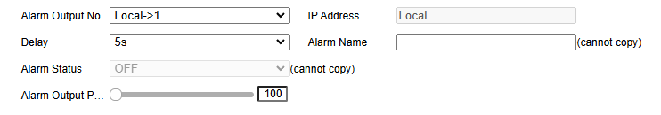

I tried to play with the delay which is labeled "Dwell" in the NVR software but It just for how long the alarm will be on, and for alarm output pulse field it's not visible in the NVR but it is in the web UI and it does nothing.
