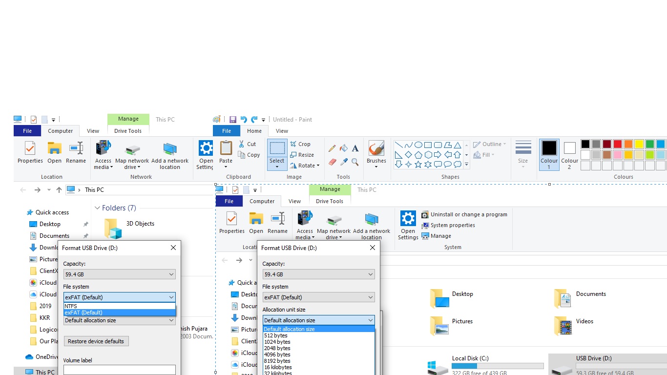

I have tried this formatting to device defaults however no luck with this, please see attached all options available

OK - I've known the PC format to solve similar issues.
I don't think it mattered what settings you used in the PC.
