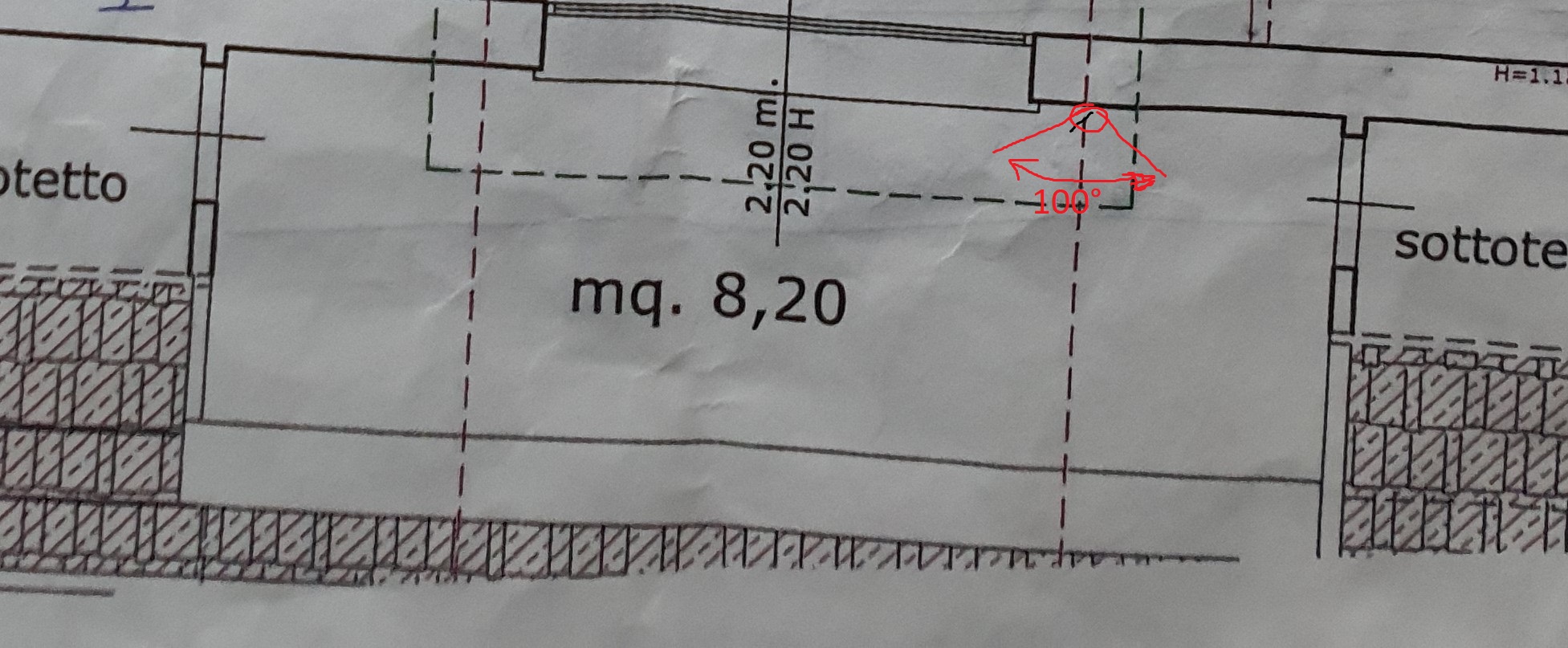

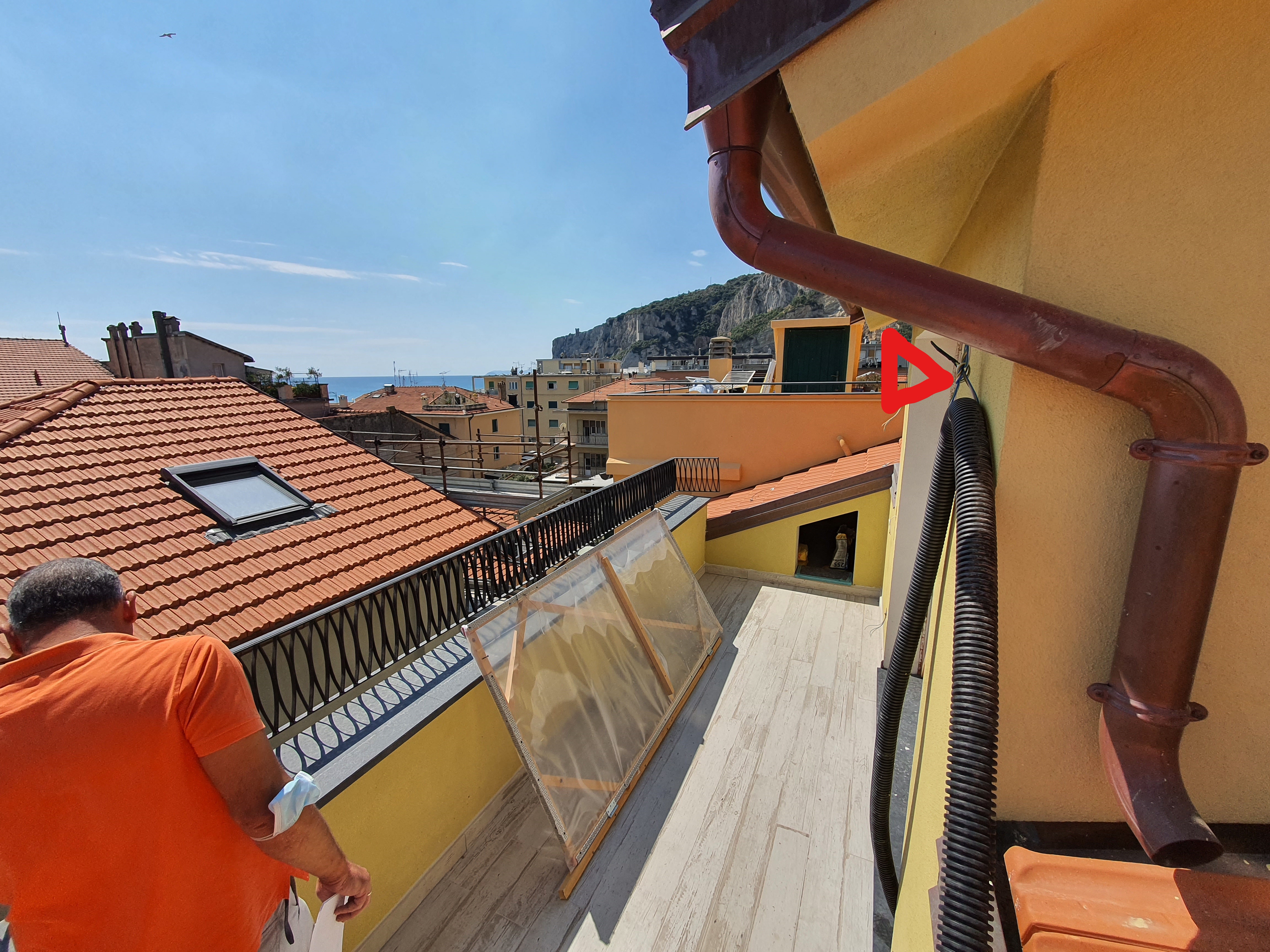

Just for me to better understand. I am not sure what is VCA setting ?..... but the way I want to use is that if somebody (somebody that is not very welcome ;) ) enter in the balcony the camera will activate alarm and strobelight. Which means that the alarm should not be triggered by some bird landing on the balcony or some cats jumping there from the roof. I would like to avoid to get too many false notifications .or to disturb my neighbours with the flash light. Will it work ?
I have selected a 2.8 Degreee because the balcony is 5x1,6 m and with an angle of 100 degrees I should see more or less the whole balcony. ( I attach the pic to show where the camera is supposed to be installed).

Hi @MArco,
VCA is a general bracket term for all the camera's smart functions, for the purpose you describe you would probably be fine just to use intrusion detection or line crossing with minimum & maximum detection sizes set, this means the camera can be set to only trigger on objects that are larger than a cat so as to avoid false triggers.
If the balcony is the primary area you want to cover then yes a 2.8mm lens is the best option to cover that space.
