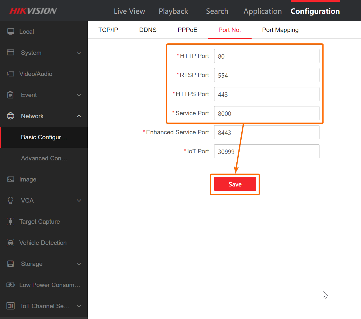

If you're using the web browser GUI…
You will be taken to this page. All you need to do now is set the port numbers as you please, and click Save:

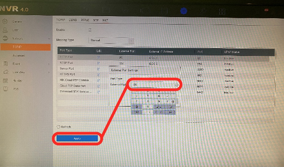

If you're using the local GUI on an NVR…
Now, make sure that the Enable box is ticked, and the Mapping Type is set to Manual.​
You should now be able to see a table with a column showing each of the Port Types and port numbers that your NVR is connected to, and another with the option to Edit these ports, by clicking on the notepad icon for each port type:​
Alter any of the port numbers you like, just make sure to click OK and then Apply once all ports are set to something that you're happy with:​
