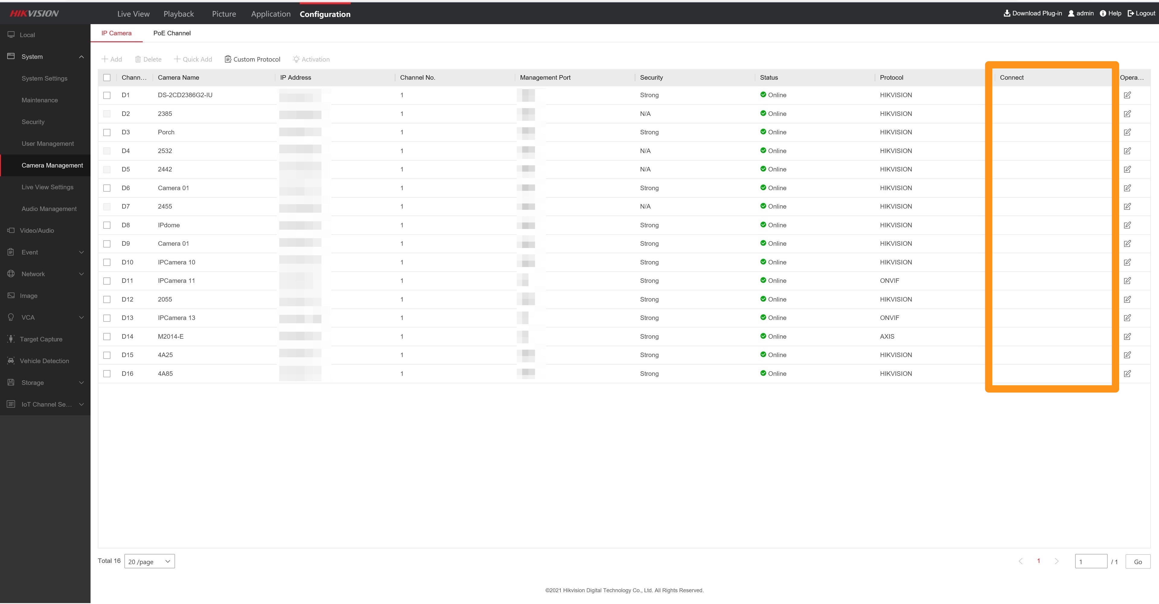

Step 2:​
Once you've logged in, navigate to:
Configuration System Camera Management
This screen displays all the connected cameras on your NVR. Notice that the final column labelled "Connect" is currently empty. We'll be coming back here in a moment.

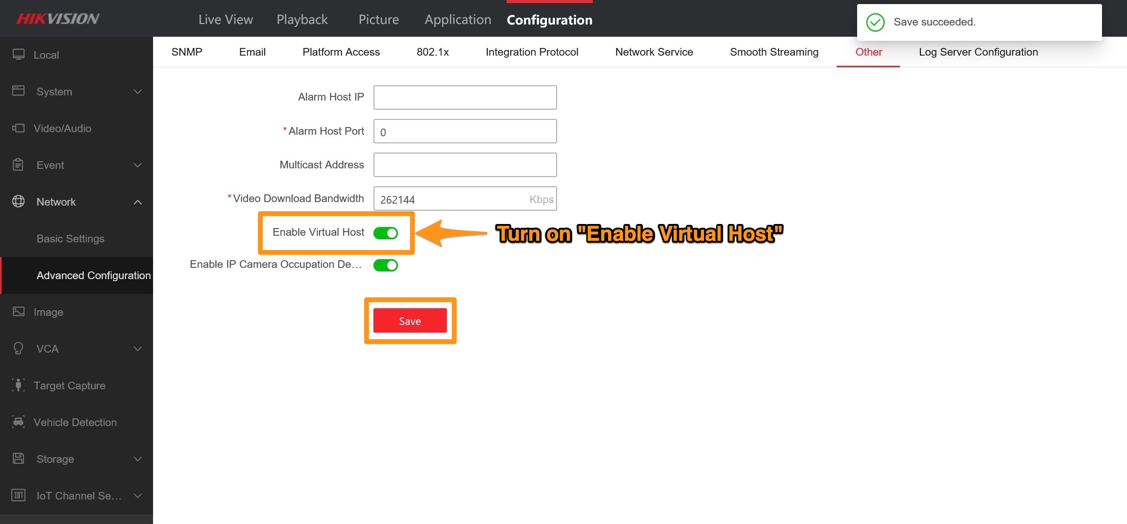

Step 3:
Now, navigate to:
Network Advanced Settings Other
Turn on the Enable Virtual Host option.
Note - Your NVR will reboot when you click "Save".

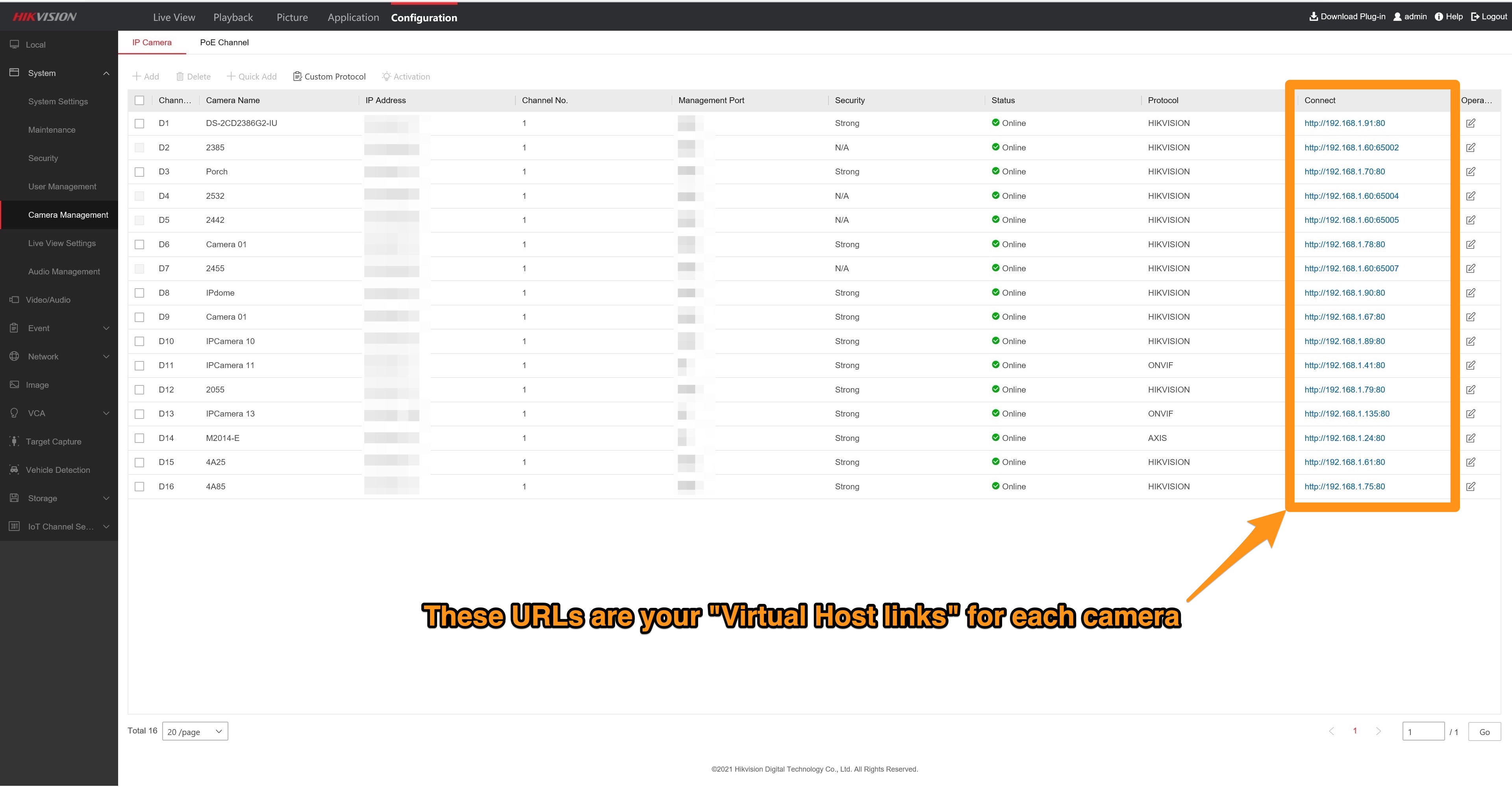

Step 4:

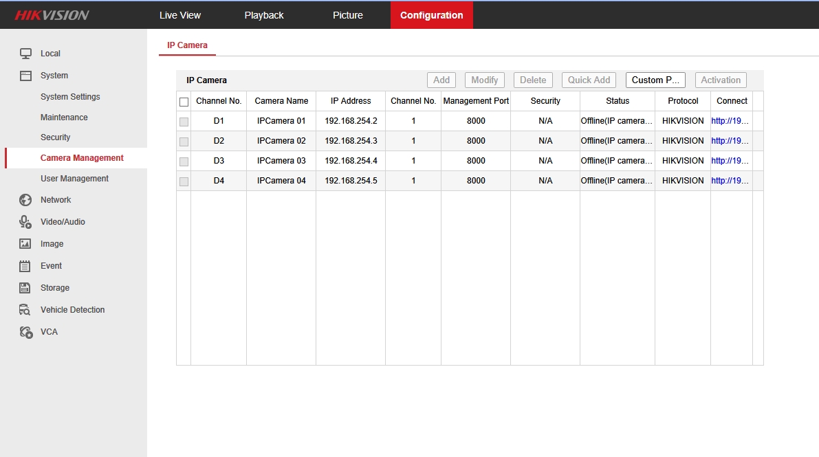

Now, navigate back to the Camera Management window from earlier. You'll notice that the previously empty connect tab now features links for each camera currently connected to your NVR.​

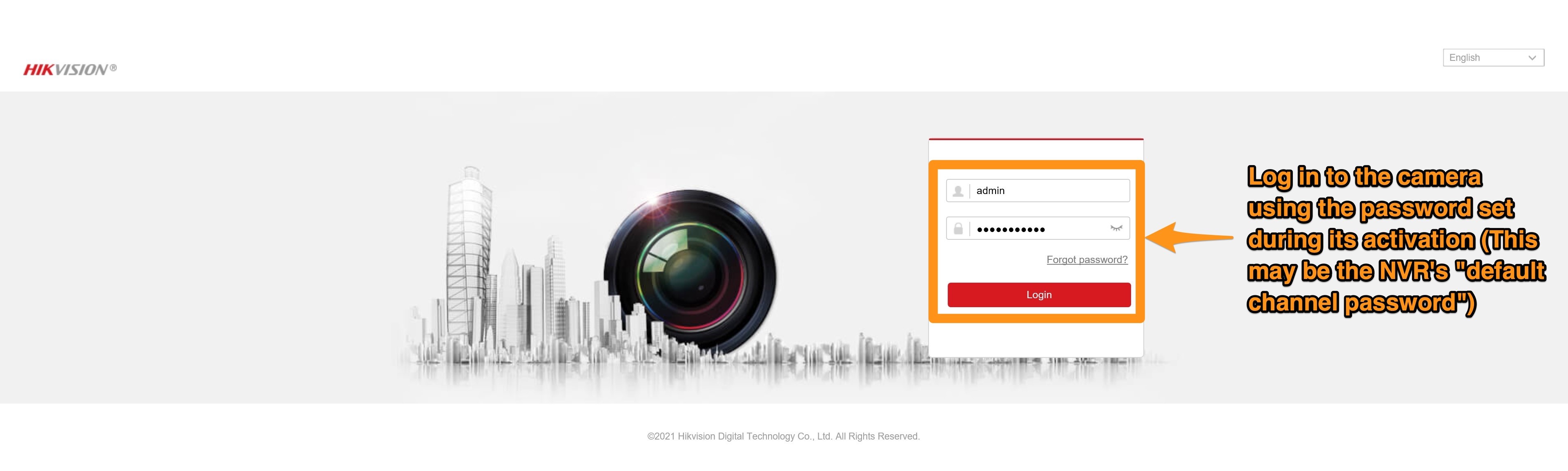

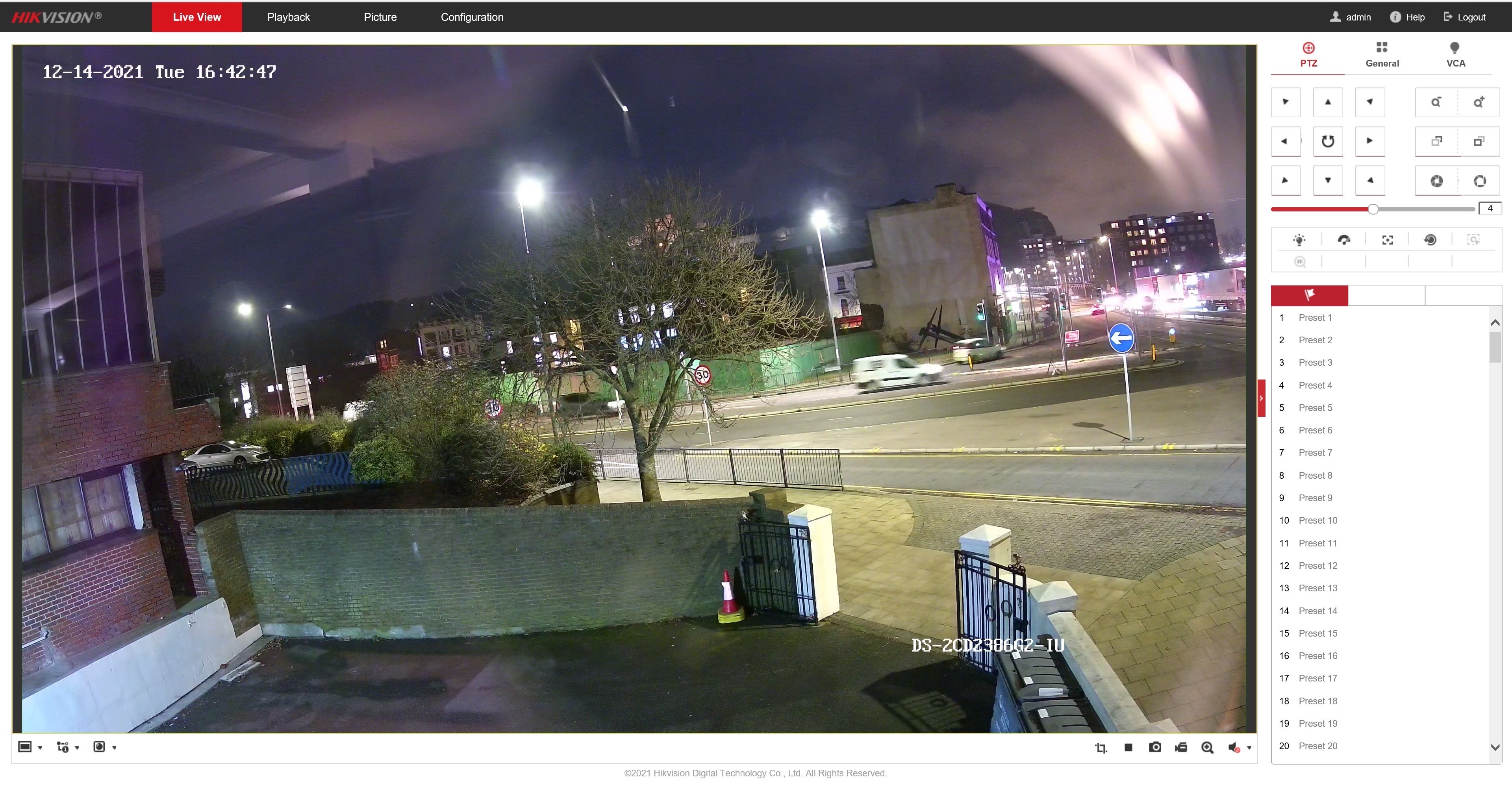

Step 5:​
Click on any of these links to access the respective camera via your web browser:​
That's it, you're done!

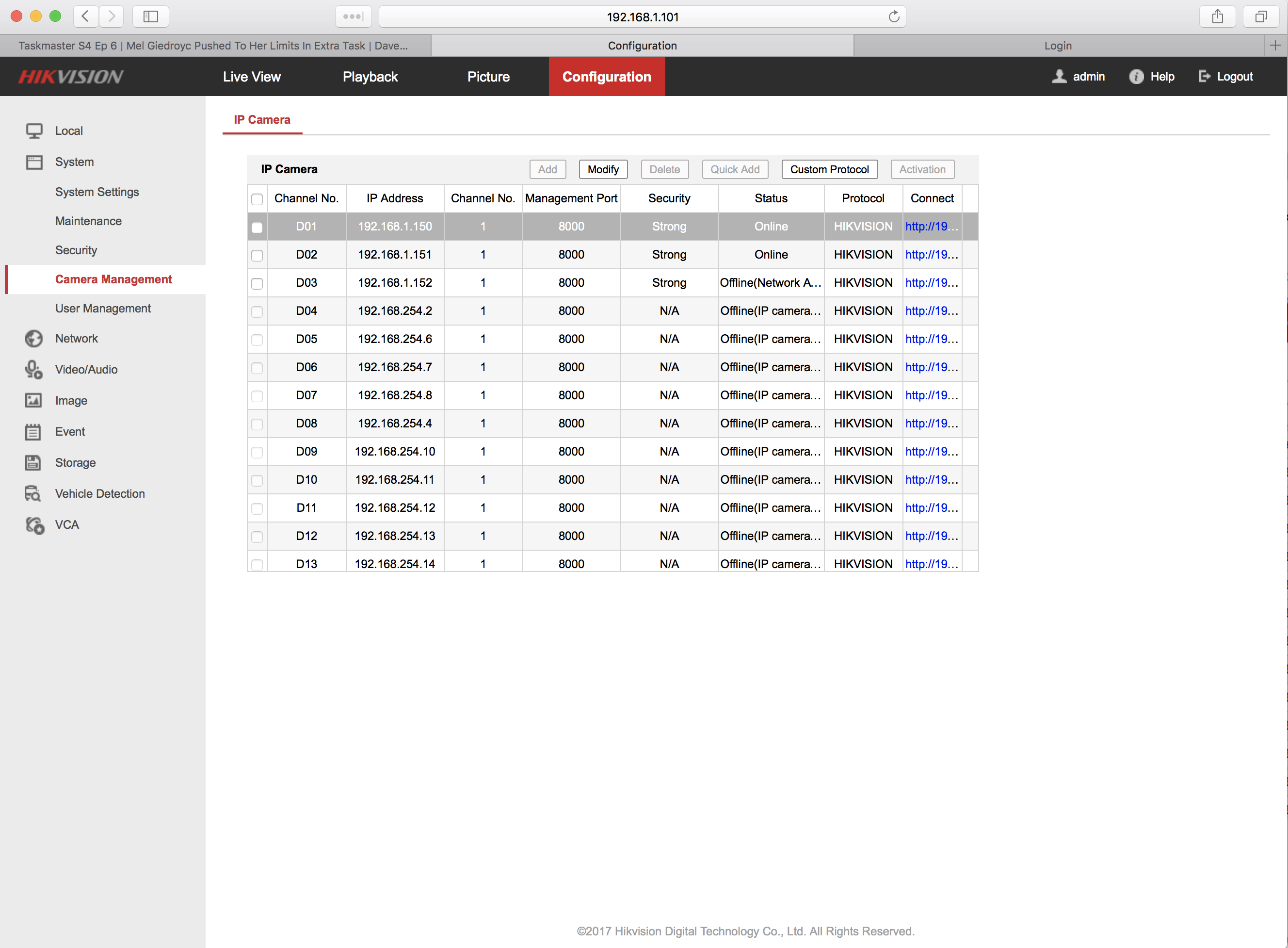

Question re: NVR DS-7608NI-E2/8P/A (v3.4.96 build 170921) interface on OSX 10.13

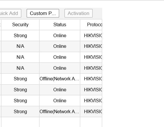

I have set up virtual host. Trying to view camera(s) IP & port on Configuration/System/Camera Management.
Unfortunately, the viewable columns in the table finish half way through the Protocal column on the RHS. Any ideas on how I can access a wider view of the table to show the column with the IPs and ports? There are no handles to drag the table.
Kind regards
Alan
Do you mean this view?
I'm afraid it always looks like this, but you should be able to click the hyperlink in the right-hand 'Connect' column to open a new tab in you browser and access the camera and its setting.
Hovering the mouse over the links in the column will show their full address, and they seem to have a simple convention.
http://<NVR-IP>:650<Channel Number>
As in, my NVR is 192.168.50.150, so my POE connected cameras are;-
http://192.168.50.150:65001
http://192.168.50.150:65002
http://192.168.50.150:65003
etc
The two cameras on an alternate switch show as;-
http://192.168.50.150:71
http://192.168.50.150:72
