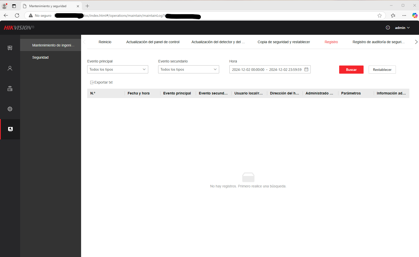

Log in to your alarm using a browser (use the local IP). Then you go to the MAINTENANCE tab and there is an event log. I attach an image. Mine is in Spanish, but you can get an idea.
There you can see the event, the user, date and time.
