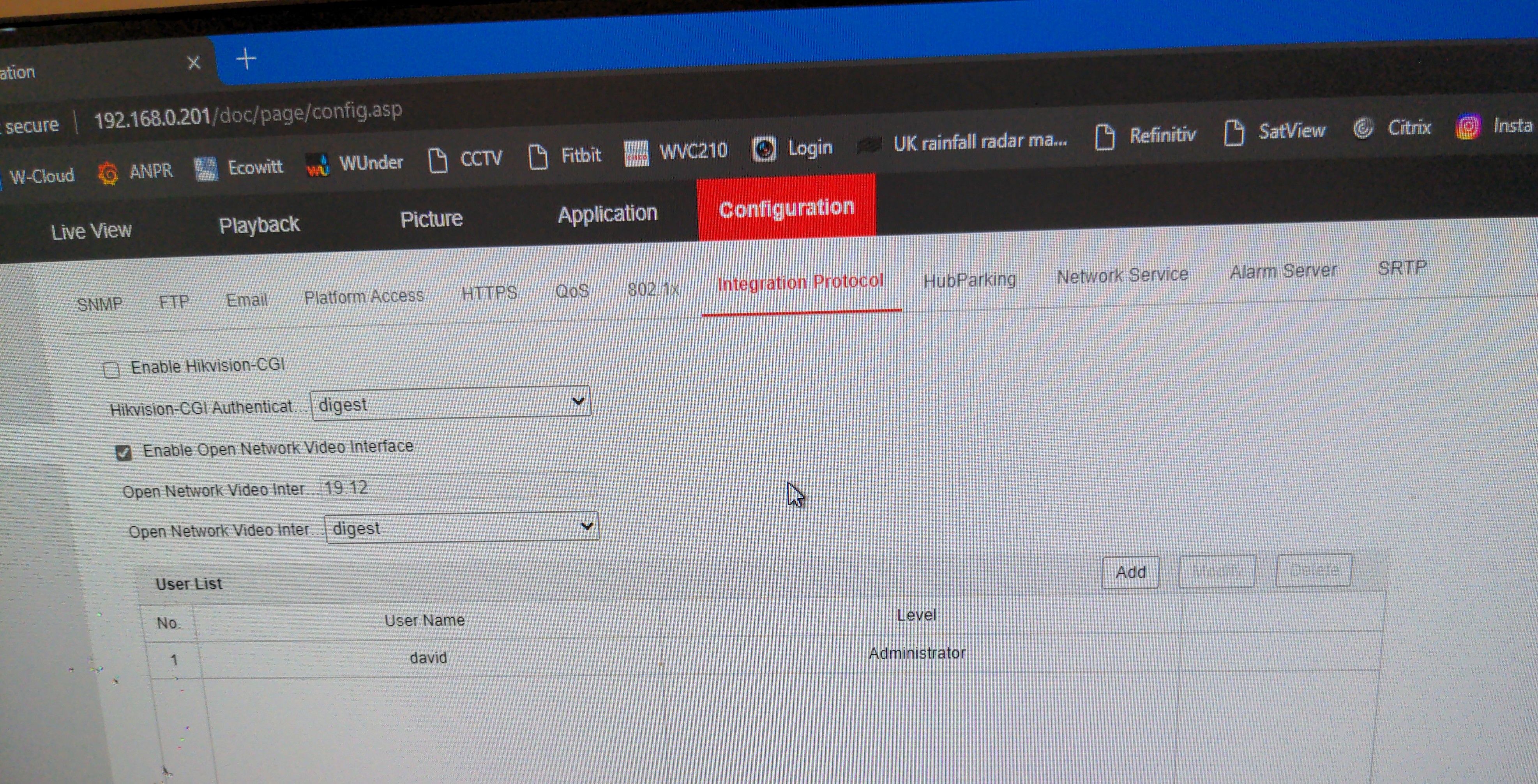

So I worked out that under the camera "Integration Protocol" I needed to "Enable Open Video Interface" and change the auth method from "digest" to the less secure option (I forget the name of it). I also then created a user (of type Administrator) in the "Integration Protocol" "User List". Hit save and the camera feed in the NVR immediately changed from "network connection error" to "Invalid username or password".
So I am getting somewhere but even when I 100% check/set the username/password correctly in the NVR connection settings and the Integration Protocol User List all I ever get on the NVR is "Invalid username or password".

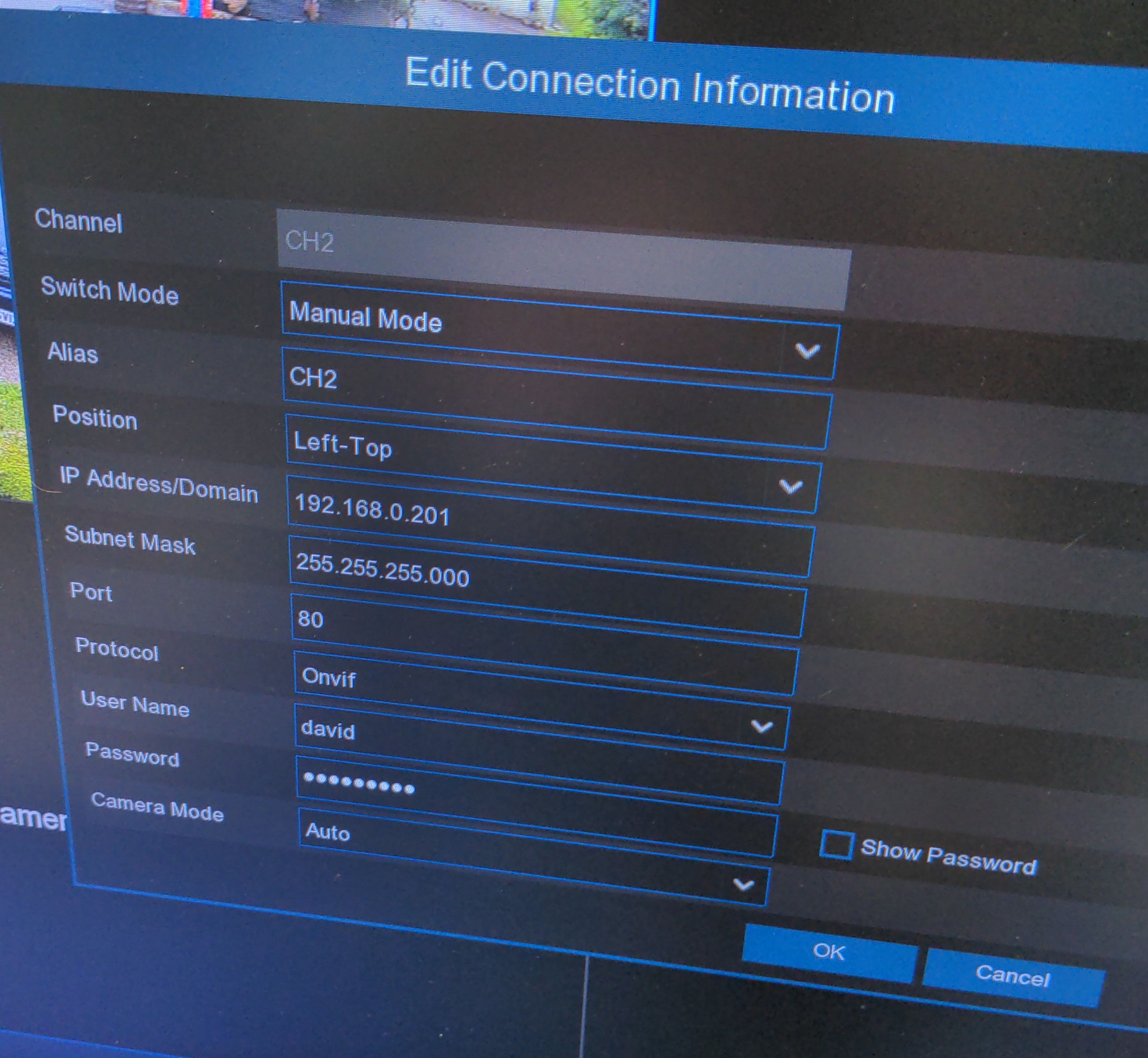

Can you please share some screenshots of what you are seeing in the XVision menus?
Thanks @Dan here is the XVision camera connect settings.
I tried with the users existing username and password first, then I tried with the following:

And then entered admin/TestPassword in the XVision connection settings but still "username or password error".

@Dan, no, the camera is not connected directly to the NVR, it's on a PoE switch. Here is the HikVision camera settings. This was before I added the second ONVIF user (admin/TestPassword) and also I had to change the second "digest" option to the other option which is something like "Digest&ws-username". So with "digest" I get the "network connection error" but when it's changed to the other option I get the "username or password error" which to me seems like the NVR is attempting an ONVIF login but it's failing for some reason even though username/password is correct.
This is now solved, it appears that the "invalid username and password" error was a red herring. Despite the XVision NVR working with an older HikVision ANPR Camera, the NVR was giving the error with the newer HikVision ANPR camera.
The user just had to change their NVR custom protocol settings - specifically setting the stream path to "streaming/channels/101".
I am not sure what the NVR streaming channel was before with the old ANPR camera but it would appear that HikVision changed the camera streaming path between the two camera versions/firmware.
