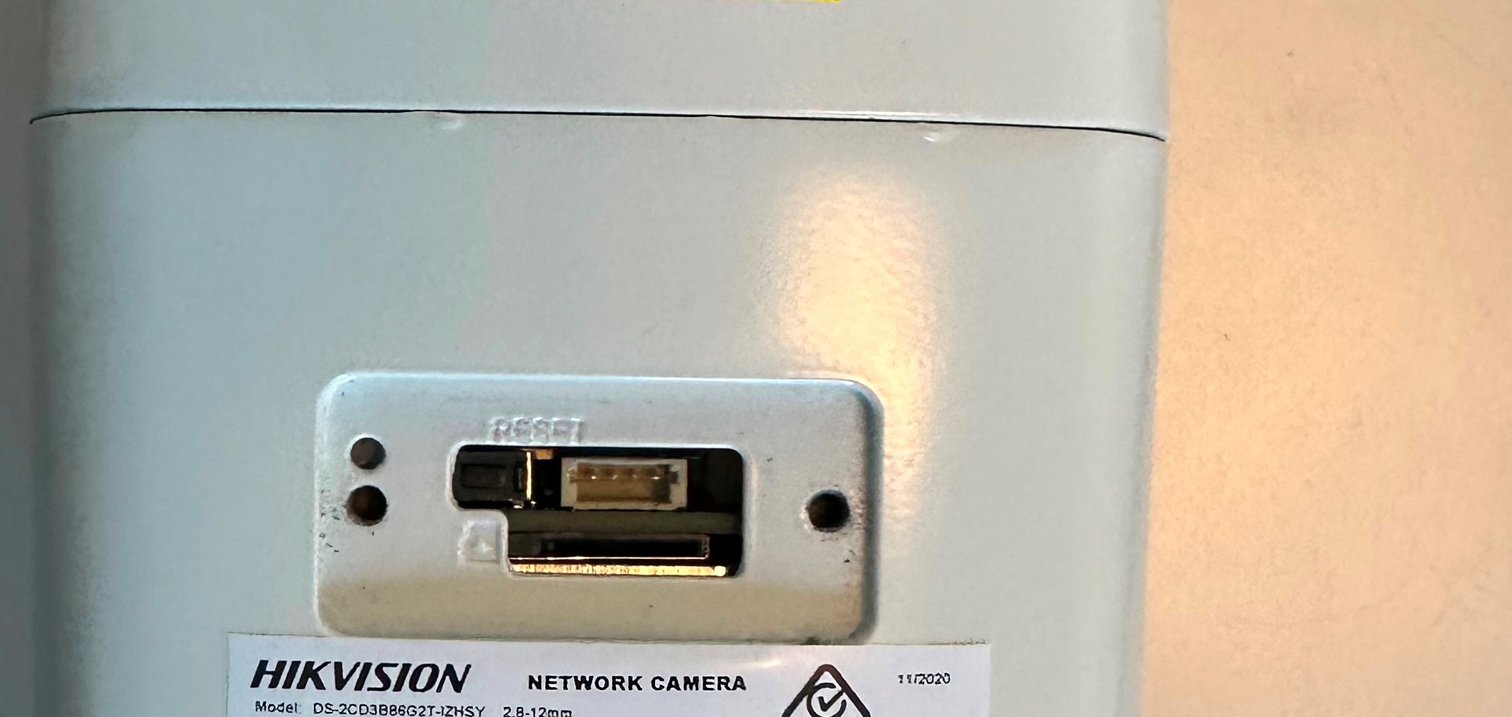

How to insert a micro SDXC-card into my Hikvision IP camera? (DS-2CD3B86G2T-IZHSY)
llars
Well-Known Member
64
8

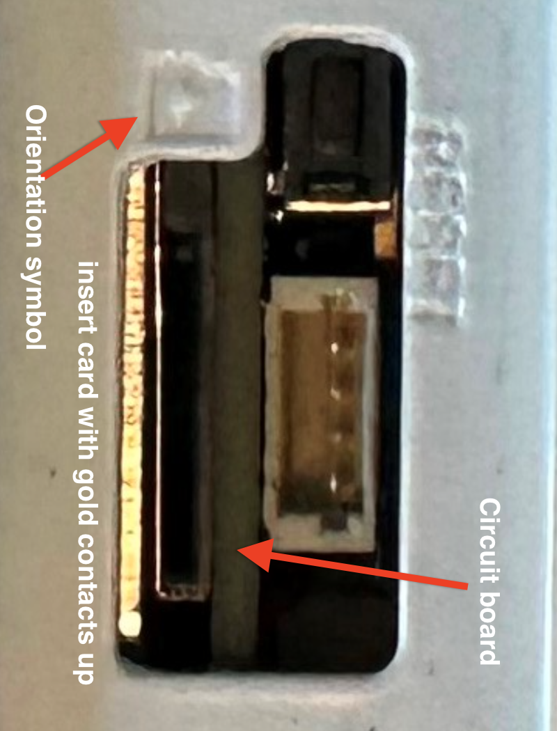

The card should be placed in a slot under the camera, but I am afraid to do it wrong. The camera can use these: Built-in micro SD/SDHC/SDXC slot, up to 256 GB and I just bought a Scandisk ultra microSDXC UHS-I Card as shown on a picture. The other picture show the slot.
If you look at the length of the slot, the narrowest part of the card must probably point down/in, but should the side of the card shown up in the picture be down towards the white paper - or vice versa?

Hi @llars
If you look at the little symbol next to the MicroSD card slot you will see that the notched side of the card should be on the left (closest to that symbol).
